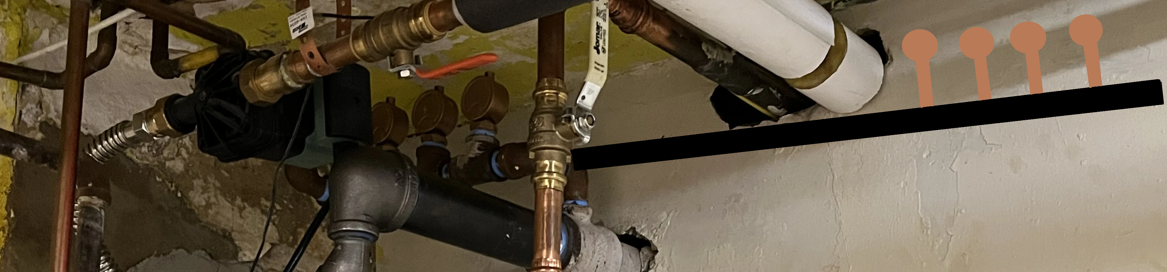

  • @109A_5
    Ive been thinking about this project and definitely plan to dig into it over the summer. Extended the 2” pipe out from the red circle and then turning down and transitioning to copper makes perfect sense.
    a couple questions.
    1. Can the transition be directly from iron to copper with a threaded fitting? Do I need to use a brass fitting for the transition?
    2. The vents above the red circle don’t have a lot of height from the main. Is there a better placement for them? There is no place nearby where I have more height to extend them. I could run them out further horizontally. Would that be helpful or not worth the trouble. There is some evidence they spit a small amount of dirty water but they have been venting no problem for 7 years since I put the current arrangement up there. Also, redoing the turndown should give them less of a water supply to spit in the current arrangement.
    ill be extending the other set of vents (green circle) up as well but that main has downward pitch at the end giving me room to extend them up a few inches.
    109A_5 Posts: 4,759
    Sound like you have a plan.
    Having a male copper into a female black pipe seems to hold up well, like your is, I'm not actually sure what code is in this situation.
    Once you get the main extended and draining properly that should further reduce any spitting from the vents, I would just see how it goes. The 4 vents have a lot of 90 degree bends to get to them, so it may be fine.

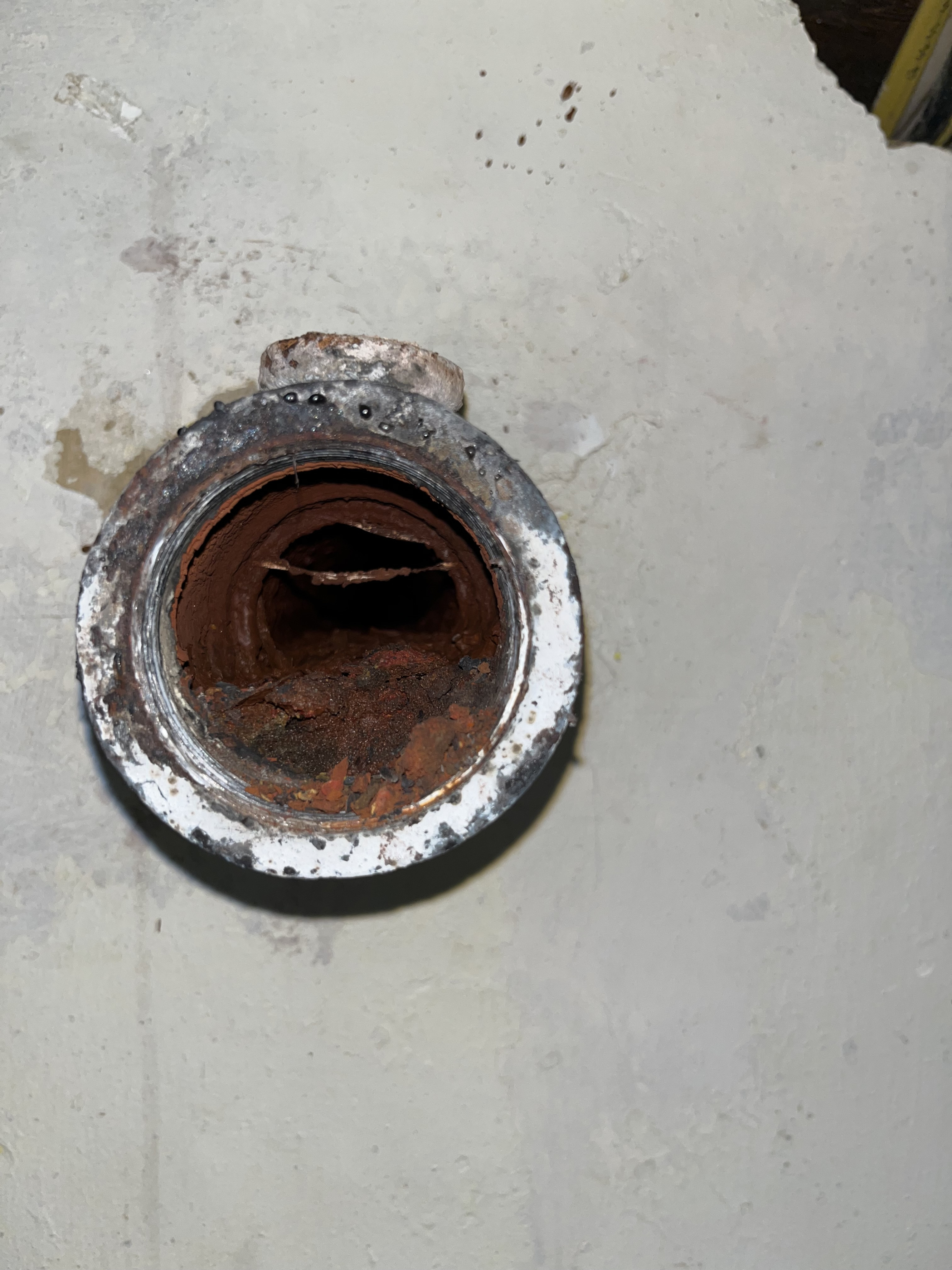

    i got the fittings off where the piping reductions were this morning with the help of my musclebound nephew and his big blowtorch.
    heres what the inside of one of the pipes looked like opened up. I scraped out as much of the gunk as I could but probably wasn’t very effective more than 8 inches or so into the pipe. Who knows how far back the gunk goes. Is there any great way to clean this out deeper before repiping and sealing it all in?
    109A_5 Posts: 4,759
    Maybe flush water through it (if possible) and use a small hand snake.

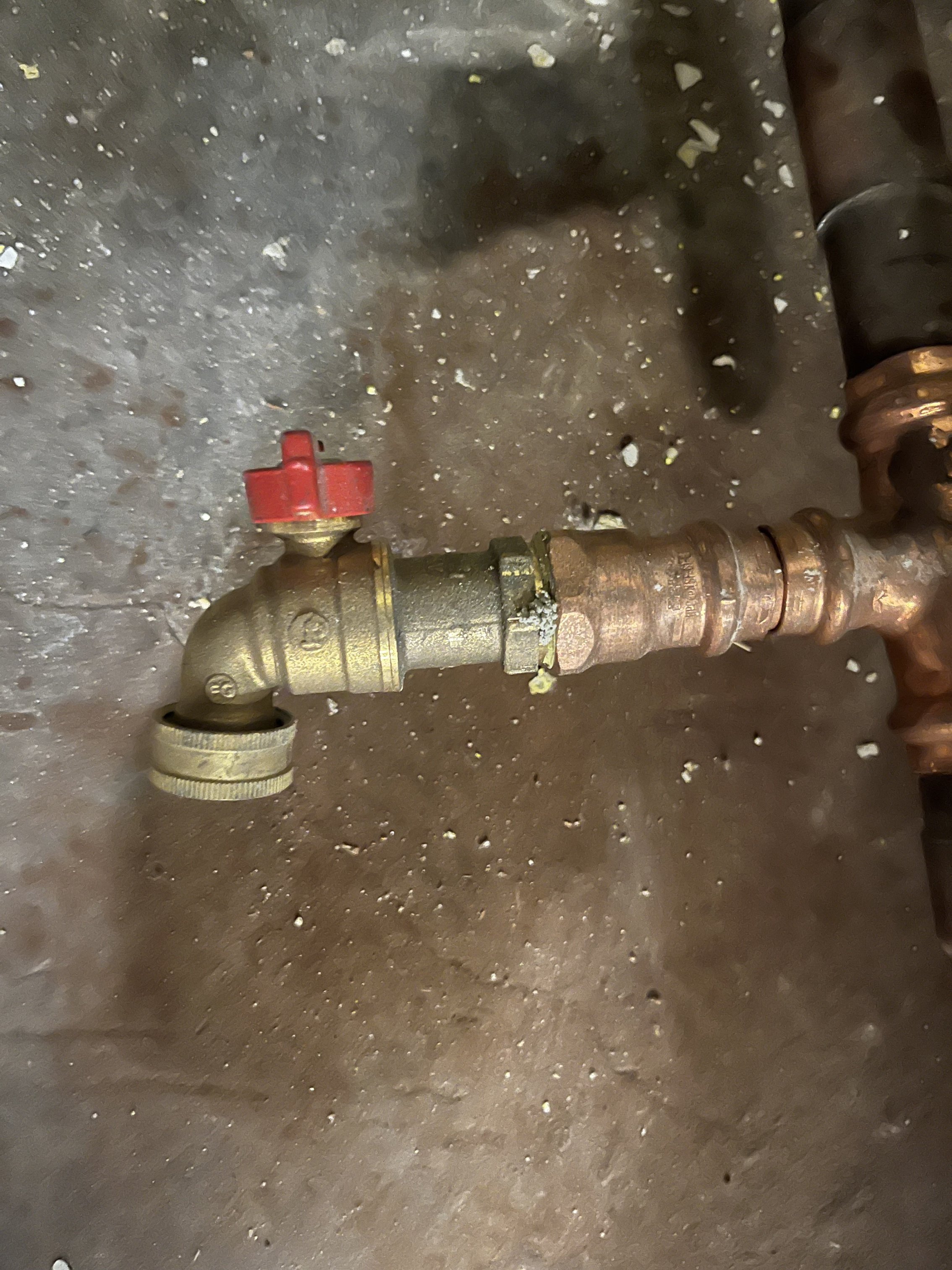

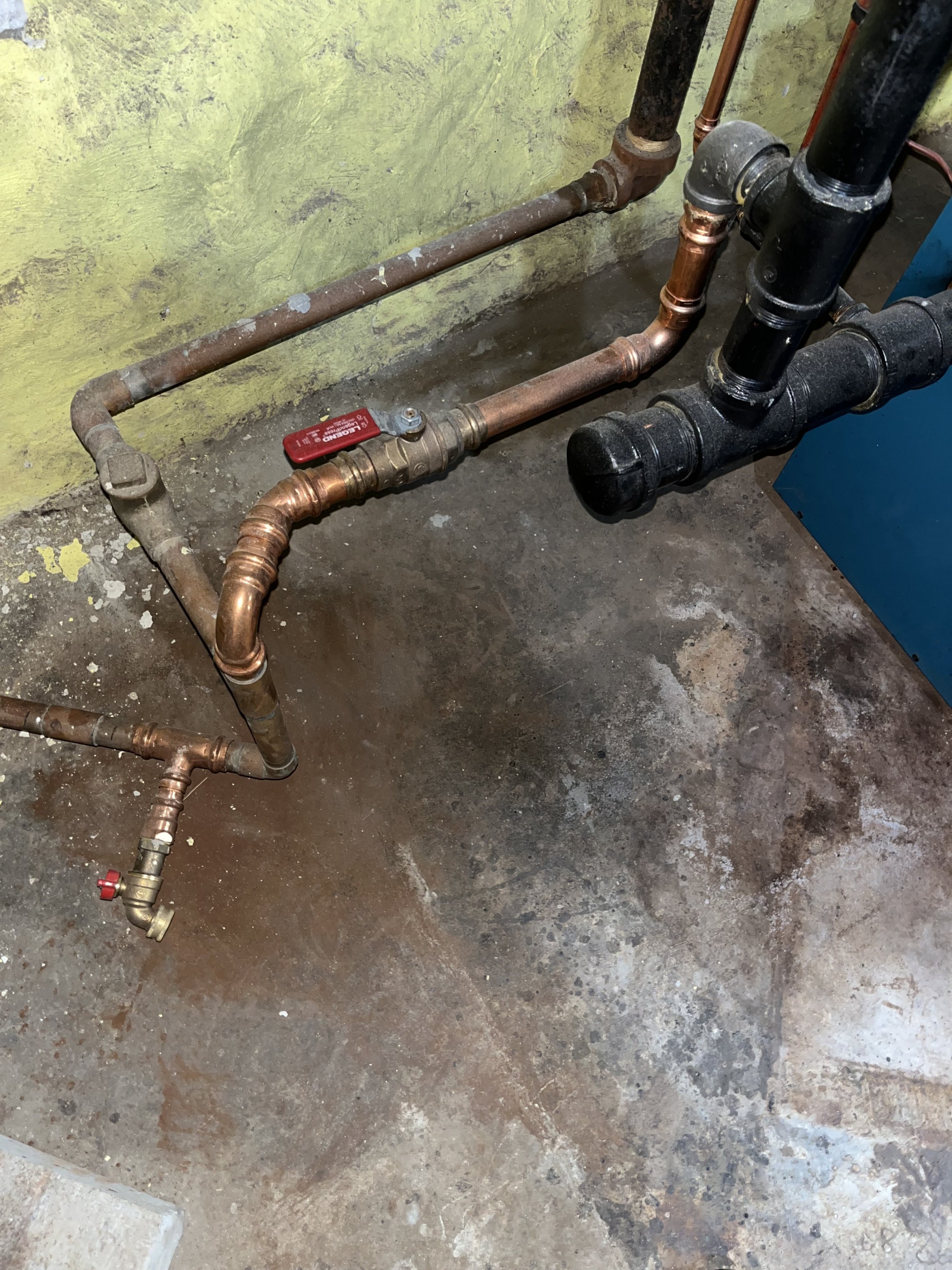

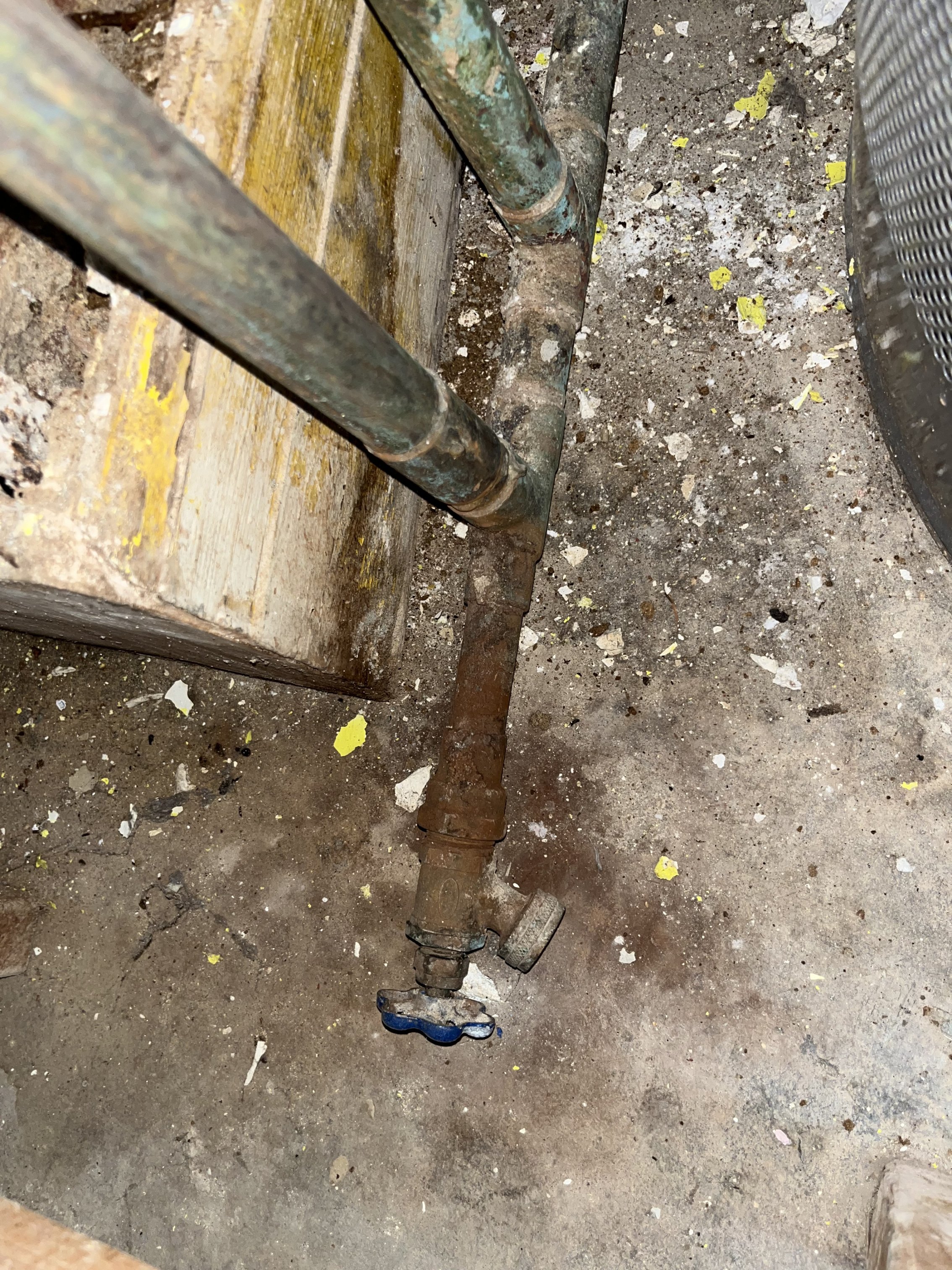

  • ive got an isolation valve on the return already.
    heres my two options to drain from on the wet return. they’re both 3/4 and I don’t think eother is full port. I am hoping not to have to replace either valve if I can avoid it. The red handle is near the boiler, and has 60 feet of wet return between it and where the main is currently opened up. The blue handle is right below where the main is opened up, but I think its probably a more restrictive valve.
    best option?
    109A_5 Posts: 4,759
    edited September 2025
    Yeah, I'd probably use what you have, certainly better than not doing it at all. Full port valves just give better flow, in your case you could just let it run longer, if needed.
    They Both look easy to change (threaded) if you wanted to. The Red handled drain valve is probably a ball valve, may not be full port.
    You could flush from Blue to Red then the other way too.

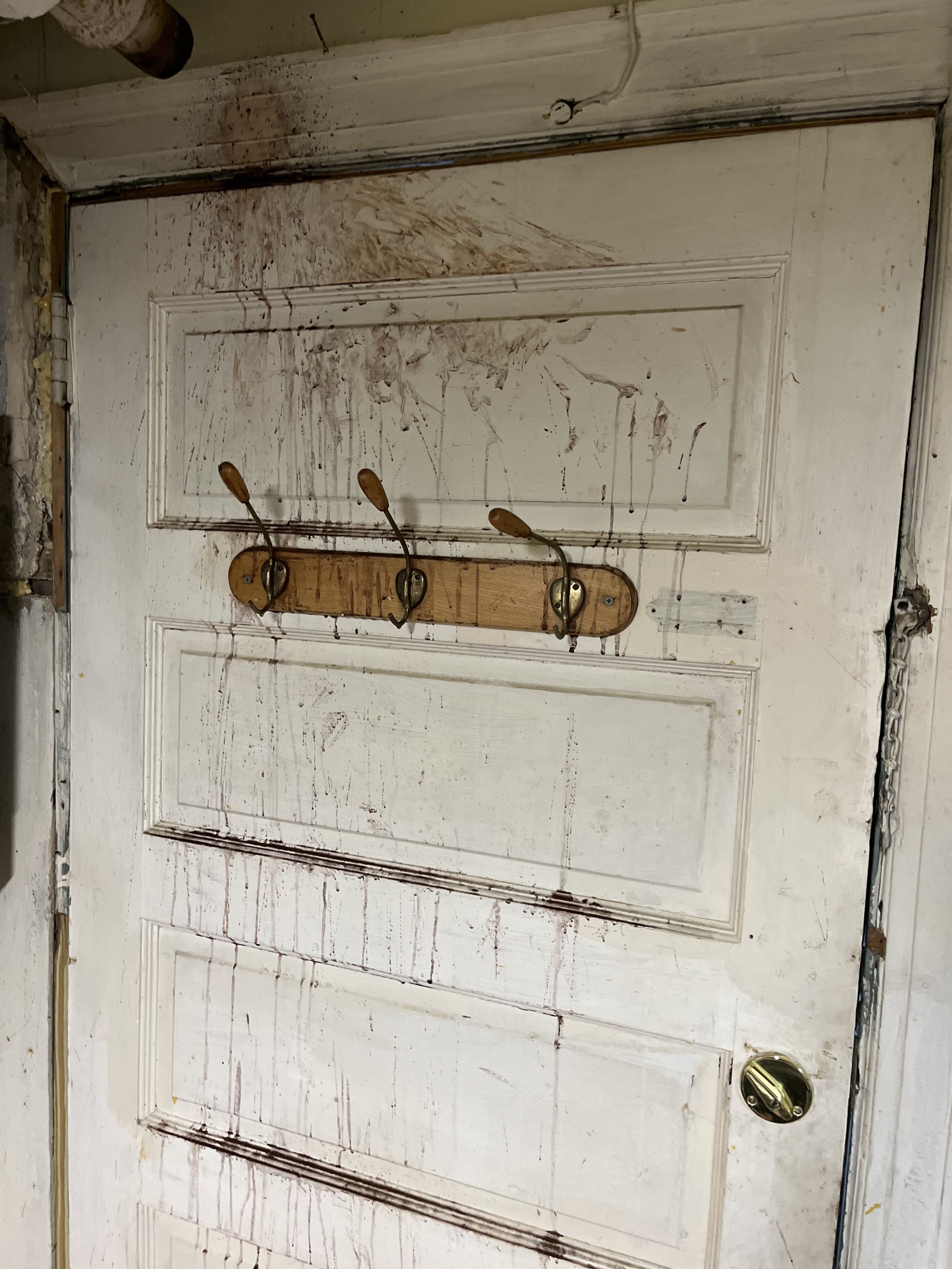

    I remembered I had a sewer jetter for an electric pressure washer which should be perfect for flushing out that pipe.
    it worked perfectly!! It got all the gunk out of the pipe and transferred it to my basement walls!!

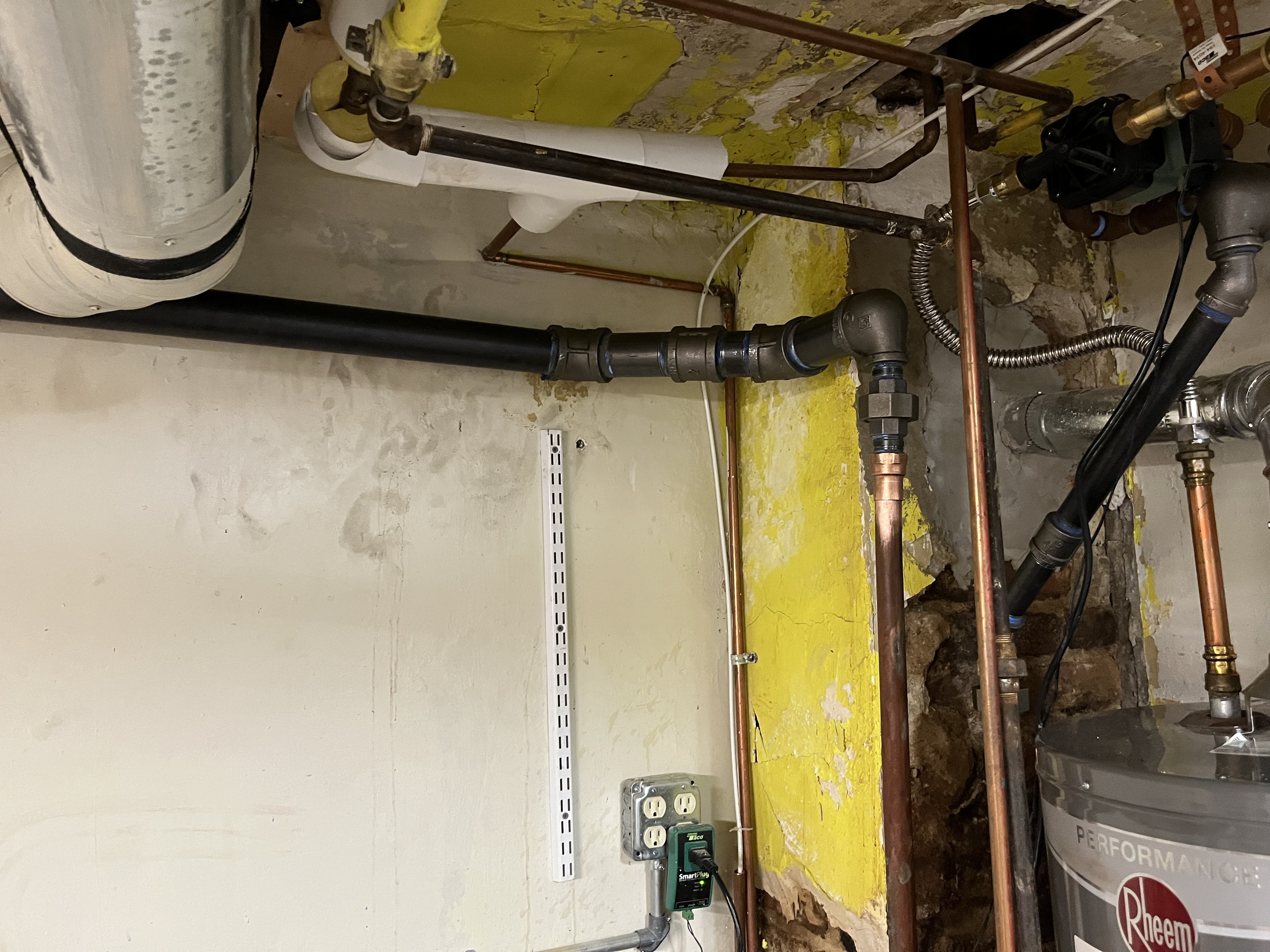

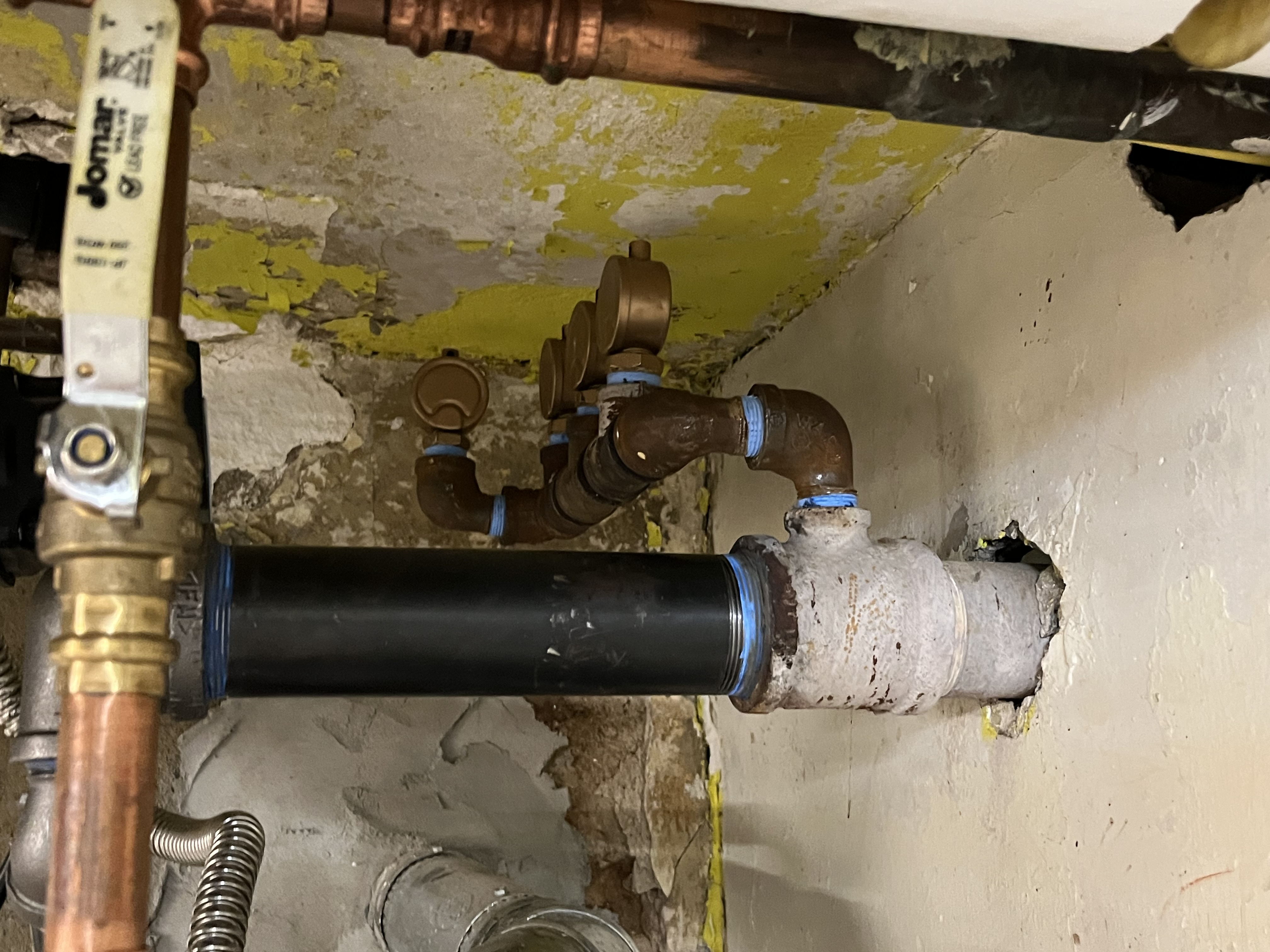

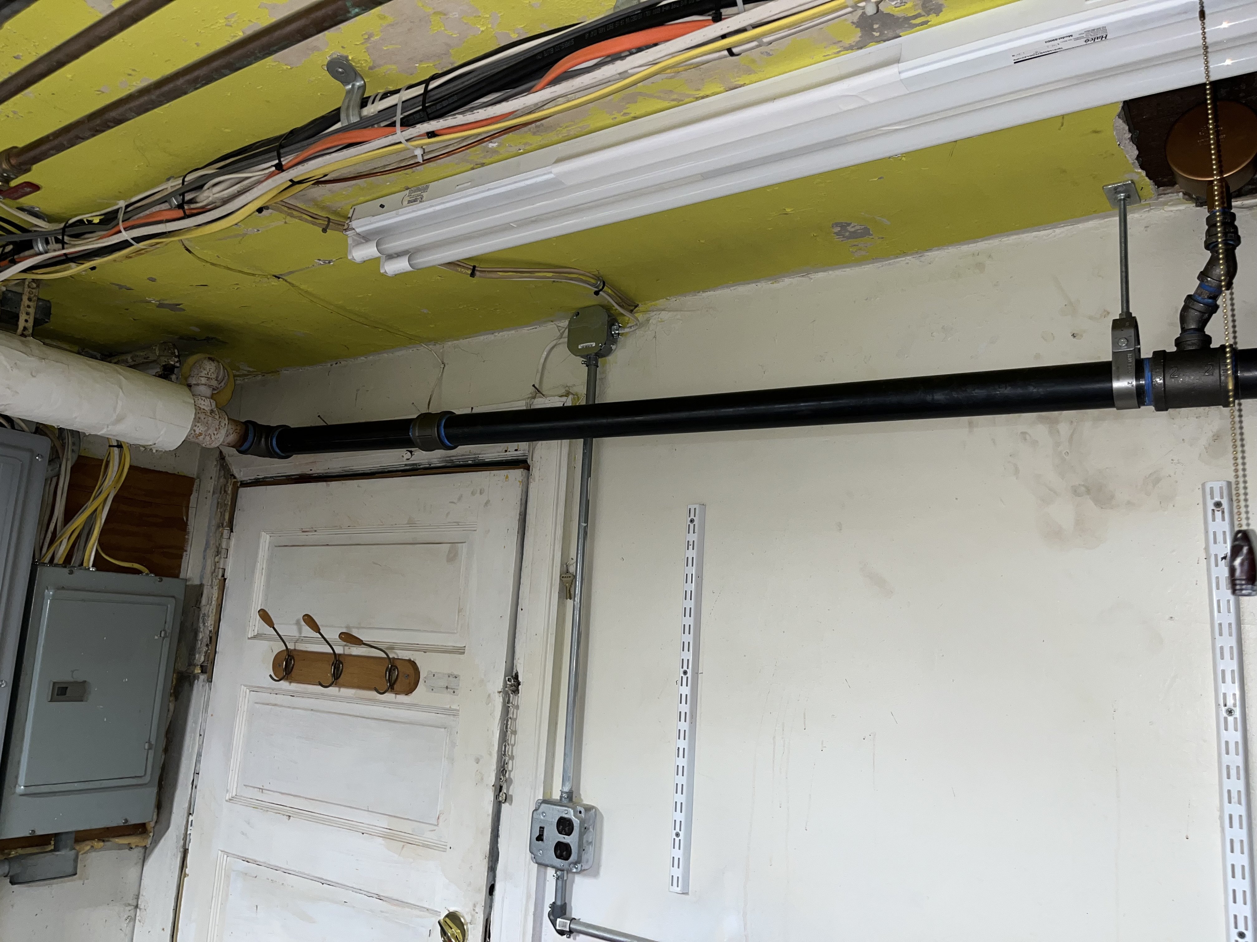

  • there one side almost done. Copper is dry-fit. Not yet soldered.
    Other side waits till friday
    Pipe is heavy.

    I like it, it should drain good. Maybe the only thing I would have done differently is put the vents in a place with better access. Maybe it is not as awkward to get to them as the pictures look to me.

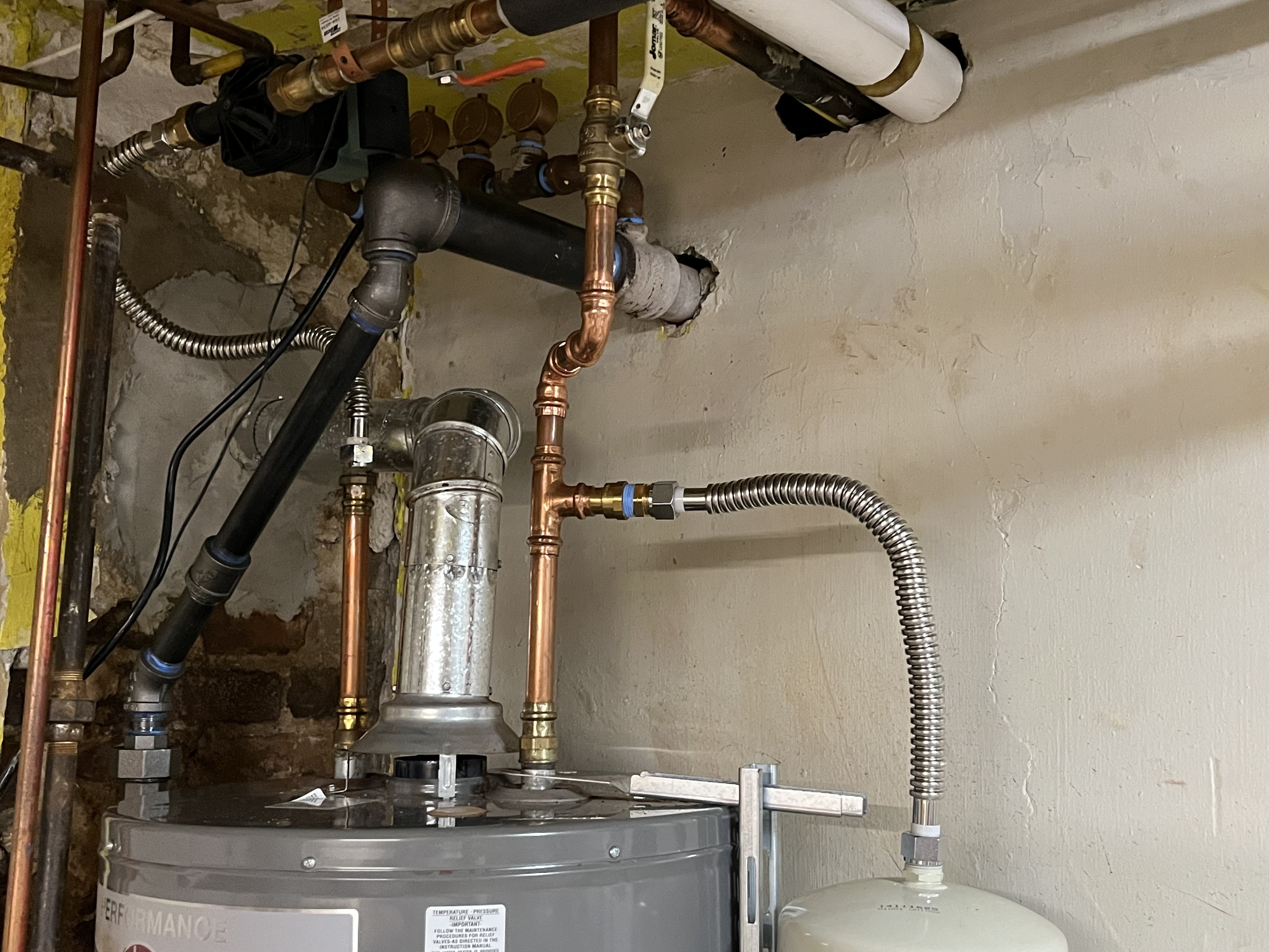

    thanks. I hear you about the vents but theres no good place for them. Ive got them pitched right now (they weren’t before) so hopefully its years before I have to get to them again!
    I was kinda shocked I put it all together and it actually lined up perfectly with the copper. Hopefully I have as good of luck with the other side
    109A_5 Posts: 4,759
    I was thinking something like this. But maybe it looks better from here.
  • trivetman
    trivetman Posts: 264
    yeah….it looks better from there! Too many other pipes and wires run that way and it wouldn’t have run with the right pitch.

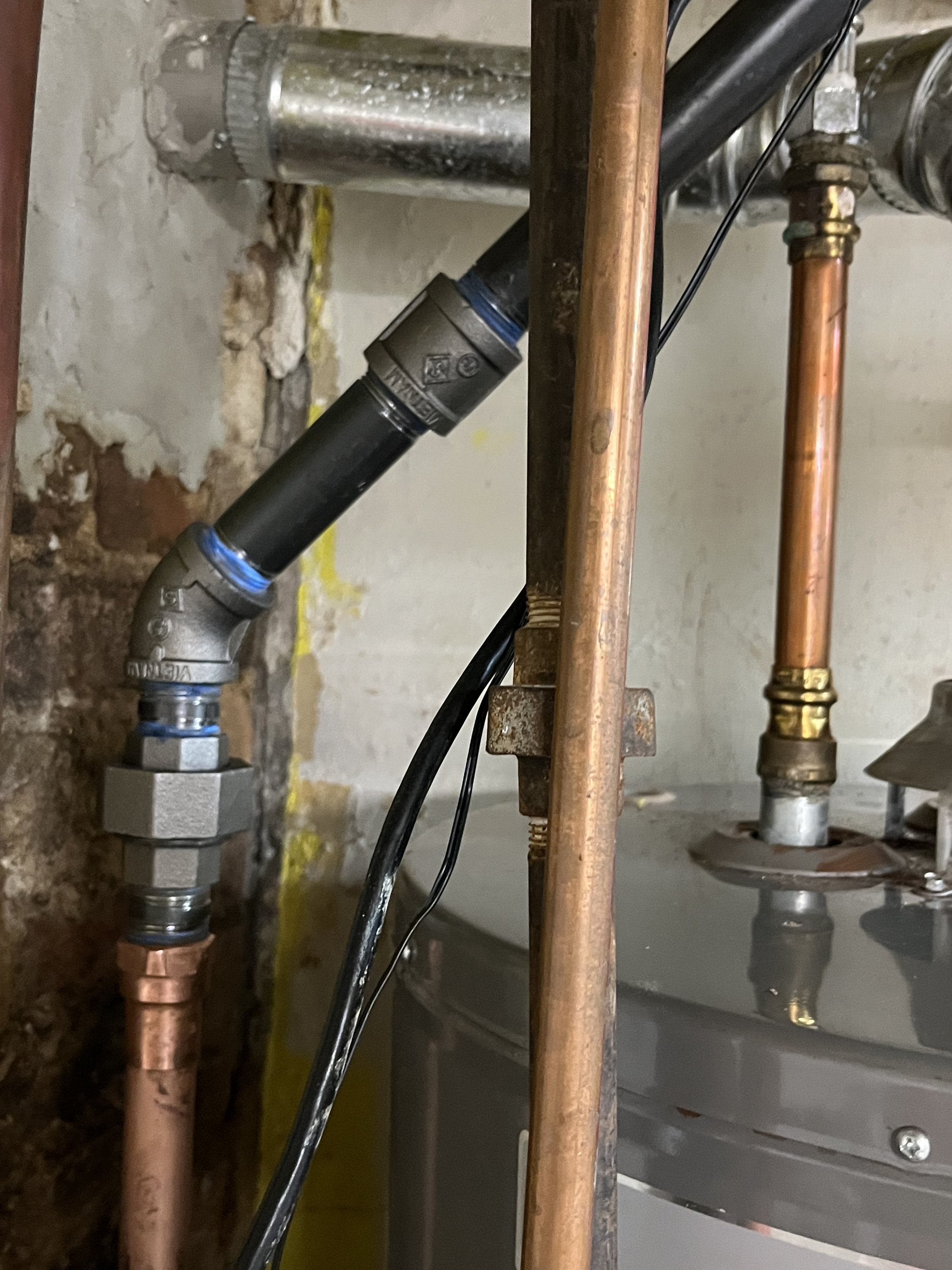

  • that….was….hard….
    to line it all up.
    Better not leak!!
