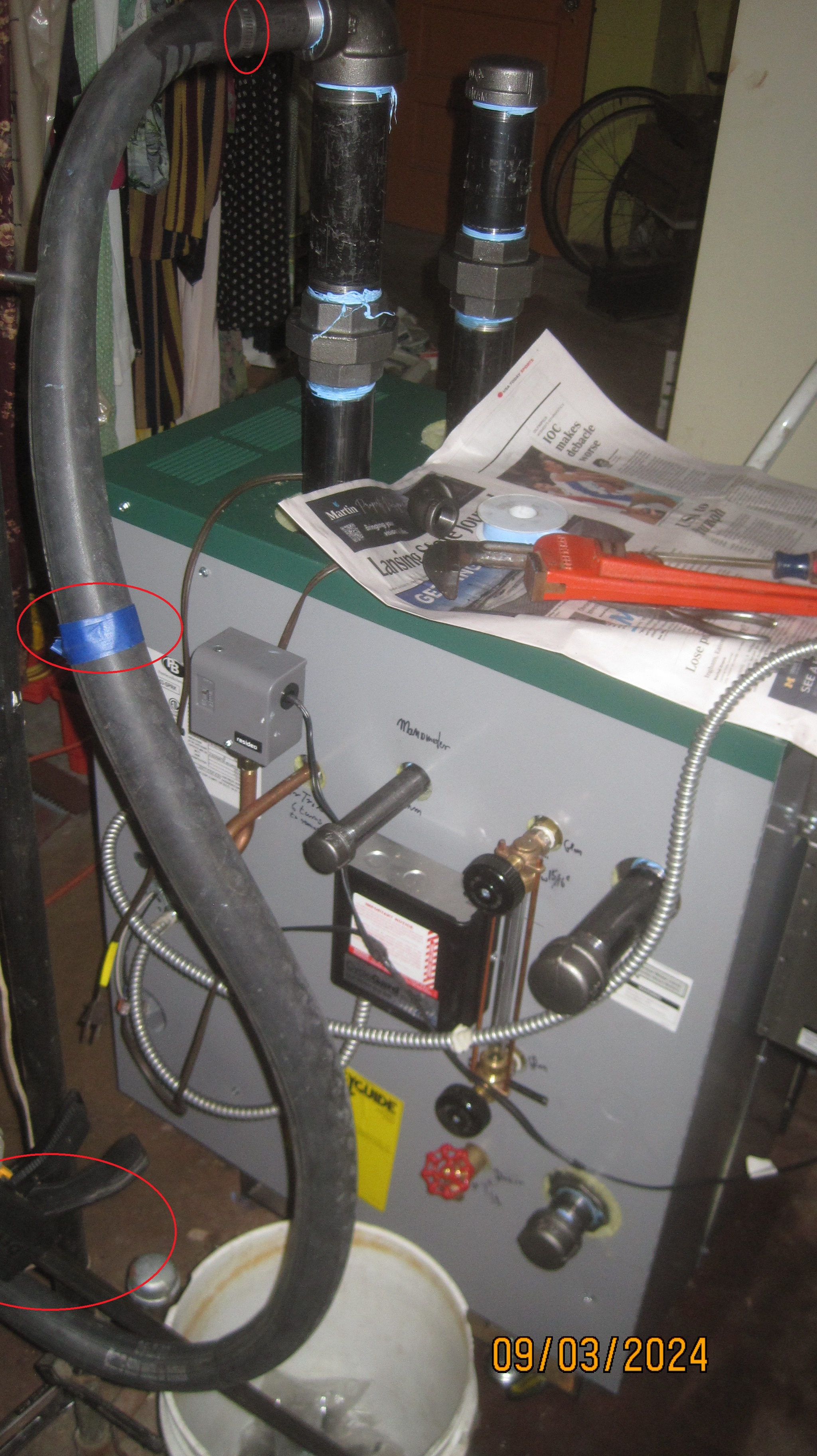

    I did this test on my new boiler with a bicycle inner tube cut open, slipped over a nipple attached to the boiler, and rolled up and clamped with a bar clamp on the far side of the valve. I then pumped the inner tube up — it was a good-size mountain-bike one, for volume — and went to town with soapy water and a brush, aka bubble test. I did find one place where the piping leaked, but only slightly, and that was where I'd deliberately left off the Teflon tape. Even so, it held pressure for a good half hour.
    I have a picture somewhere; it looked pretty janky but it worked.

    This is a pretty lousy picture of my test setup. I don't know what the pressure is — My guess is a pound or two at most — but it lets you check for leaks in your piping with soapy water, and will tell you if the whole thing is tight.
    The circled features are a hose clamp to seal at the boiler piping, a wrap of masking tape to show you if the tube is shrinking, and a bar clamp to seal the far end of the inner tube. I found it a useful exercise that gave me confidence to move forward. A pro would probably just not worry about it.

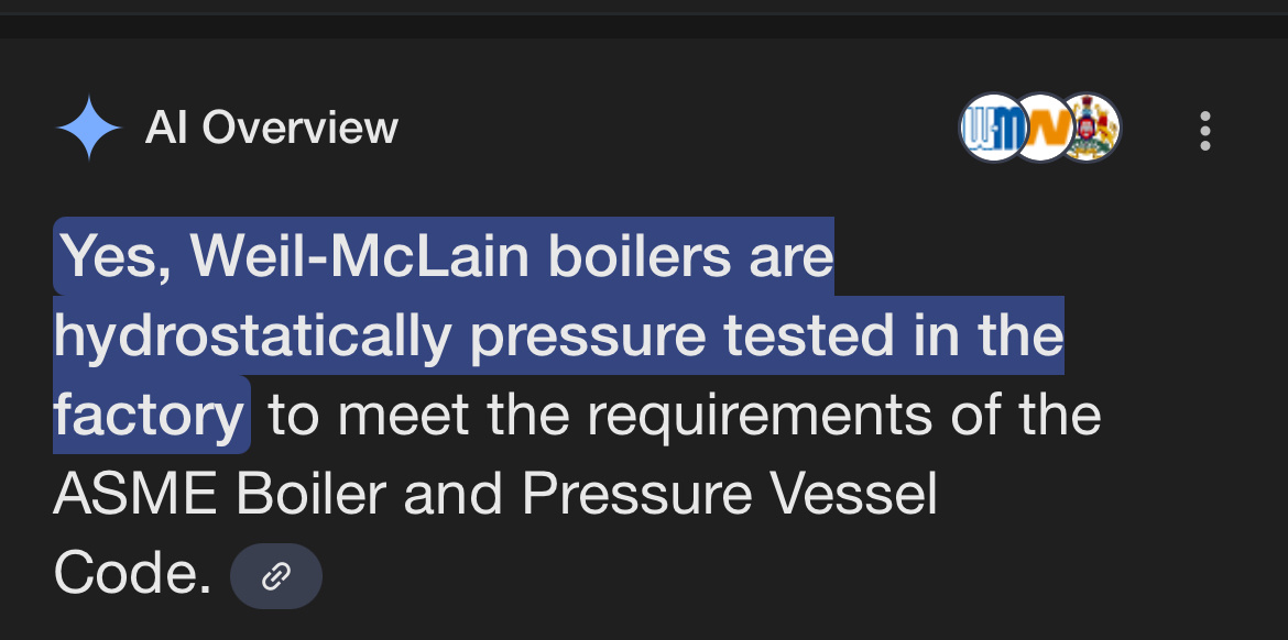

    hot_rod Posts: 28,705
    AI claims the boilers are factory tested
  • Well that settles it!
    Does AI know whether the boilers were dropped between the factory and the basement?
