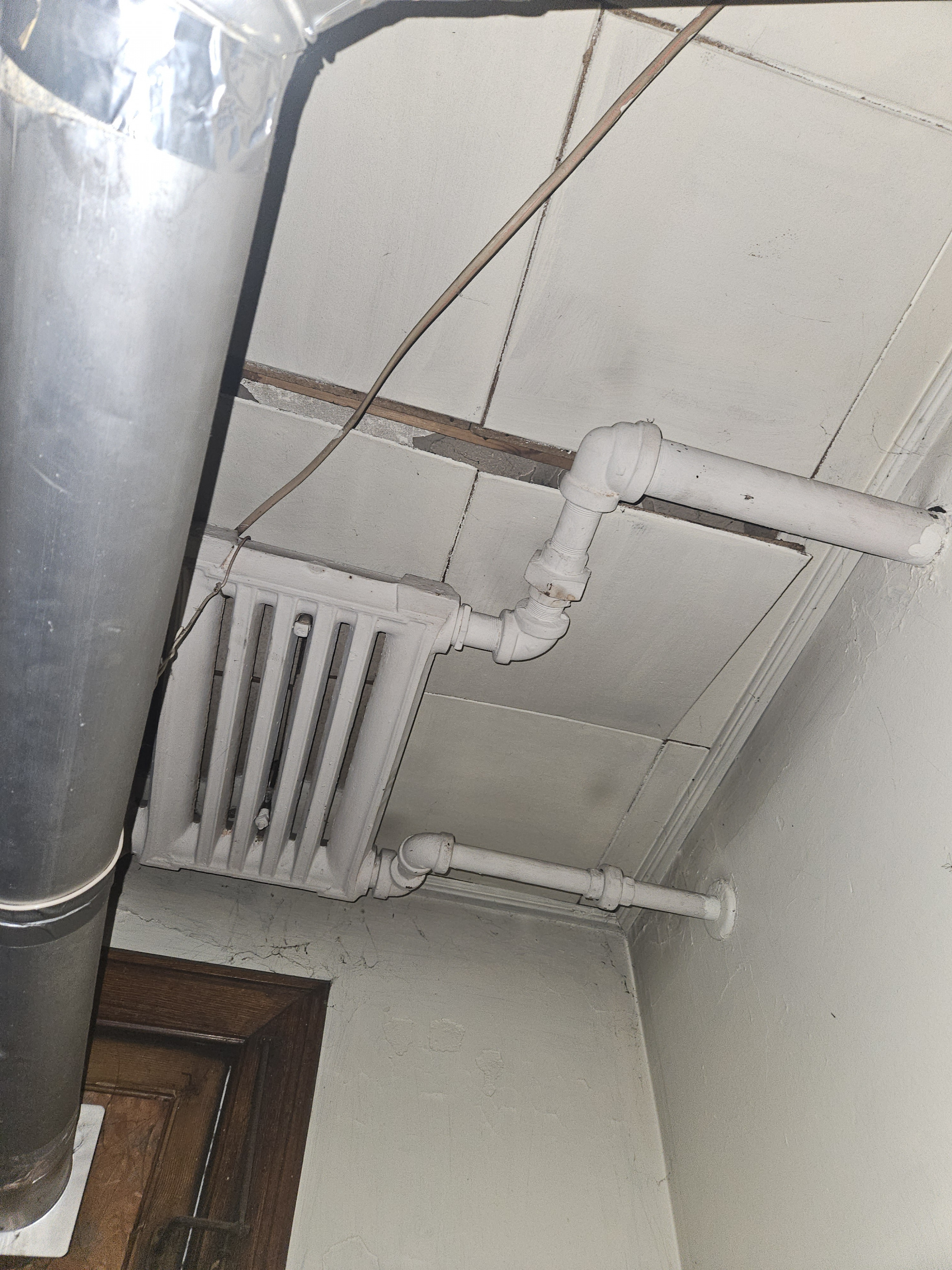

I'd like to add main venting, my mains do not have any. I'm unsure of where to add these vents. Two of my 3 mains run above the drop ceiling in 2 seperate apartments. I'll attach a picture of what the end of the mains look like in those apartments.
For staters, we'll call this Main 1. The main continues a few more feet to the left through the wall to another radiator. See pic, that is the end of the main.
I'll begin by measuring the lengths of the mains and the diameter of the pipe. From what I can tell it looks like it begins as 4.5" or 5" pipe before it necks down at the end of the run to 2.5." Is there any other information I should gather, so you experts can better guide me? Thanks in advance.

    You can find information about the proper main vent location on line however you may not find that you have a tee fitting at that ideal location. so you might try this.
    • The ideal location is about 15" before the last elbow on the main, just before it drops into the wet return. In your case that would be the last elbow before the last radiator.
    • Since there is no fitting at that location you can just drill a hole in the 2" pipe main. I do not recommend a hole large enough for 1/2" pipe on a 2" steel pipe because the threads are too course, 3/8" pipe threads are somewhat finer and a 3/8 close pipe nipple will not restrict air flow that much. then you can use a bushing to increase to 1/2" with a bushing .
    You should have the vents about 10" above the bottom of the main, so a 1/2 x 8" pipe nipple should do fine. You may need to take a ceiling tile above the vent location to accommodate that vent.
    Other steam experts may have a better idea, but this is what I would do in your case.

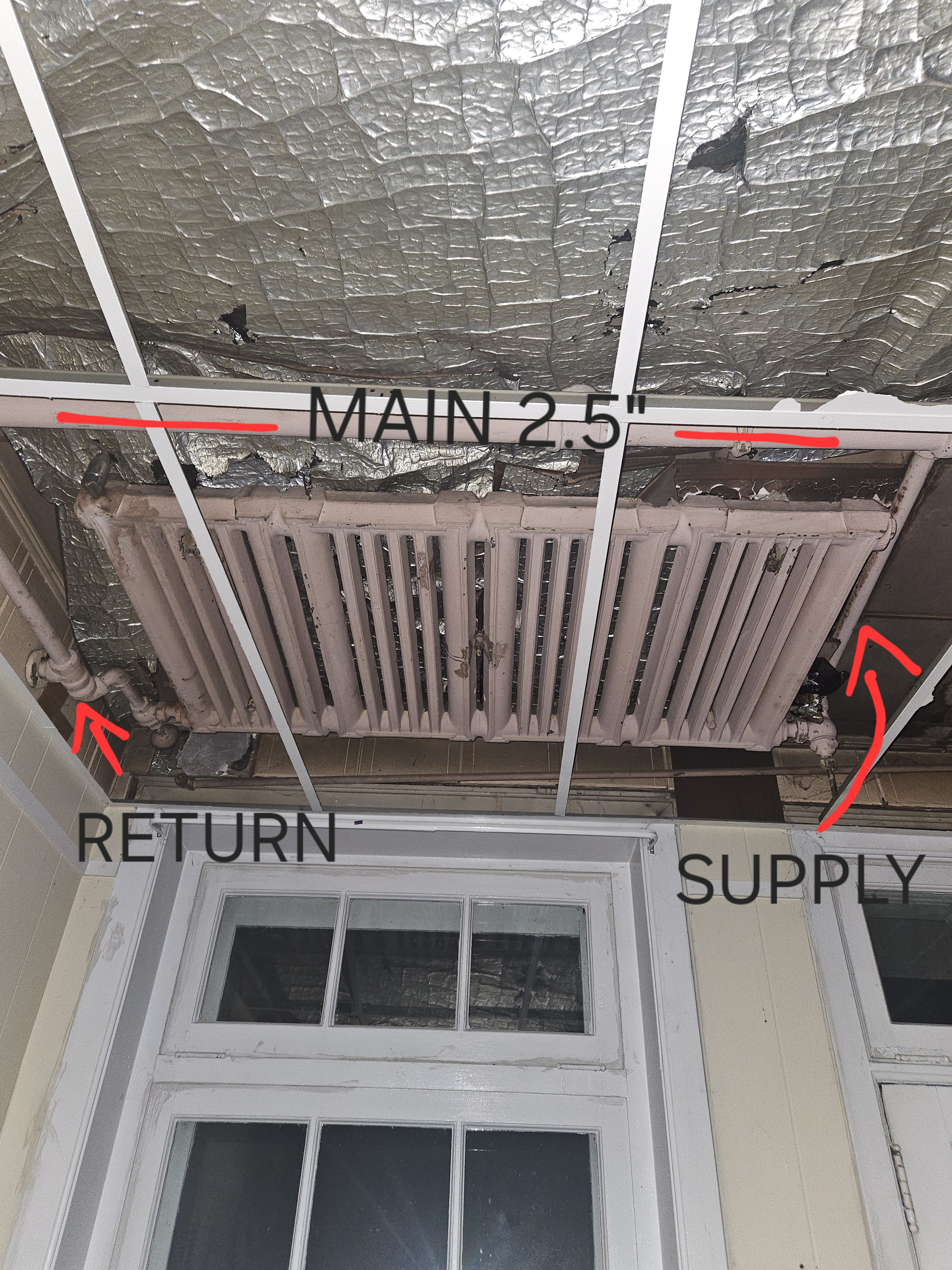

    My main1 and main2 end at ceiling radiators. I plan on doing exactly what @EdTheHeaterMan described at the beginning of the thread. However, I only have roughly 15'' from the top of the 2'' and 1-1/2'' pipe with the ceiling tile removed and butted to the subfloor above. Tapping a 12'' nipple plus a Gorton 2 is out of the question so I guess I'm looking at numerous Gorton 1s on an antler? Thoughts and suggestions are appreciated, thanks everyone.
    mattmia2 Member Posts: 17,474
    Does that return drop individually to a wet return? If so you could put the vent on the return riser from the wet return.
    You could look that 3.2" up in an iron pipe table in the OD column. I'm betting that is 2.5" since .1" is pretty thin for the wall of steel pipe.

    @mattmia2 is there where you were suggesting? About 15ish inches back from that 22º fitting?
    Leading up to the elbow before dropping to the wet return is about 15-20' of pipe would i want to have the vent closer to the last rad or closer to the drop into the wet return.
  • grantsweatshirt
    grantsweatshirt Member Posts: 25
    @Steamhead any insight? a few comments up I posted steam main diameters and lengths.
    I'm pressed for overhead clearence where @EdTheHeaterMan suggested placing a gorton #2, even with the ceiling removed i only have roughly 15". So, based on the tapping and nipple size suggested I would be short. I was wondering if its suitable to add my main vents to the circled location just before elbowing to the wet return. Thanks.
    You could put a tee and an ell and a 6" or so riser and put it here where i circled in green:
    that may/likely will make that radiator heat a little earlier than the other radiators.
    Steamhead Member Posts: 18,710
    The Gorton #2 comes with its own "riser" built in. You can get away with screwing it into a tee on the pipe. 15" height above the pipe is plenty.
