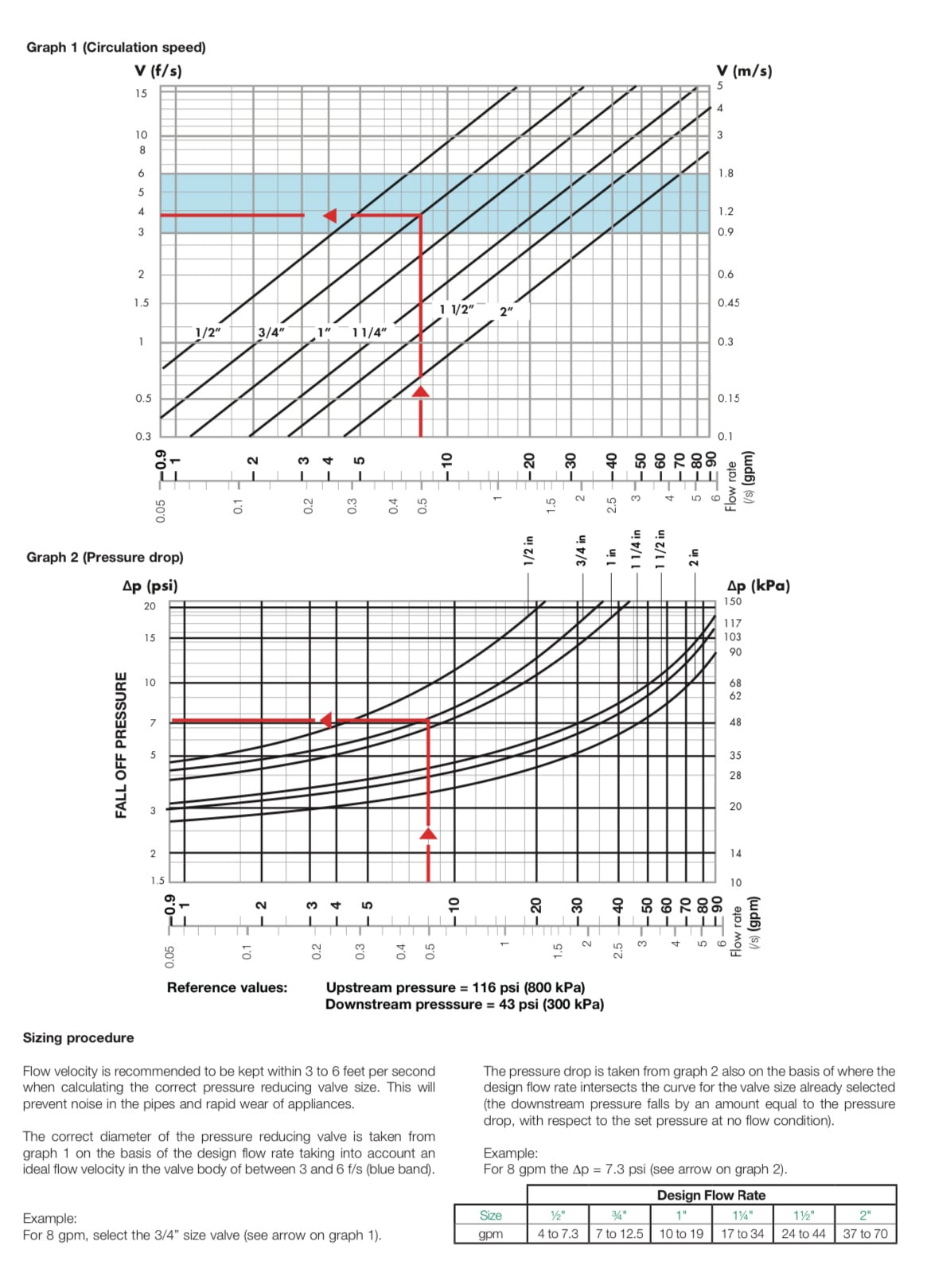

    hot_rod Posts: 28,524
    do you have a water meter in the house or out in the yard in a meter pit? Most of the water meters, or the yoke they go into have backflow devices built into them.
    If your water department receives federal funding, BFDs are required.
    The .25 is the pressure difference across the check for it to open. Called delta P. So as you open any faucet the flow movement will cause a pressure drop(dynamic pressure) allowing the check to open. Nothing to do with Cv.
    The Cv is the gpm that flows through the valve with a 1 psi drop. So if you have a check with a Cv higher than your anticipated flow, there is on pressure drop penalty.
    As far as the PRV , most PRV sizing is around a 7 psi drop at full flow. This is known as fall off pressure. The Caleffi PRV have an excellent flow passage, so the pressure drop or fall off is very low at higher demand gpm. The correct way to size a PRV is by the flowrates/ fall off pressure. An example attached.
    Of course your long piping runs after the PRV will be the cause of the pressure drop in the building
    So high fall off could be your main line from the city is undersized or partially plugged. You could run a flow test before you PRV to get this info.
    I think current plumbing codes requires no less than 20 psi, not to exceed 80 psi in the home. So officially is the most distant fixture never drops below 20 at full demand on the system, you are covered.
    Most PRV have a strainer in them, check that ocassionally as it will be a pressure drop concern.
    I would install a check before the MOEN.
