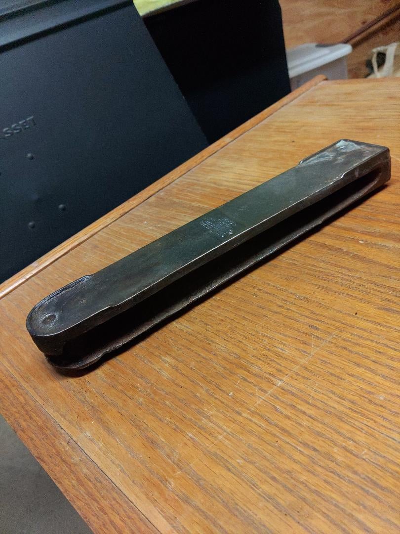

What are these? What are they called, and what was their purpose? I recently removed these from under a CI radiator. They were also under others throughout the house. I have never seen them before.

    Is that top part cast iron?
  • I was wondering the same under this hot water radiator.
    Steamhead Posts: 19,022
    I'd say they were to spread the radiator's weight around so the legs wouldn't wear out the floor.
    Semi-retired
    ethicalpaulPC7060Mad Dog_2CLamb
  • PC7060
    PC7060 Posts: 1,982
    and maybe the slotted middle provided a air gap to reduce heat damage to floor?
    mattmia2 Posts: 18,437
    probably help them slide as they expand and contract too
    Mad Dog_2CLamb
    Intplm. Posts: 3,164
    The first picture. The one on the top. The item on the right. That is the way they were installed. The other side has dimples on the end I think those dimples caught the floor for traction. These things seem to act like shock absorbers.
    What are they??

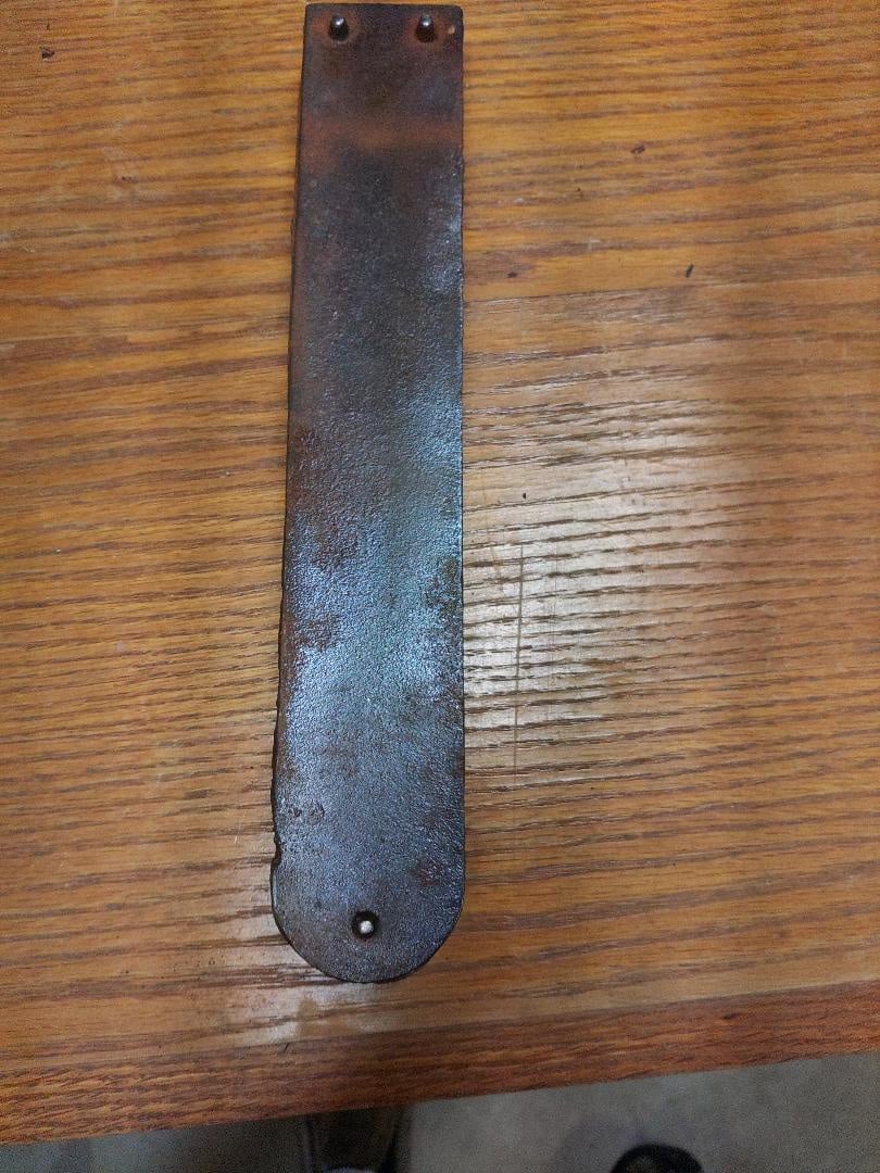

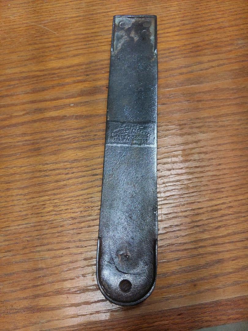

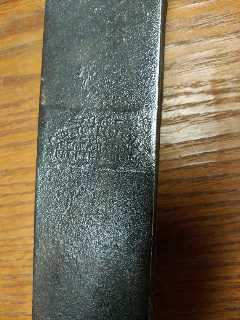

    It's been a while since this post. Was cleaning up the shop last night and found it again. Cleaned off the many layers of paint and other debris. It came out of a late Victorian three-story house. I replaced the steam boiler some time ago. These were under almost all of the radiators.

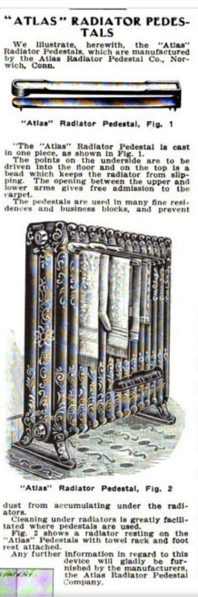

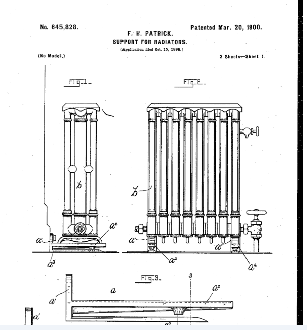

    If I'm reading this correctly, it says "-Atlas- Radiator Pedestal," Norwich, Conn. PAT. MAR. 20H900…
    I have never seen these before. Has anyone?
    Wow! How very interesting. @reggi Where did you find this information?
