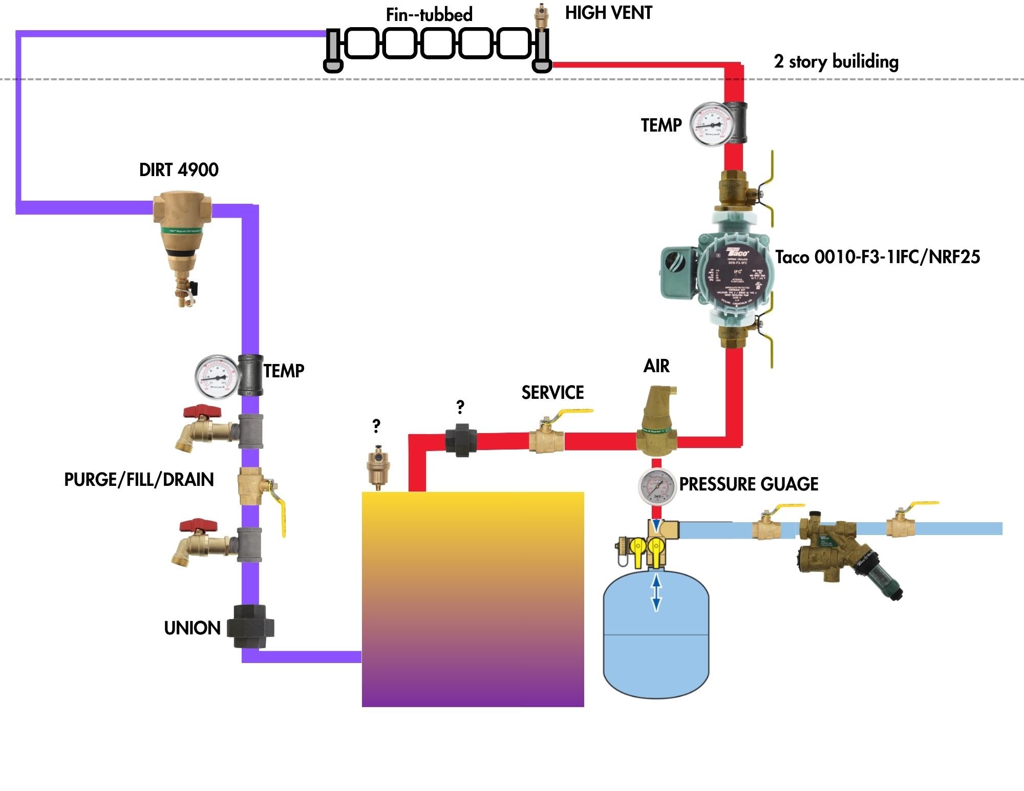

Is this what you are suggesting?
Expansion tank with air separator and MU at the same T?
Aha! Ok! I’ll see if I have the vertical clearance at that union up top. Curious if another spot could be the tee where the expansion tank lives now for the air separator?
or why it’s best to get the air operator up high.
Thank you!
Thank you! I'm starting to think that the previous work we had done (which included replacing the failing Series 100 circulator), wrong circ may have been chosen by the contractor (Taco ECM 0015E3F4)
Learning and reading more here especially about gravity conversions makes me think that the Series 100 (or the like) was the correct circ for the job which may be needing a higher flow rate.
The issues I had last winter after the circ replacement was low heat on the upper floor and especially the furthest away. Seemed they were trying to bleed as usual which helped for a bit and eventually were resolved. Yet, the heat was adjusted to much higher than I had ever used (I've been here 20 years).
I'm trying to sketch out the piping and hoping to post soon.

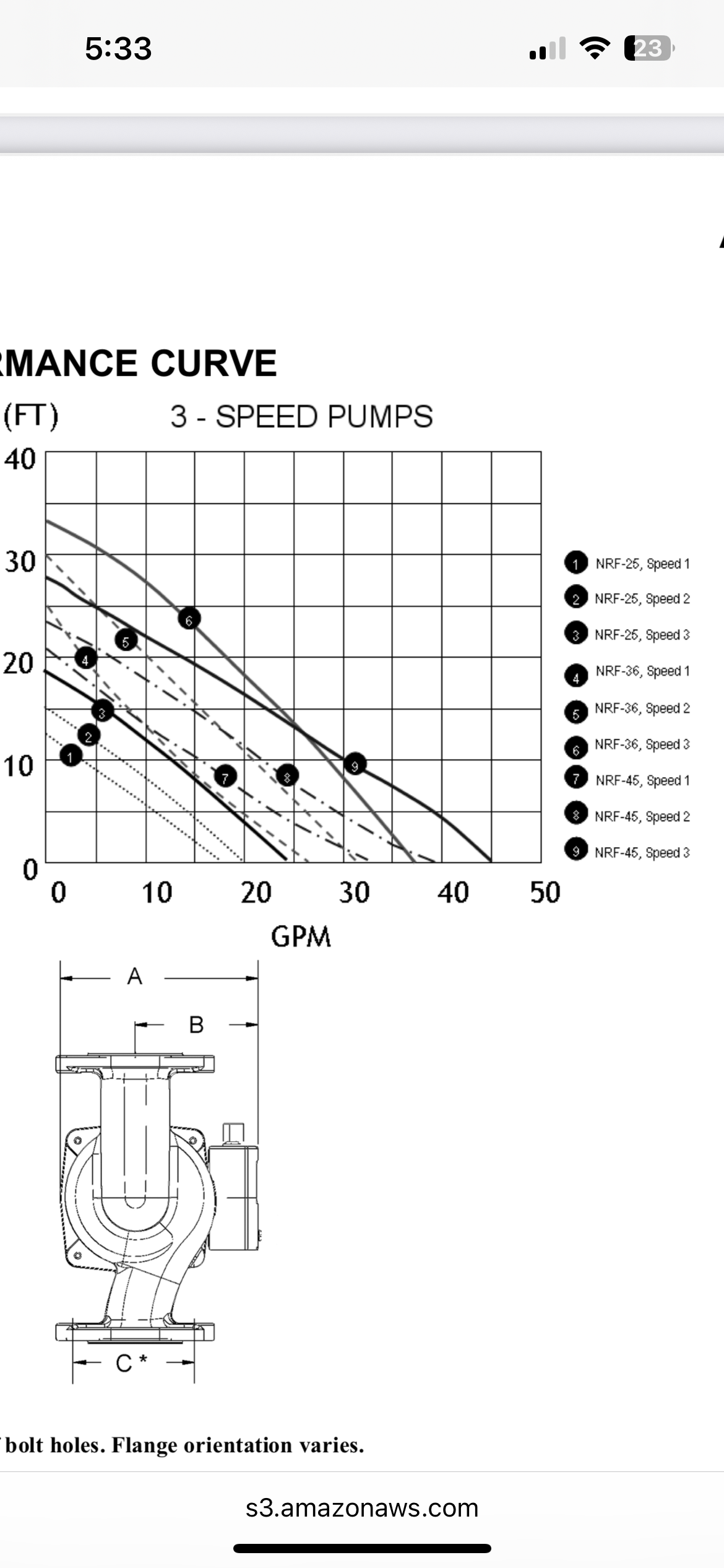

Hi Alan,
Finally getting back around to this project. I followed some guidance here regarding calculating the head and volume of the system to ensure I have the correct circulator specs, yet curious if I'm on the right track.
If this is close to correct, I think I would need a circulator that delivers around 14 GPM at 20 foot head? The height of the top floor radiator is 16 feet from the bottom of the boiler). The "new" circulator (Taco ECM 0015) that seems to be having trouble replaced a Series 100.
Are you adding all those head losses together? You should just take the longest possible path and figure that as your head loss. Other parallel paths don't add head loss, they just add flow.
In any even, you don't need a pump to pump to the highest level (your 20 foot figure). All the circulator pump needs to do is keep the water flowing around the loops — so even if your head loss figure of four feet is right, that's all you need. Keeping the water in the system up to the highest point is taken care of by the static pressure in the system — and the usual 15 psig would be enough.
Building superintendent/caretaker, 7200 sq. ft. historic house museum with dependencies in New England2 -
Thank you, Jaime. Very helpful!
Yes, it seems I was taking into account each unit and the losses incurred, which I'm guessing is not correct.
Is psig the same figure as GPM in regards to circulator specifications?
Would my longest possible path would equal the length of piping from from boiler to the furthest radiator? (I'm still not certain on how this building was piped i.e. reverse return, etc..).
If only having a 4 foot head loss and 15psig, it would seem the Series 100 specs meet this criteria much better than the Taco 0015. Or am I off base?
The only thing you need to calculate is the water circuit with the highest resistance to flow. Building height means nothing. PSI means nothing. Find the circuit that has the most resistance at the flow it needs. That is the head the pump needs to overcome. Then use that head with the total flow you need for all circuits.
2 -

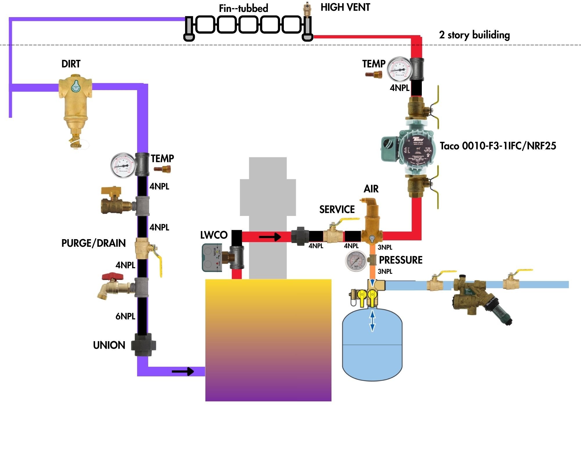

Hi @hot_rod and @EBEBRATT-Ed, circling back on this project. If I was able to re-pipe and add some elements, am I on the right track with this photo of a design? Thank you for any guidance!
Piping looks good. You probably do not need the purge valve above the boiler, the air purger takes care of that.
I'm still not sure that 0015 is the best circ for the job.
Ideally you want a circ to run mid curve. The B&G was a near perfect choice. The 0015 is near run out on the curve. If 14 gpm @ 4' is what you need?
Living the hydronic dream1 -
Thank you, @hot_rod !
The purge valve was a recommendation I noticed from @DanHolohan in one of his Pumping Aways videos. I may have misunderstood.
The switch to the Taco 0015 was initially related to the Series 100 noise, wattage and occasional impeller replacement. I was hoping the installer was choosing the correct replacement yet that seems to not be the case. Aside from going back to the Series 100, do you have a recommendation on another circulator choice? Maybe a 007 or Grundfos Super Brute 15-58?
