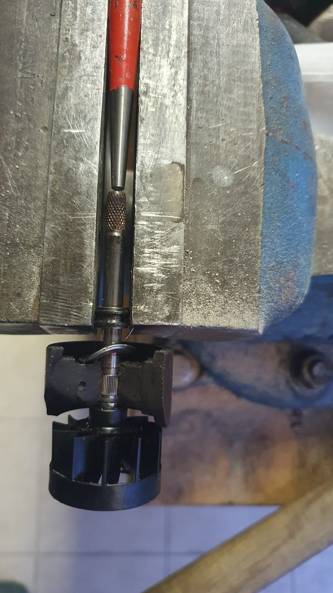

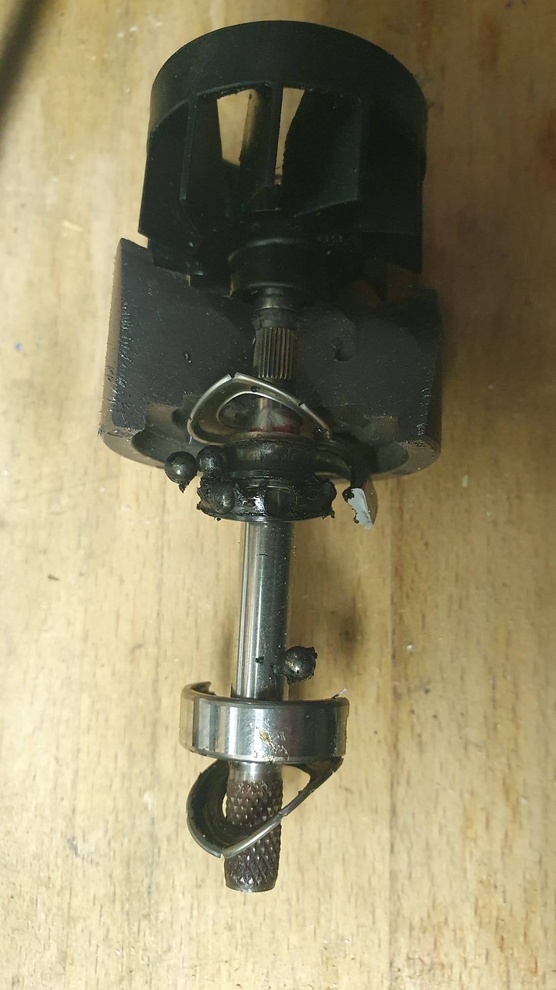

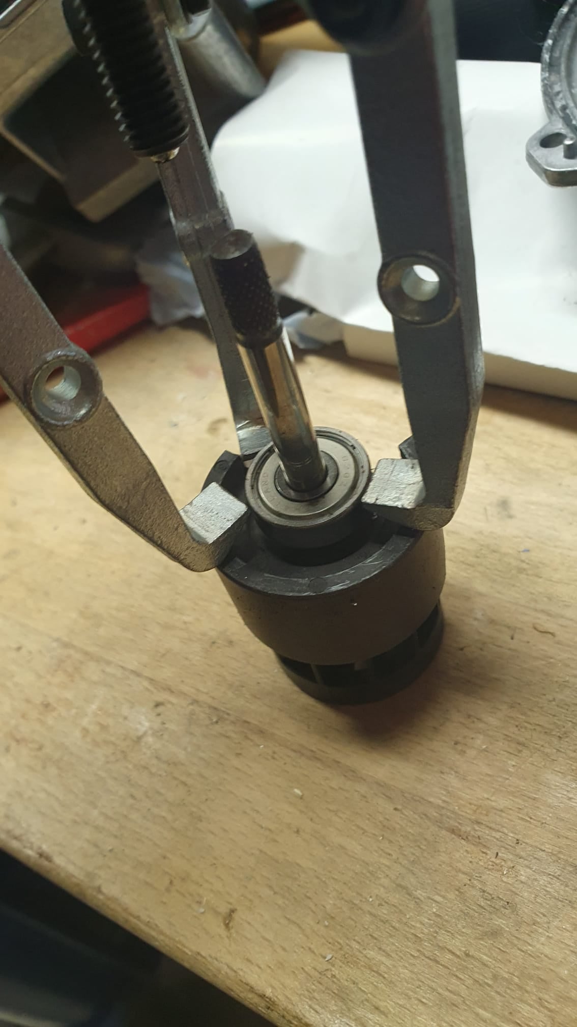

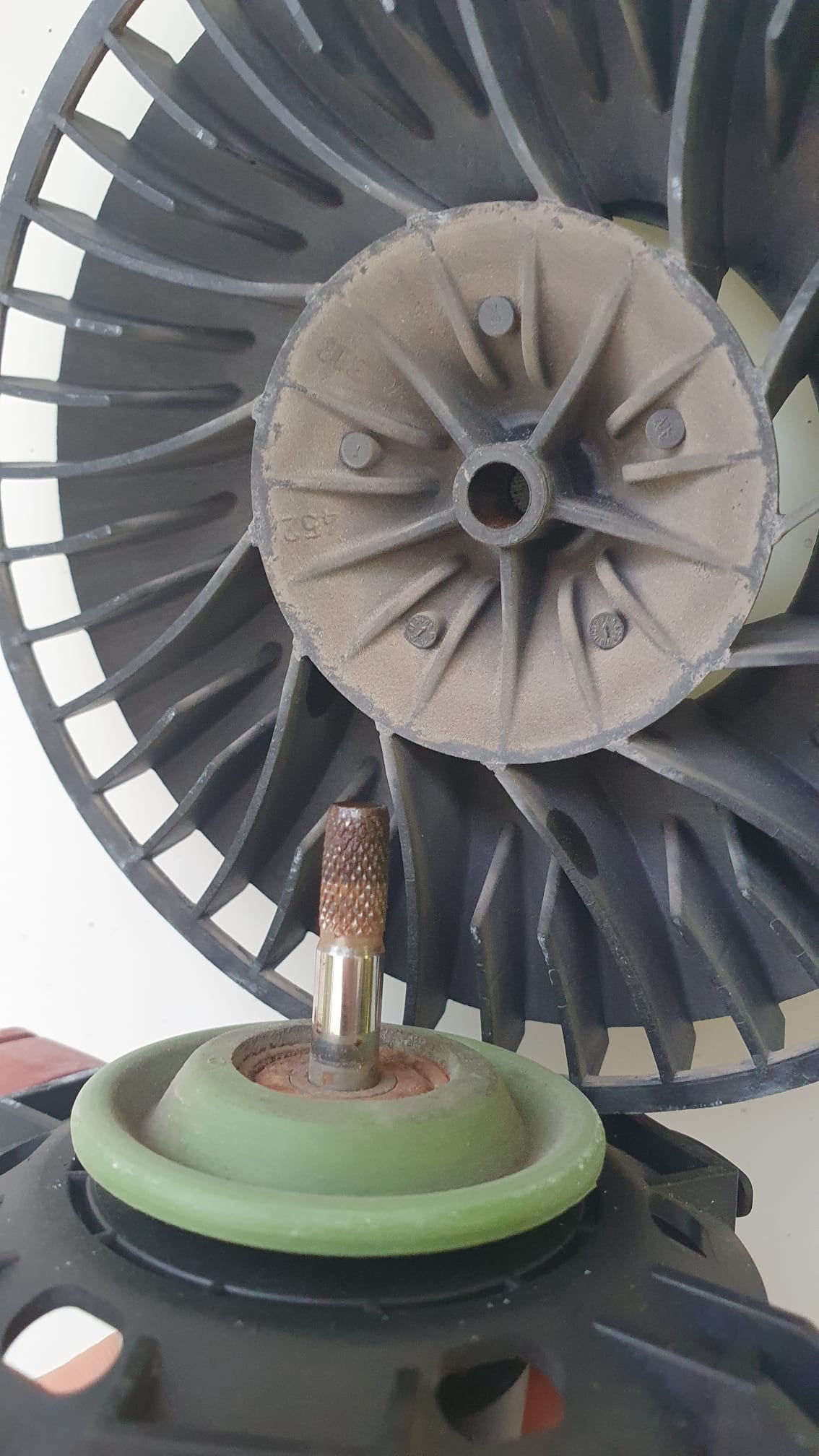

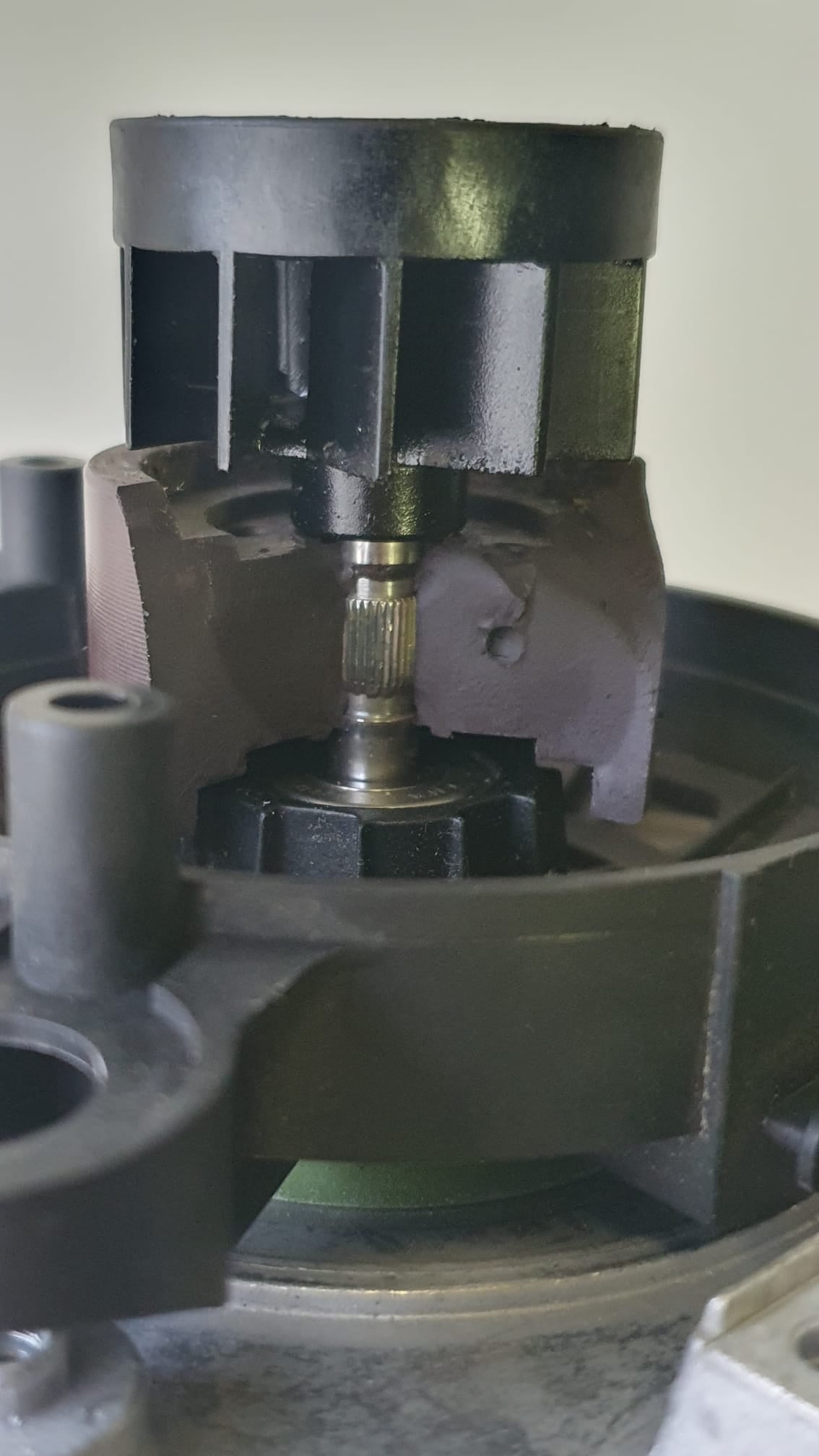

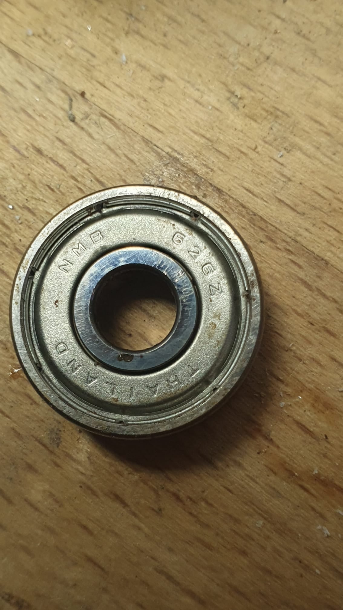

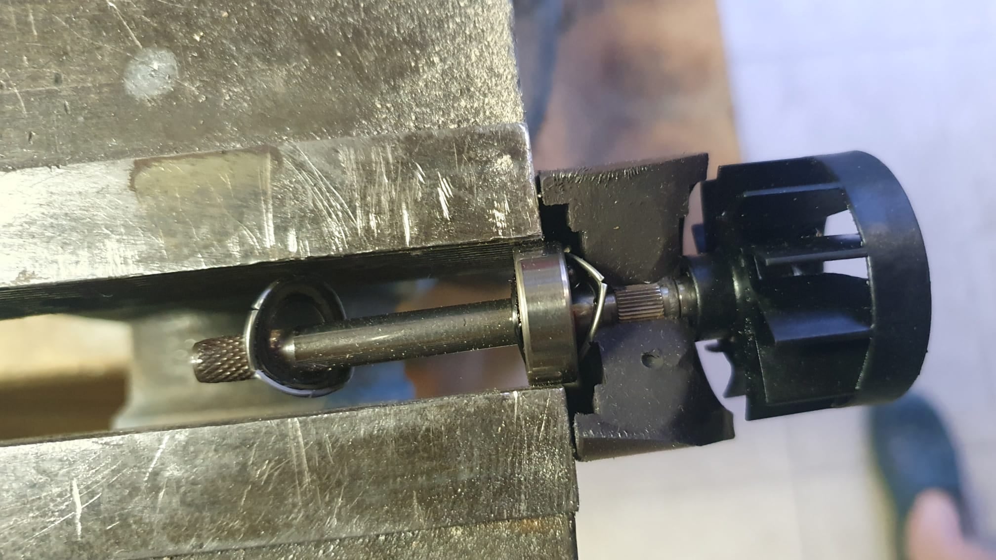

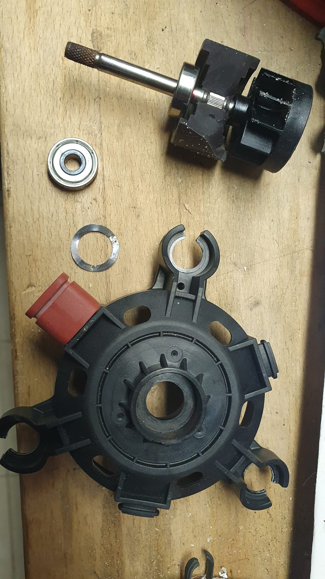

    At first, I tried to pull the magnet off with a bearing puller. Don’t do that — the magnet cracked. You have to start disassembling it from the other side.
    1. You need to knock the shaft out of the centrifugal fan. It comes out fairly easily. I used a hammer and a blunt pin punch. This separates the plastic fan from the upper aluminum part.
    2. The first bearing can be removed in the same way. Use a piece of pipe as a support so that the plastic doesn’t crack.
    3. The second bearing is more difficult because you can’t get to it, even with a bearing puller. First, use a marker to mark the position of the bearing on the shaft so you know where to install the new one. I clamped the bearing in a vise and it cracked. Then I clamped the remaining part that was still stuck on the shaft and knocked the shaft out with a punch.
    There are two standard 626Z bearings (metal-shielded on both sides), costing around €2 each.
    Reassemble everything by following the same steps in reverse. I repaired the cracked magnet with epoxy.
    The fan now works like new.

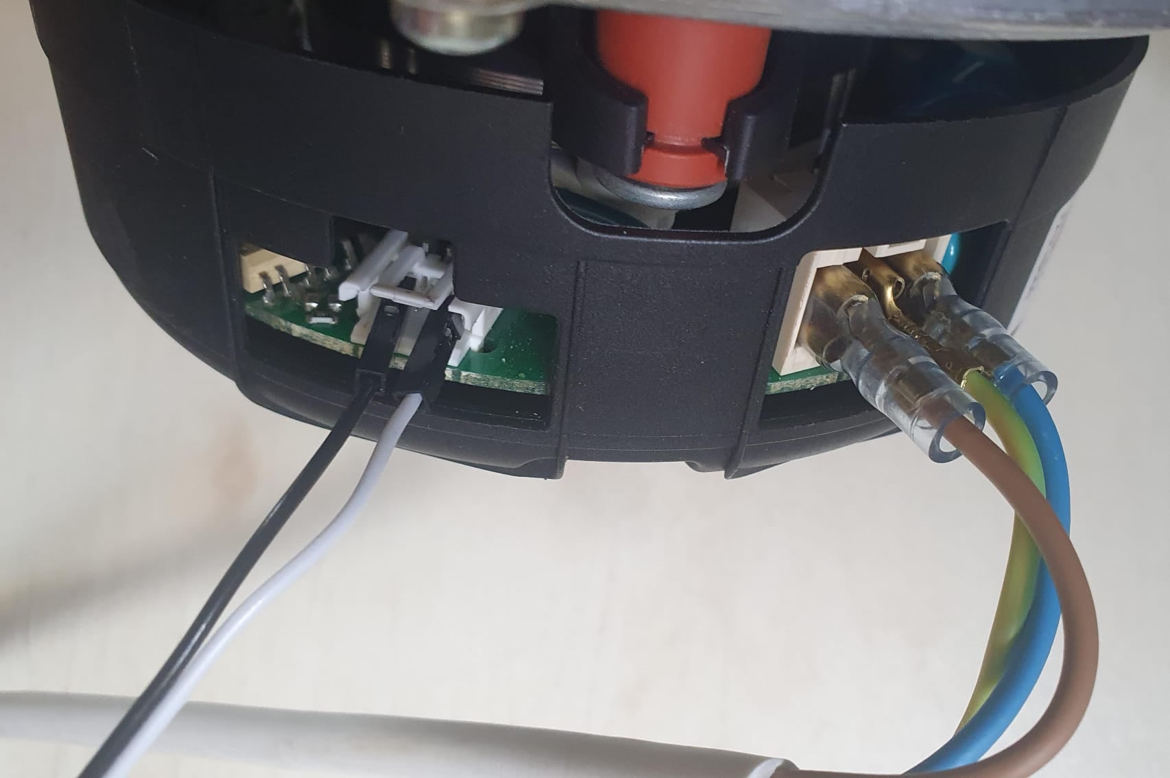

    If you want to test the fan outside the boiler, simply connecting it to 230 V is not enough, as the fan is PWM-controlled. However, you can connect 0 V to the left pin of the second connector and +5 V to the right pin through a 220-ohm resistor. The fan will then run at full speed.
    Keywords: Viessmann Vitodens 200 WB2B ebm papst NRG118 radial fan bearing replacement
