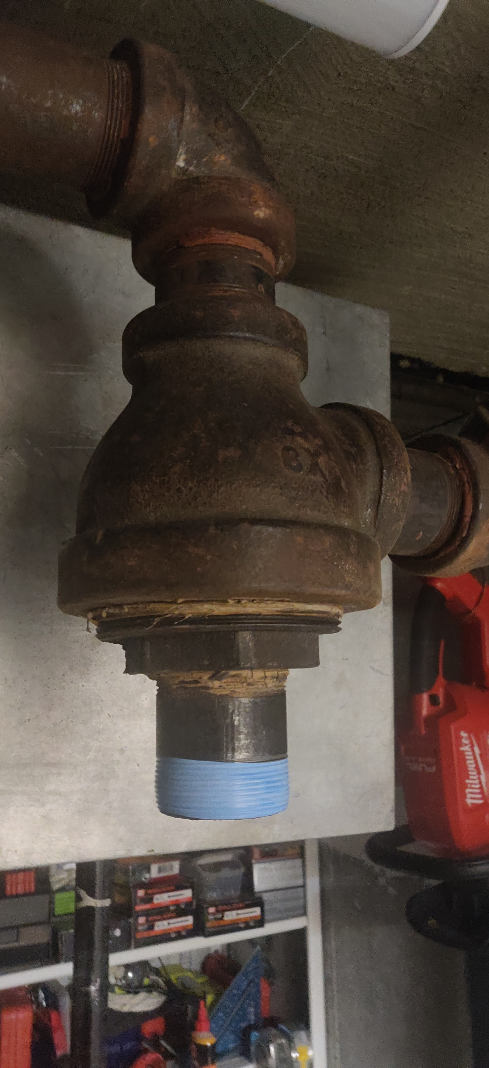

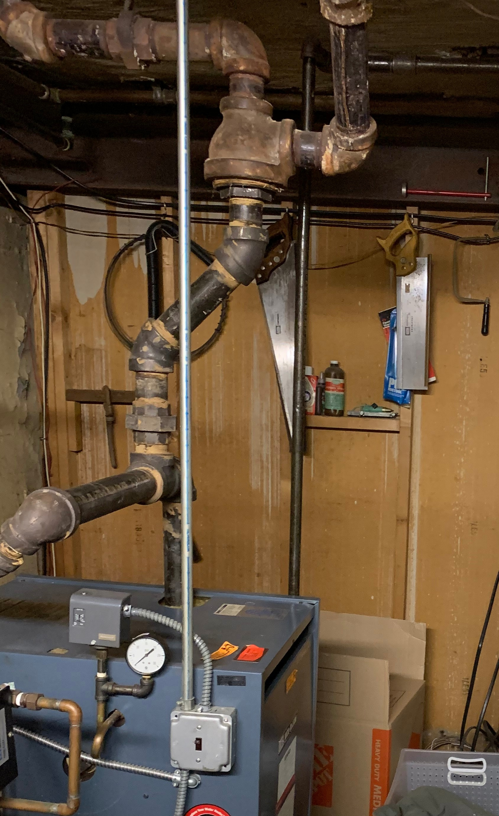

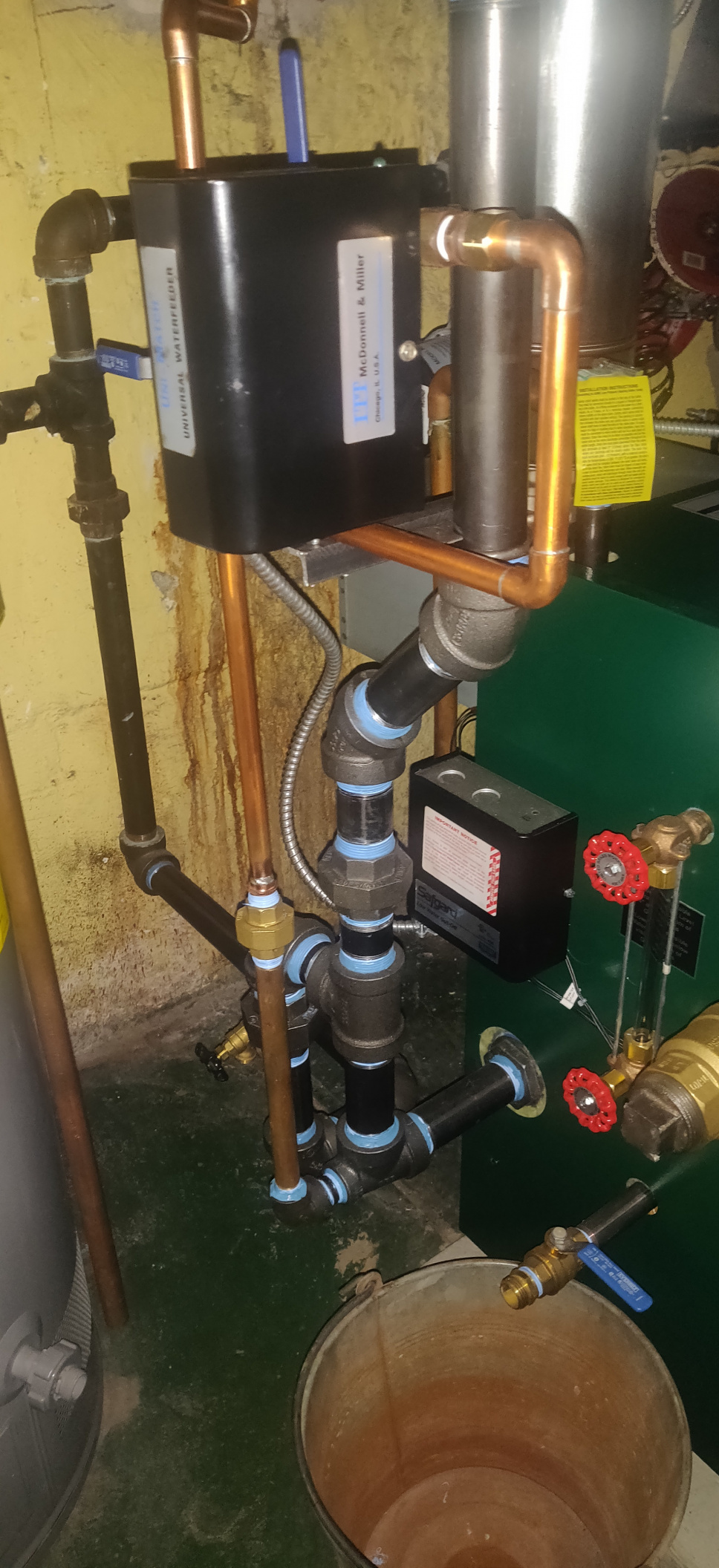

I have the chance to either leave this as is or make some changes I just removed a WM EG-45 and I'm replacing with a W GSA-125 after measuring the radiators, here are some pictures of my setup. I think I need to make some changes.
    EBEBRATT-Ed Member Posts: 20,166
    Just follow what the boiler mfg recommends. They want a 2 1/2" riser out of the boiler and a 2 1/2" header. The existing tee you have can remain as long as the inlet at the bottom is at least 2 1/2" if it is smaller than 2 1/2" change the bushing
    Or you can get rid of the tee and drop both supplies down into the header keep them the same size as they are with no reduction.
    Do not come out of the boiler tapping and go into the tee without making a proper header that will never work and be a big mistake.
    Just follow the mfg. instructions for the piping and the equalizer.
  • bagodemo
    bagodemo Member Posts: 5
    Ok so I'll remove that tee and call it a day
    Thank You.
    EdTheHeaterMan Member Posts: 12,165
    I don't like the looks of that tee. Leaving it there makes is look like an amateur didn't know what they were doing. Even if it works, it still looks bad, and your name is on that thing for many years. Something like this would look much better. And it will work great too.

    I will be pouring a concrete pad today because the floor is not level and when I removed the pipes the boiler was rocking a bit. After that I will start piping.

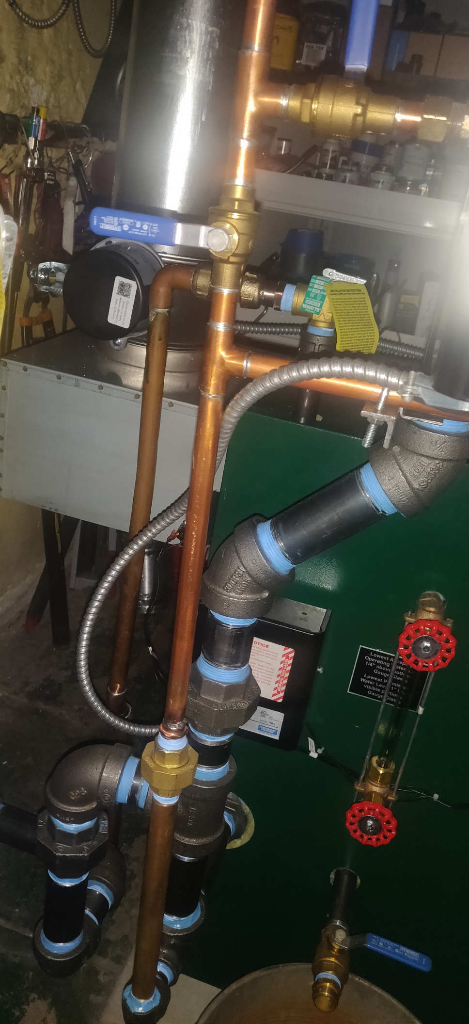

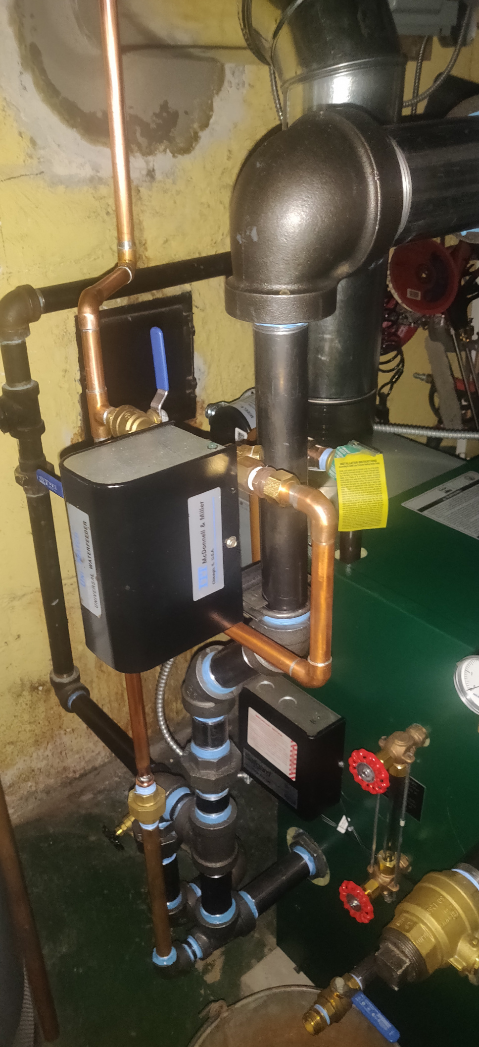

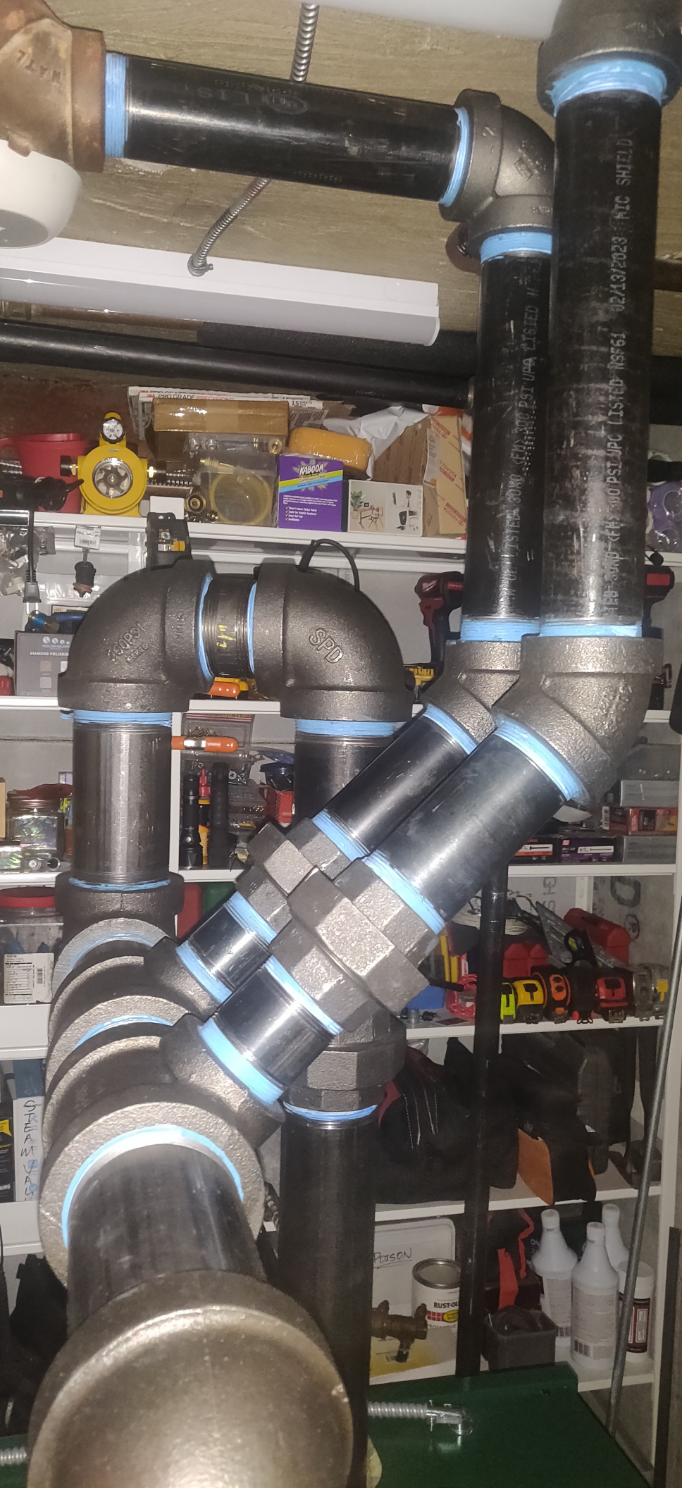

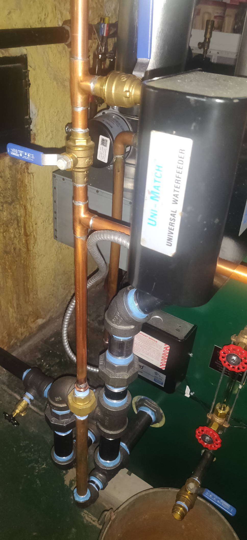

    I finished the install but won't be filling it up until the fall I think it's gonna be fine see pics.
    delcrossvAlan (California Radiant) Forbes
  • Mad Dog_2
    Mad Dog_2 Member Posts: 8,546
    Extremely neat...Nice solder joints...Mad Dog 🐕
