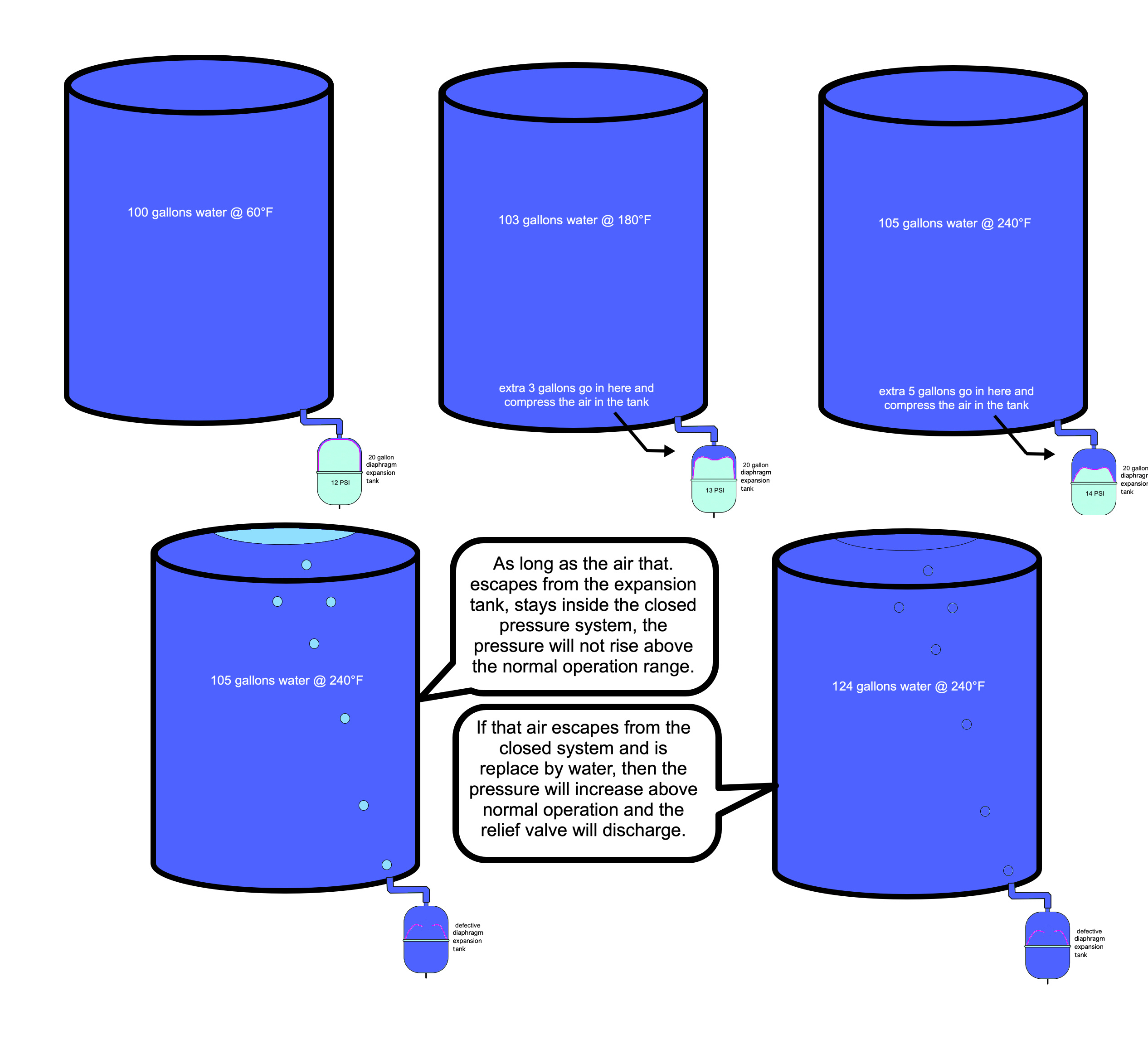

    To give a example of how water expands, if you have 100 gallons of 60° water, and you heat that water to 240° you will have 105 gallons of water.
    • But water boils at 212°F. How can you have 240° water?
    • Water boils at 212°F at sea level where the pressure on that water from the atmosphere is about 14.7 PSI absolute. If that pressure is increased (like inside a closed tank or closed heating system) then the water boils at a higher temperature. At a pressure of 12 PSI gauge or 29.7 PSI absolute water will not boil until it reaches over 247°F.
    Back to the 100 gallons of water 60° water and that same water is 105 gallons at 240°. The expansipn than is a place for that extra water to go when the water heats up and cools down, in a closed system. in this drawinf you can see that the location of the air cushion does not matter, it just needs to be inside the closed system somewhere. as shown in the lower left illustration.
    The problem arises when the failed tank lets the air into the system and the air is vented to the atmosphere. When that air leaves, and the boiler water cools, the auto fill will replace that missing air with water that will not compress. When heated, pressure will increase past the relief valve setting, as shown in the lower right illustration.
    Zoom in to see the expansion tank details.
