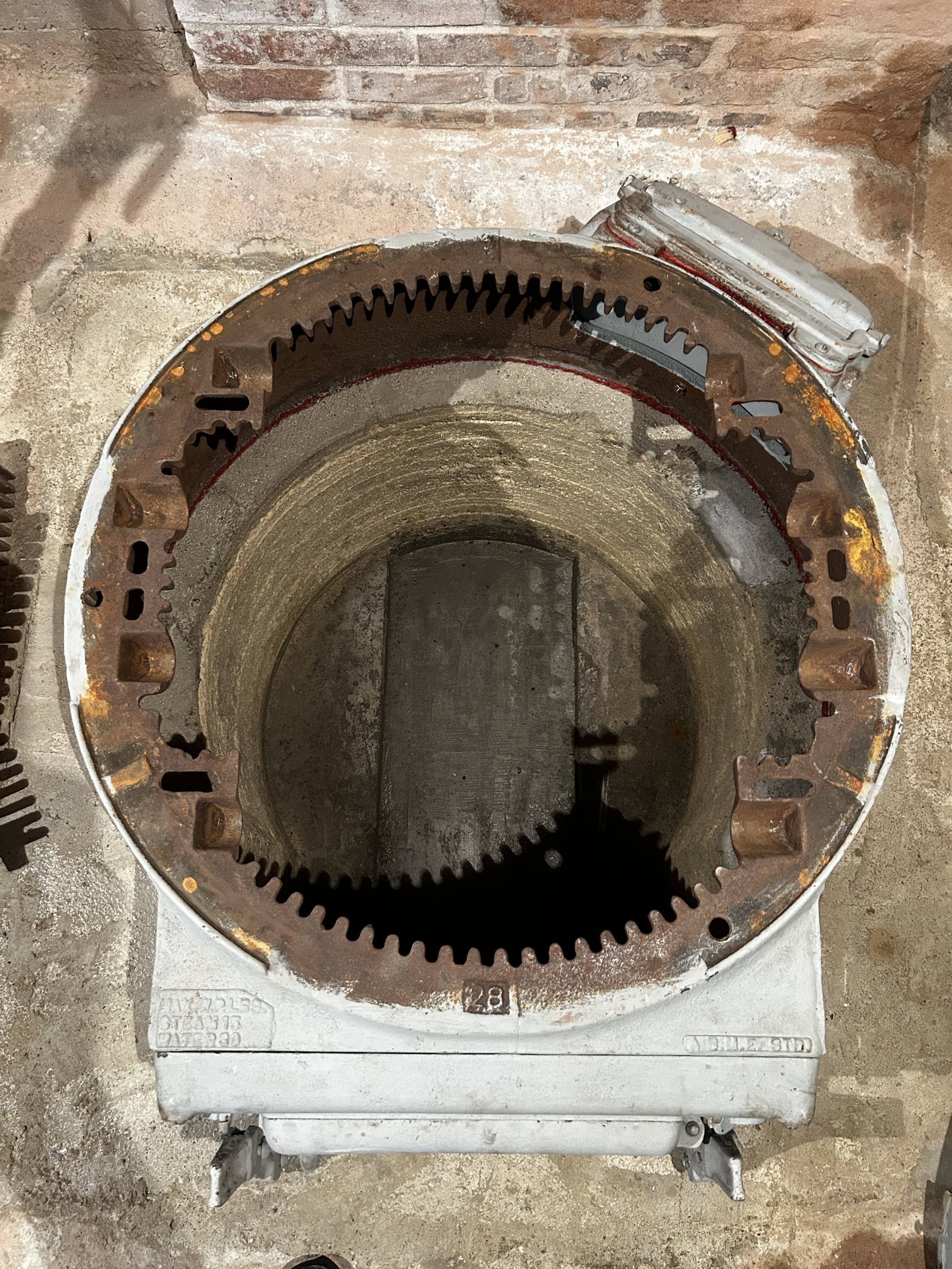

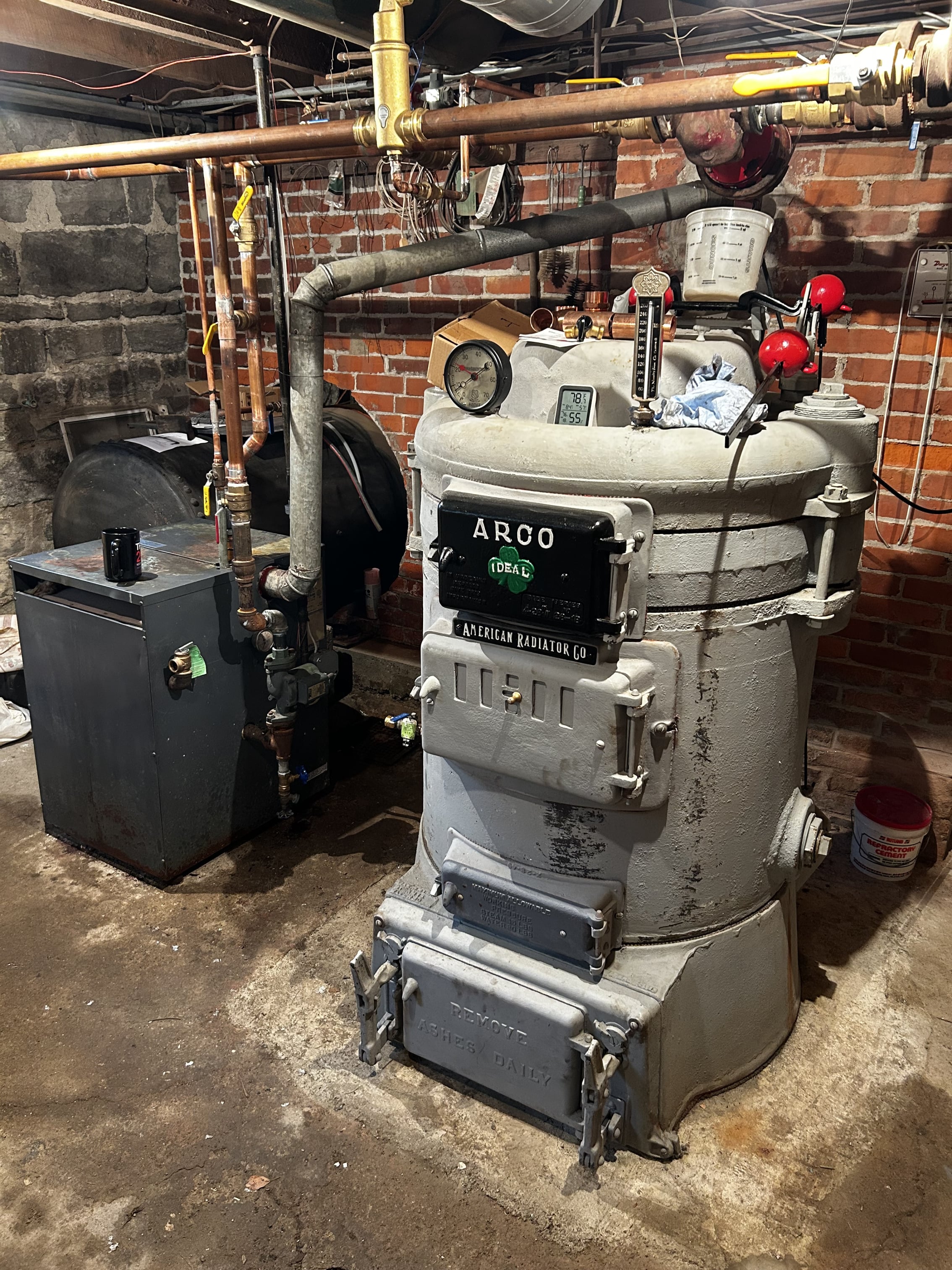

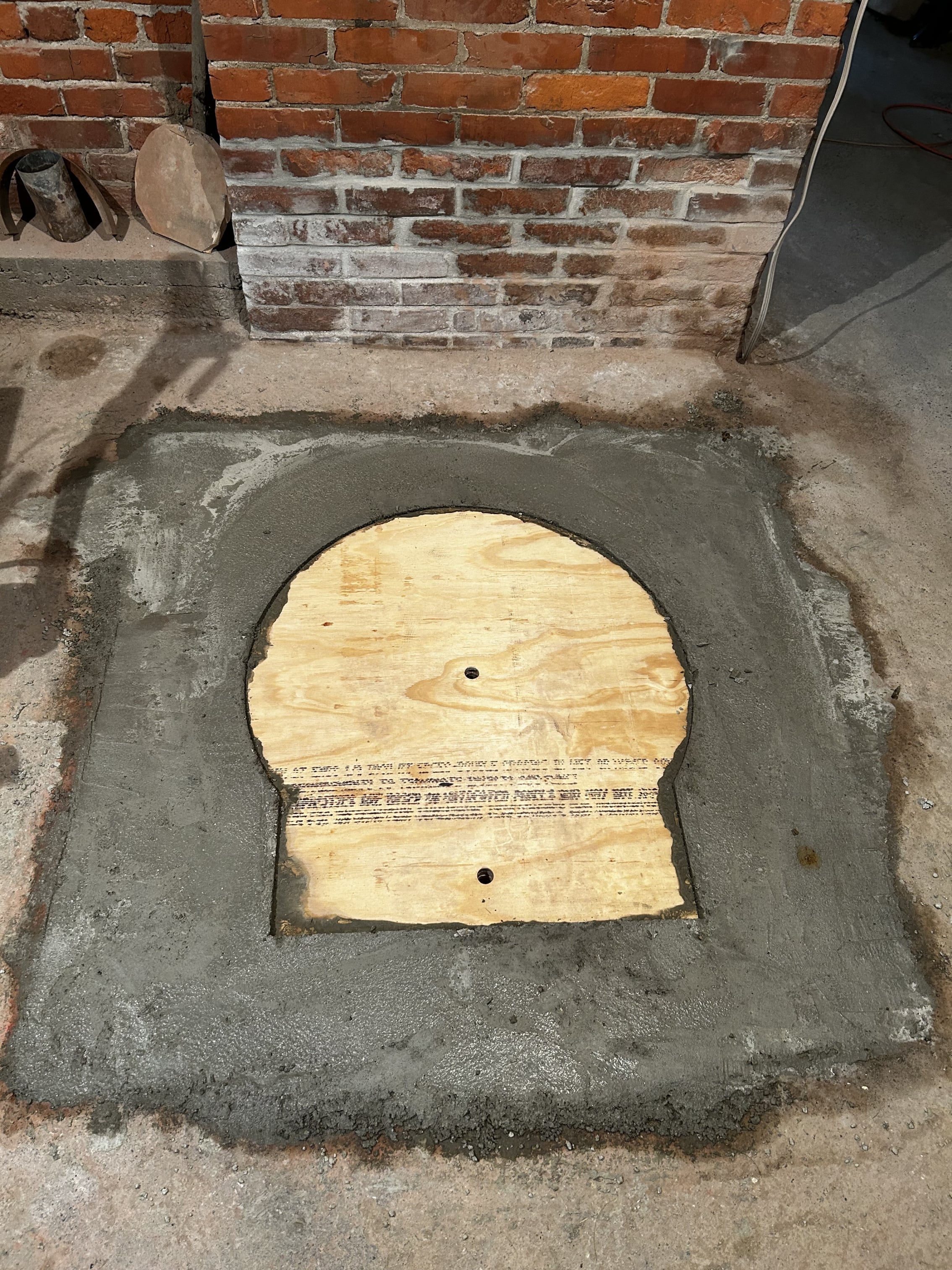

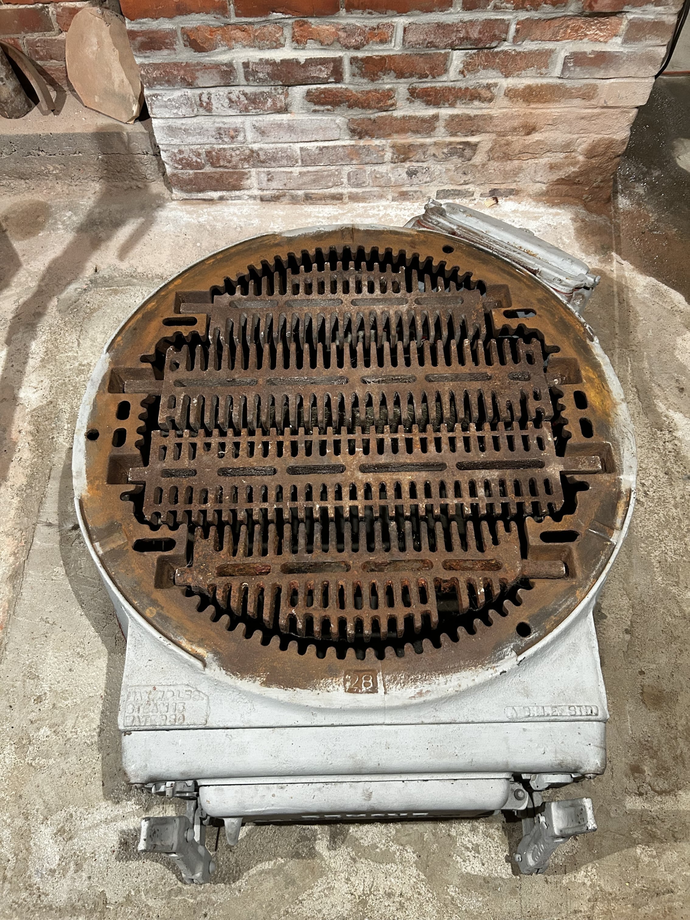

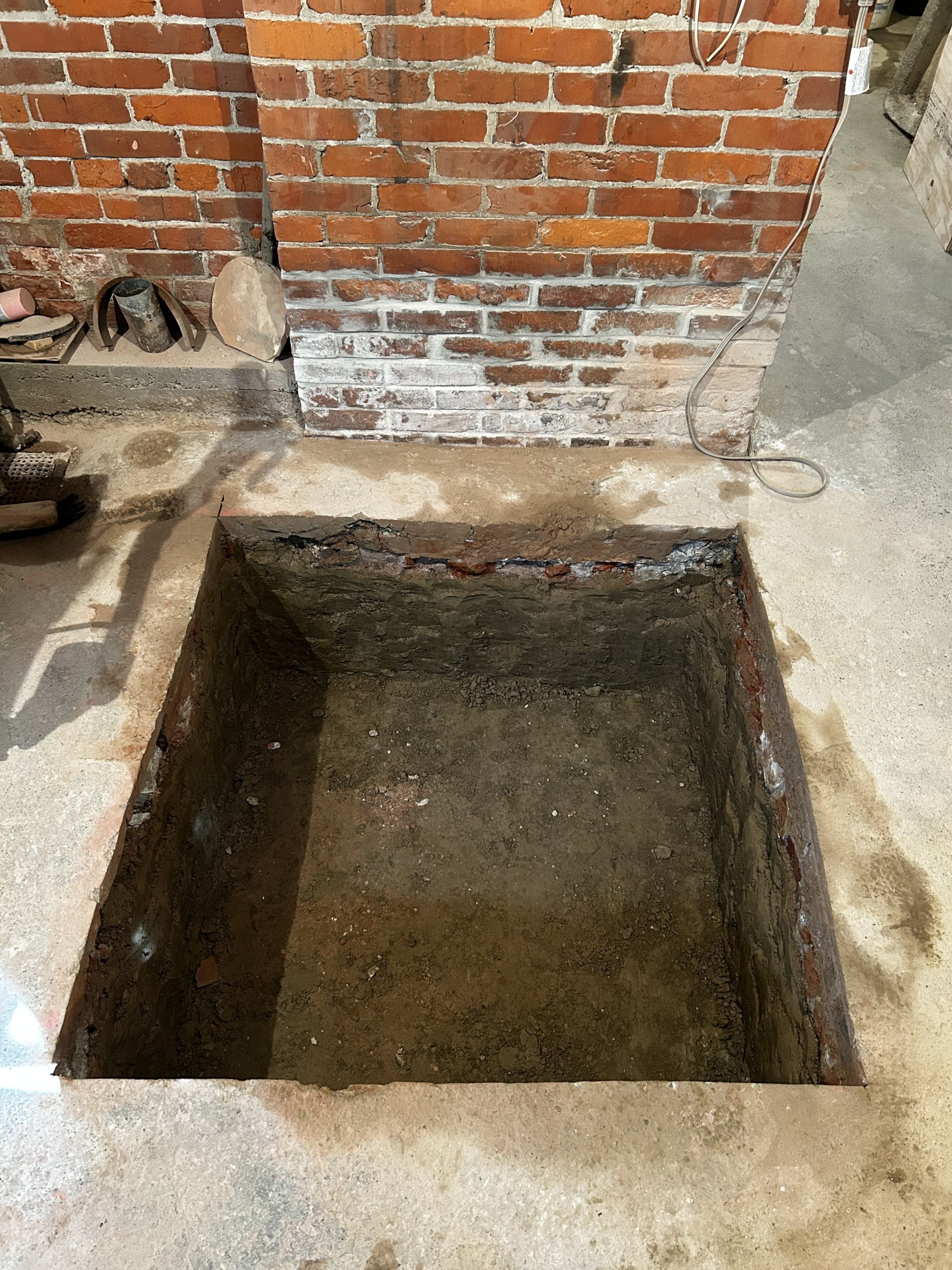

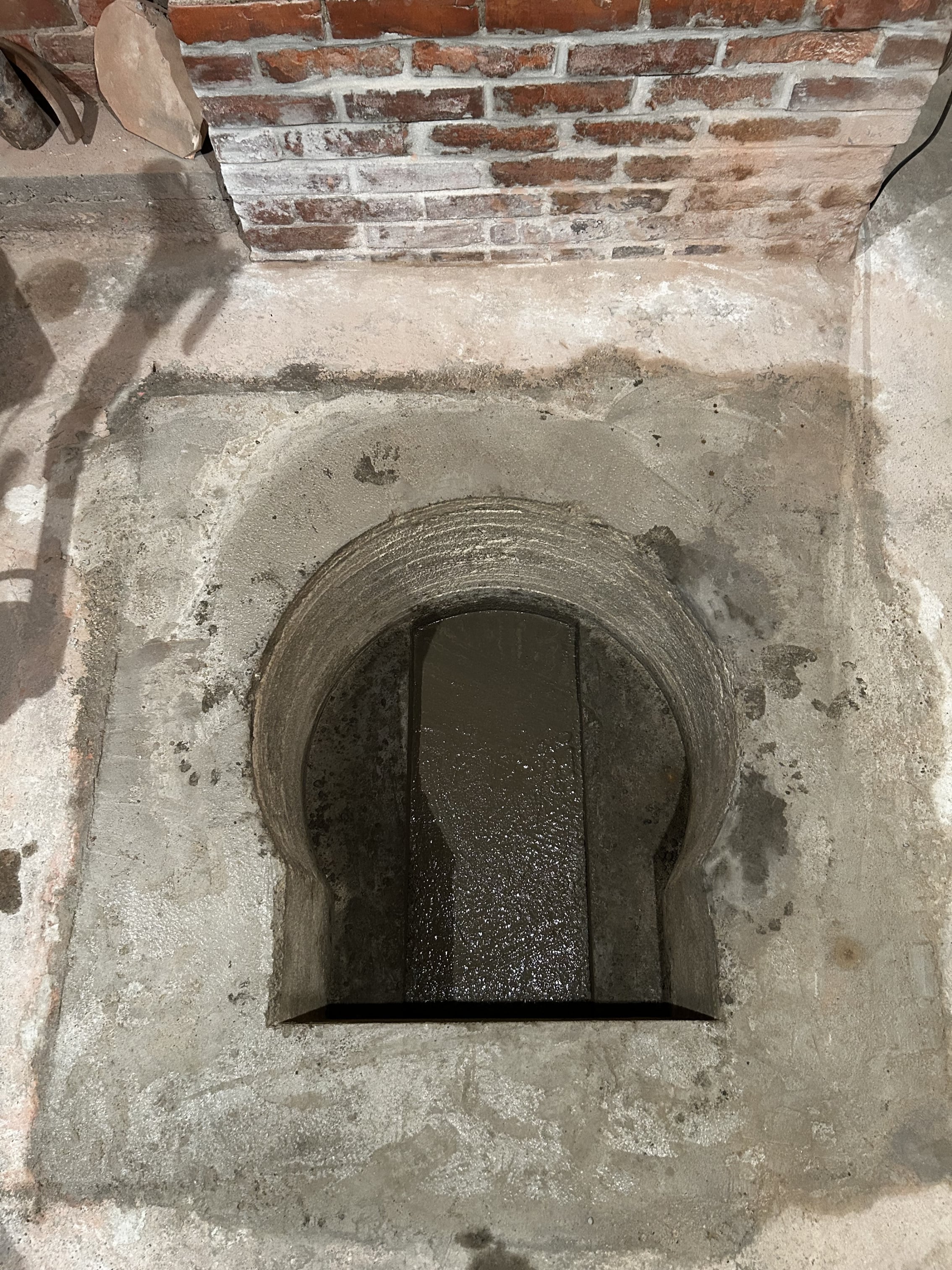

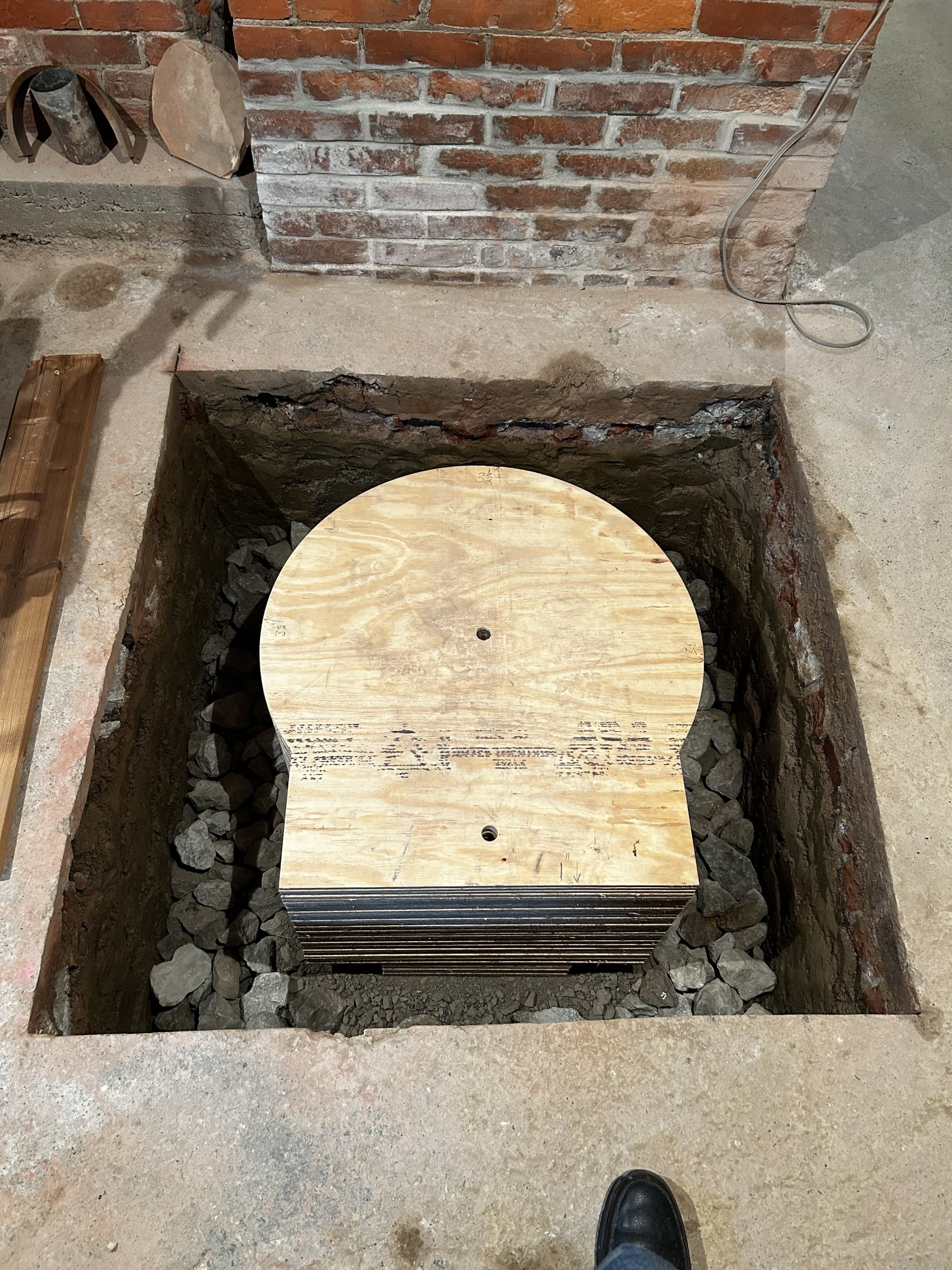

    After 2 years of working on restoring this boiler I am getting ready to install. I’ve worked on the chimney making sure it's sound and tight with no leaks and have just finished the new ash pit excavation. More to come as I continue to put this back together.

    EBEBRATT-Ed Posts: 21,328
    Is that wood in the bottom of the hole?
  • No. It’s a concrete formed shovel trench about 2” deep, 14” wide to accommodate by 9” shovel.
  • Finished the installation, setup and hook up. May never use but I like the look.

    lowercanada, that beast weighed 1,480 pounds dry. I poured high strength structural concrete under it to handle at least 2,000.
