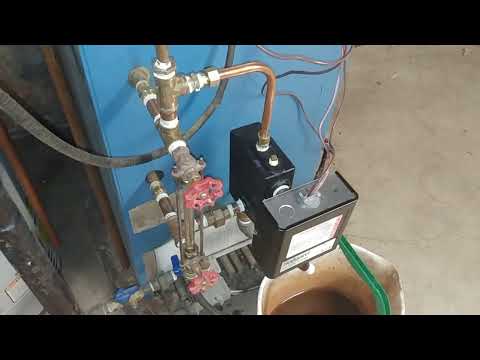

I have a Utica SFH3100S Starfire steam boiler. It currently has a McDonnell & Miller 67 float style LWCO.
As far as I can tell, the boiler doesn't have any tappings for a probe style LWCO. Can I retrofit a probe style cut off by assembling some nipples like this and putting in the place of the mechanical LWCO?

    Yes, you. But why? If I were doing it, though, I'd provide valves so that I could flush that gauge pipe regularly, and I would make it a point to test that probe type LWCO regularly as well -- perhaps not as often as flushing it -- by actually lowering the water level from time to time to make sure it was clear and working (not just press the test button and hope).

    That is 1 inch piping your looking at in the picture , your sight glass piping is 1/2 . I don’t think it would be a wise choice given that on most steam boilers the lwco probe is screwed directly into the boiler block so it is wet . In remote piping without flushing the chances of it becoming clogged and the probe still being wet is greatly increased and the chance of dry firing .Usually on a boiler equipped so a gauge column can be piped the choice of a low water cut off or a boiler feed pump control would be a float type using a probe type in a gauge column piping ill advised w possibly bad result . Unless the boiler has a tapping of a probe type low water cut off your sol .

    The piping in the picture probably does not meet the manufacturer's requirements. Hydrolevel makes a special fitting for using a probe in 1 inch piping. Hydrolevel also makes a direct replacement for the #67 that is a probe design,.
    delcrossvLong Beach Ed
    Steamhead Member Posts: 18,625
    The manifold to use is the 711C, part# 45-310, which comes with a set of quick hookup fittings:
    https://hydrolevel.com/manifold-fittings/
    You install the manifold on the sight glass and add the proper Safgard or CycleGard probe LWCO, and a 3/4" full-port ball valve in the bottom for the blowdown. Yes, you still have to blow this down, but it has no moving parts like the 67 does. We've used this setup quite a few times and it works well.
    Hydrolevel also makes a two-probe version for jobs where you need more differential:
    https://hydrolevel.com/safeguard-711-724-series-steam/

    Thanks for the info, all. I’m going to grab a needle valve and a 0-30psi gauge to place before that low pressure gauge. I want to replace the current LWCO because I would like to install an autofeeder and read that you really want to make sure your LWCOs are working well if you are going to use one. I thought a probe style would be more dependable. I was hoping to do away with the weekly blow down, but it sounds like that isn’t possible with 1/2” pipe.

    Gordon Schweizer did this for someone:
    https://www.youtube.com/watch?v=JBZO_1vigNg
    Yup, that's one of ours.

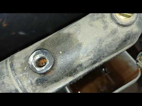

    A M&M 67 with a VXT auto feeder.
    Steam Boiler Start-Up: Freeing A McDonald & Miller #67 LWCO Stuck Float
    https://youtu.be/QdpcdP4Utp4
