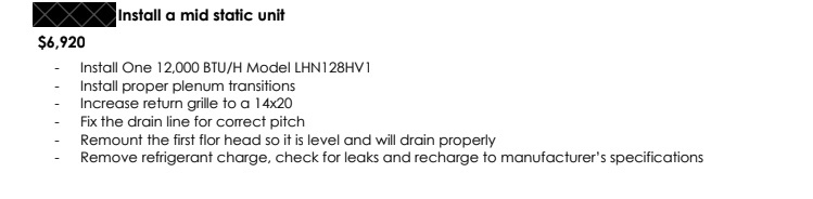

    I asked the company to cover the cost to have other contractors fix the installation; $10,000. They asked for info on what needed to be addressed so I sent them the below email. And then I sent them a second one I'll post into the next comment.
    Hello,
    The required repairs/changes/corrections include:
    Install a mid-static unit in attic (replace the low-static unit)
    Install proper plenum transitions
    Increase return grille size
    Fix drain line
    Remount 1st floor head so it is level
    Install wired remote thermostat for 1st floor handler
    Repair/restore attic damming and insulation
    Amongst other things.
    I have consulted with multiple professional sources about this low-static unit and the high static pressure of the system. The unit and ductwork need to be changed to have an air handler unit in the attic that is operating within its design parameters.
    “External static pressure is the measure of resistance in the ductwork. The maximum external static pressure is set to help make sure that you are delivering enough conditioned air to rooms served by your ducted system. This helps both with comfort and the proper function of the equipment and contributes to the system’s energy efficiency. If the external static pressure exceeds the maximum, that means you are introducing more resistance into the system than the heat pump is prepared to handle. This will make the heat pump need to work harder…”
    The external static pressure of the ducted system is above the unit’s “Maximum External Static Pressure”.  Therefore it is not operating within its design parameters. The external static pressure is too high for the ducted unit. The compact-ducted unit is operating outside of design parameters--with consequences for energy efficiency and equipment performance.

    I have attached the estimates for the work to be done.
    In my last email, I talked about the external static pressure issues. In this email I am including some details on the first floor unit and remedies required.
    We are not contesting that the sizing of the unit is adequate for the size of the first floor. And we agreed to accept a level of temperature unevenness on the first floor.
    What we did not agree to accept is a wall unit that constantly short-cycles and is unable to heat even the room it is located in. That possibility was never discussed with us as a risk.
    I know now that the thermistor on the wall unit is on the upper right hand corner of the handler. Which is tucked into the corner of the room. Prior to the installation I had no idea about where the thermistor would be and how it would impact the performance.
    We are still willing to live with uneven heat distribution, which is why we are pursuing the option of running a wired remote thermistor to a more central location.
    Like I said, the problem is not that the kitchen area or the area by the front door was uncomfortably cold. It was explained to us that those areas might be a few degrees cooler (I should say, that even if that were the case, to expect an extreme difference of 5+, 10+ degrees was certainly not communicated to us. Up to 5 degrees difference at most. More like 2 or 3 degrees difference. In any case, that is not the actual problem at this point.).
    The problem is twofold.
    One (1) problem is that during milder temperatures, the unit will repeatedly turn on and very quickly turn off before turning on again (short-cycle).
    A second (2) problem is that the room where the air handler is located was not able to stay warm when it got cold outside (around 32 degrees and lower). This is even when we set the unit to its highest set point of 86 degrees to avoid the short-cycling that occurs when set to a more reasonable target temperature (If we made the set point a more reasonable mid 70’s degrees, the short cycling issue would come into play).
    Installing a remote thermistor would move the temperature reading out of the corner and into the center of the house, where it can assist the air handler in not immediately reaching its set point when it begins pushing air.
    The second required part of the puzzle is to remove refrigerant charge, check for leaks and recharge to manufacturer’s specifications. There is every reason to justify taking this action. One justification is how many things were done wrong by the original installation team. In addition to the outstanding issues, the original team:
    -left a leak in the return refrigerant line coming out of the wall unit
    -installed a too-small-diameter of a return duct
    -installed drastically under-stretched and overly-long ducts
    Like I said, this is in addition to the outstanding issues.
    It is extremely warranted, as proposed in the estimate we received, to remove the refrigerant charge, check for leaks and recharge to manufacturer’s specifications. Warranted by:
    (1) Some of the extremely obvious stuff that Endless Energy has identified (like how the attic drain line does not have enough pitch), and the other issues listed above, demonstrates an error-ridden (including very basic errors) original installation. This leaves no reason to have confidence in their refrigerant work, and every reason to doubt it;
    (2) An already identified known leak;
    (3) The existing performance issues and inability to keep the room warm.
    Thank you,
    P.S. Attached Estimates do not include verbal estimate of additional $300 for HVAC to purchase and program 1st floor remote thermostat.
