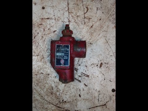

My gas boiler for heating my home pressure has been spiking causing my relief valve to release pressure. I tried to drain my old style steel bladderless expansion tank by 1.) isolate the tank using a shutoff valve 2.) loosen the nipple on the bottom of the airtrol tank fitting 3.) let the water drain out until it stops. So to me it seemed like I drained it but this morning pressure was back up and relief valve popped off, draining ~2 gallons of water.
Now everything I am reading online has a separate drain valve that has a hose bib and a pin to allow air inside if loosened, so those steps go shutoff valve, attach hose to drain valve, and open the drain and air inlet. I however do not have the fitting for a hose or any other way to drain water out.
The boiler is setup up as so. Hot water outgoing - > branches off from outgoing to a smaller pipe leading to expansion tank - >shutoff valve - > airtrol tank fitting - > tank.
I guess my question is when the water stopped draining did the remainder not come out because the tank was now at 0 psi causing no more to get pushed out? Will I need to try and insert a small tube and create a siphon effect into the small opening at the bottom of the airtrol vavle?
    Yes, once the air pressure in the tank goes to zero (actually it goes a little negative) the suction will prevent more water from draining out. But I just installed an Airtrol in my expansion tank, and I don't think you can "insert a small tube to create a siphon effect." If you completely remove the bleed screw, all that's above it is the very small diameter air bleed tube that sticks up inside the tank (see below).
    Also, when you use the Airtrol bleed screw to drain water, you can only get the water level down to about half the height of the tank, because the Airtrol fitting has an air bleed tube that sticks up into the tank about halfway, and the water is draining out through that air bleed tube. Once the water level reaches the top of the bleed tube, no more water will come out.

    Take out the bigger plug that the drain screws into. The vent tube should come out with the bigger plug. The vent tube may be sludged up.

    @jesmed1 that's what I thought. Looking at diagrams of how the airtrol fitting work it doesn't seem I could siphon out water just like you said. So now I need to find a way to drain the raminder if the water below that tube. There is a cap on the bottom of the tank but it just does not budge. Was it be past practice to jb weld the plug into the tank so it could never be removed again or am I just too weak to break it open lol

    Read what @WMno57 wrote above. Try to remove the larger fitting.

    So I just read an article about NOT having auto air bleeders on a system using a bladerless tank. I DO have one of those on a high point of the boiler a little before the return. Is this the cause of my issue?
    Yes. You do NOT want to bleed air out of the system at the radiators. You want the Airtrol funnelling the air back to the tank. Your auto bleeder will eventually bleed all the air out of the system and make the expansion tank get waterlogged, just like you now have.
    It's probably seized with very old pipe dope. Once you get the tank emptied, try to get that plug out with a good-sized wrench. It may help to heat the surrounding bung first with a propane torch. Then take the plug to Home Depot and get yourself a standard hose bib faucet with a 1/2" male pipe thread, and a brass adapter that will allow the faucet to screw into the tank. On my tank, the adapter accepts the 1/2" pipe thread of the faucet and goes into the 3/4" pipe thread bung of the tank. Match your adapter size to the plug that you took out of the tank.
    Also, pick up a 1-ounce tube of Megaloc pipe thread sealant and use it when reassembling so your joints don't leak. Then reassemble everything and refill the tank per the Airtrol instructions:

    Thank you again to every single one of you! I did manage to drain the tank fully thanks to the advice of @WMno57 and I did manage to open the cap and added a hose fitting for future drains! Got all sealed up with no leaks!
