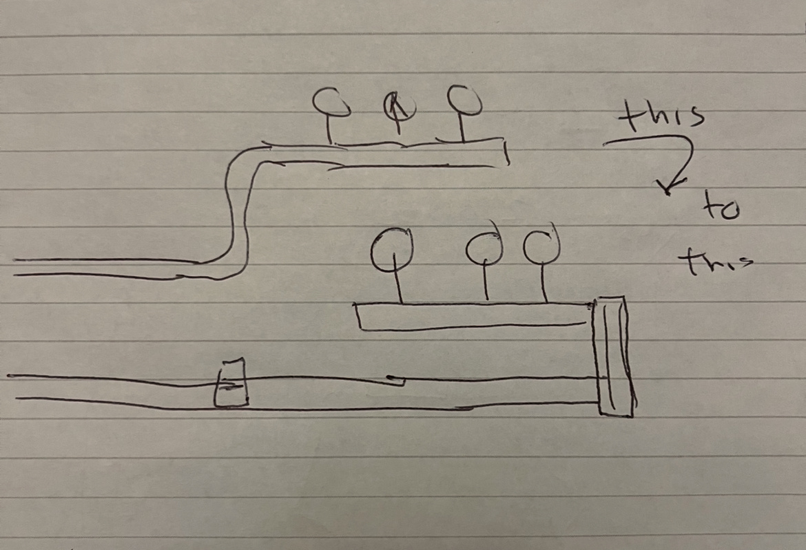

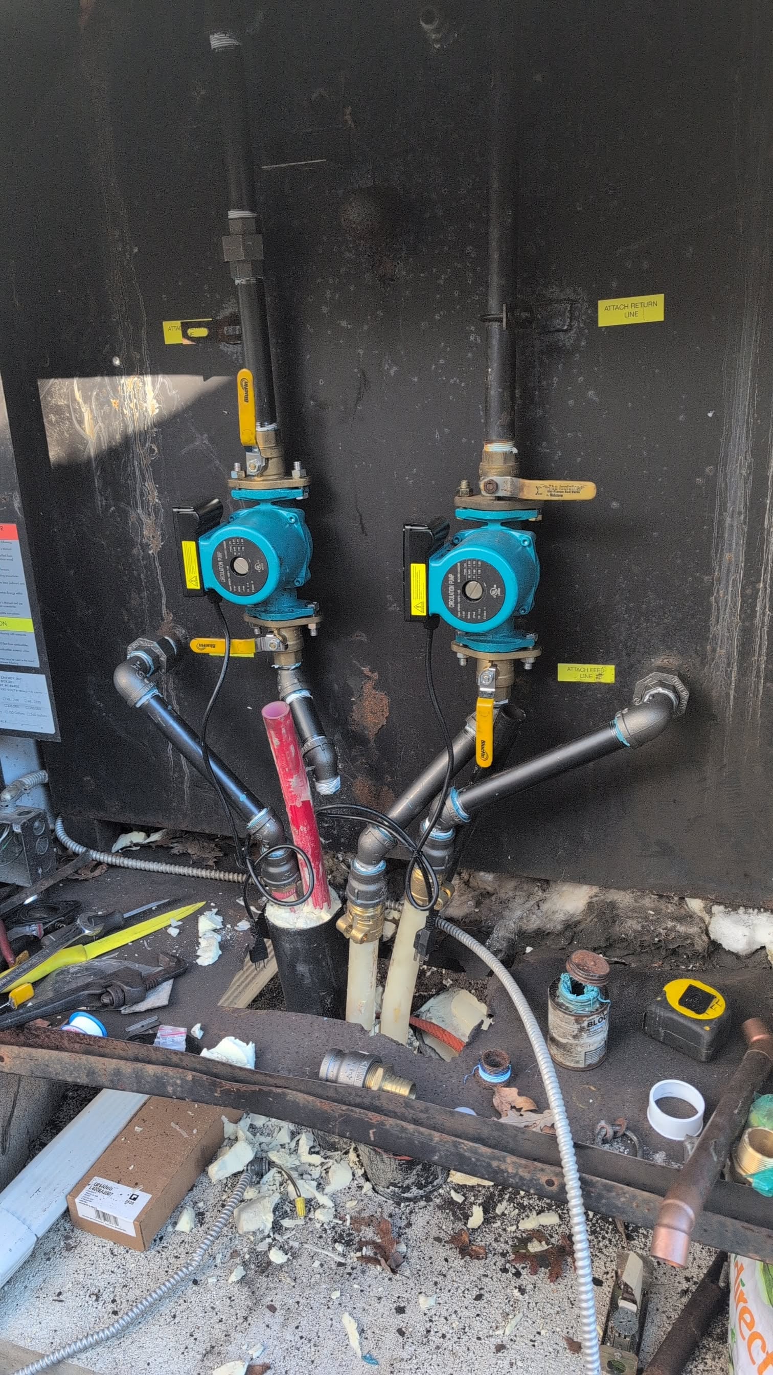

    Your drawing showed 4 connections on the wood boiler. So you have two different independent systems
    sounds like the boiler us large enough to handle both buildings at the same time?
    do each building has its own piping Hx a
    and controls

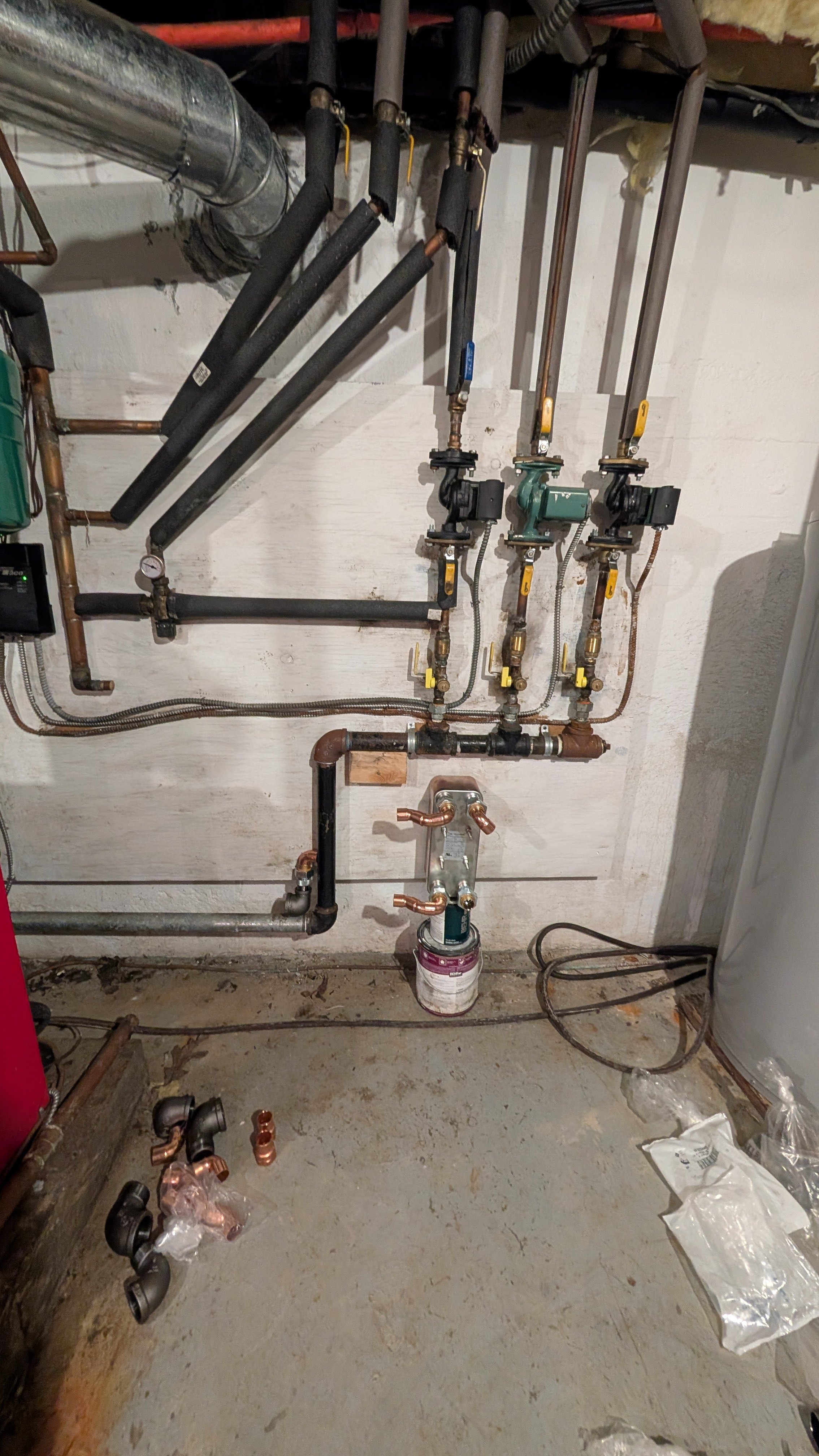

    The pic if the manifold with pumos I assume is in the house? In a basement?
    Yes the manifold with the oil boiler is in the house in the basement.
    Sorry I got confused by your drawing of what is what.
     What do you mean by "do each building has its own piping Hx a
    and controls"
  • Kkane97
    Kkane97 Member Posts: 85
    Nothing is piped yet for the OWB, I have it set in its location and am trying to draw out my plan for running the piping. Either as groundup simply with two pumps, one HX in the basement for the oil boiler and WtA heaters in the shop, or as hot_rod with hx in basement and shop.
    I understand there's a lot of ways to skin an apple, cost out of the equation as far as system setup, I am confused as far as which method of hooking the system up would best fit what I want to do.

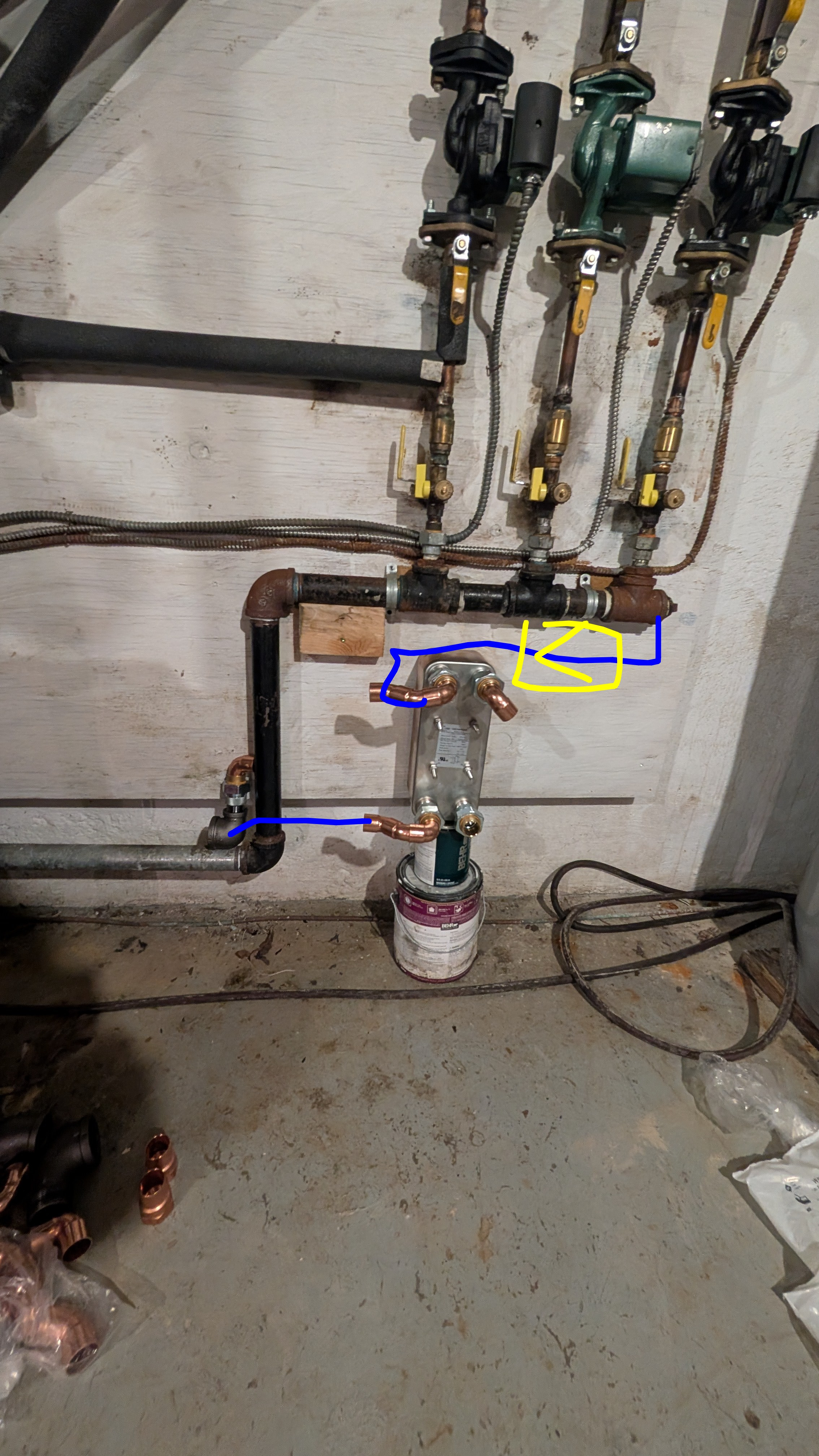

    this is my keep it simple plan, what would you change? what size should the circulator pump be for the heat exchanger? is it better to flow more water through the HX or less so heat can transfer longer?
    if I use a variable speed pump to slow the flow down but maintain flow through the hX when the oil is up to temp i could use a pump like a 007-VSF5 or is there a simpler cheaper pump that could do the same thing? externally control a ecm pump?
    @hot_rod is there still a benefit for having copper tube off the HX for a section before pex?

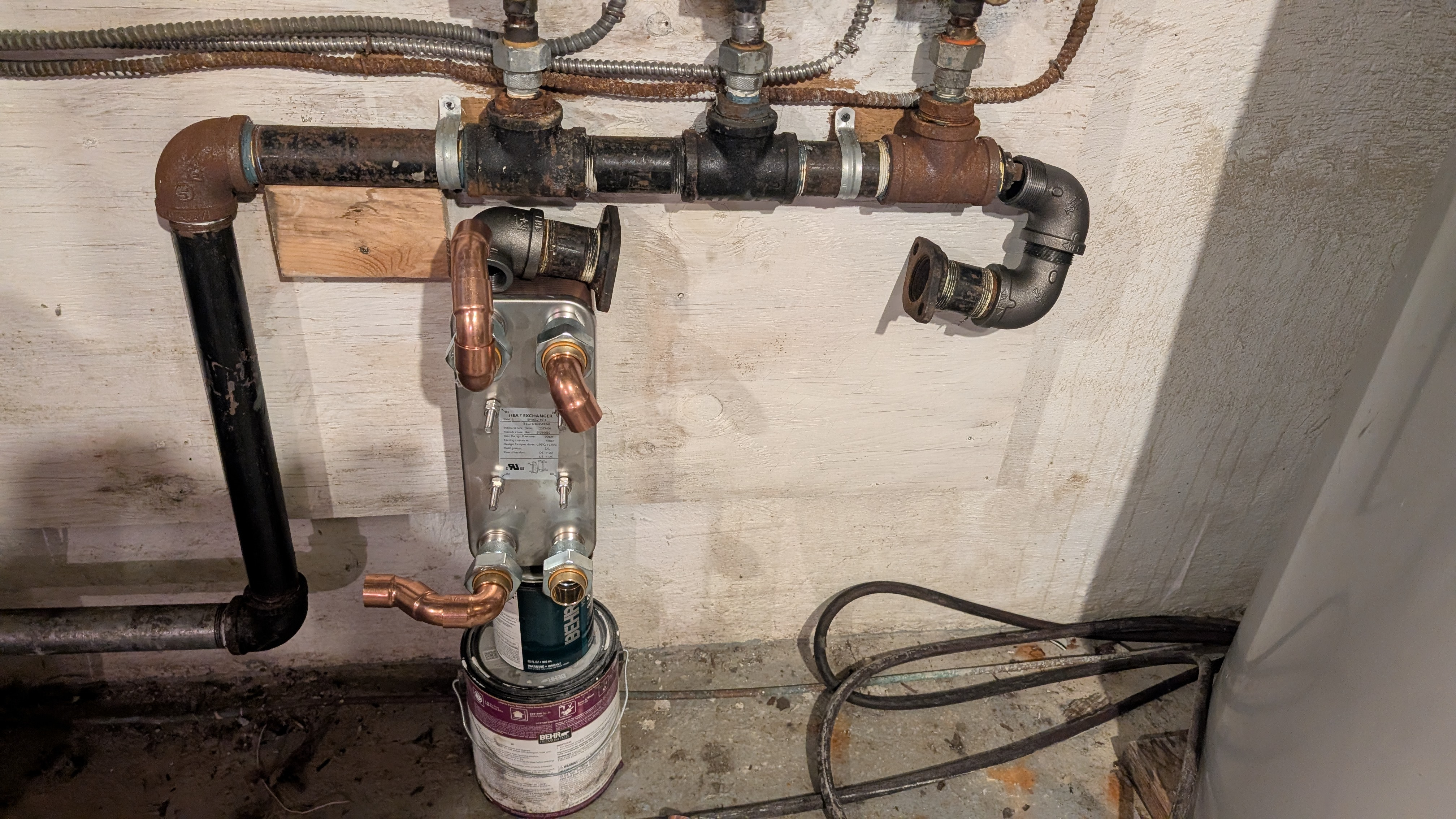

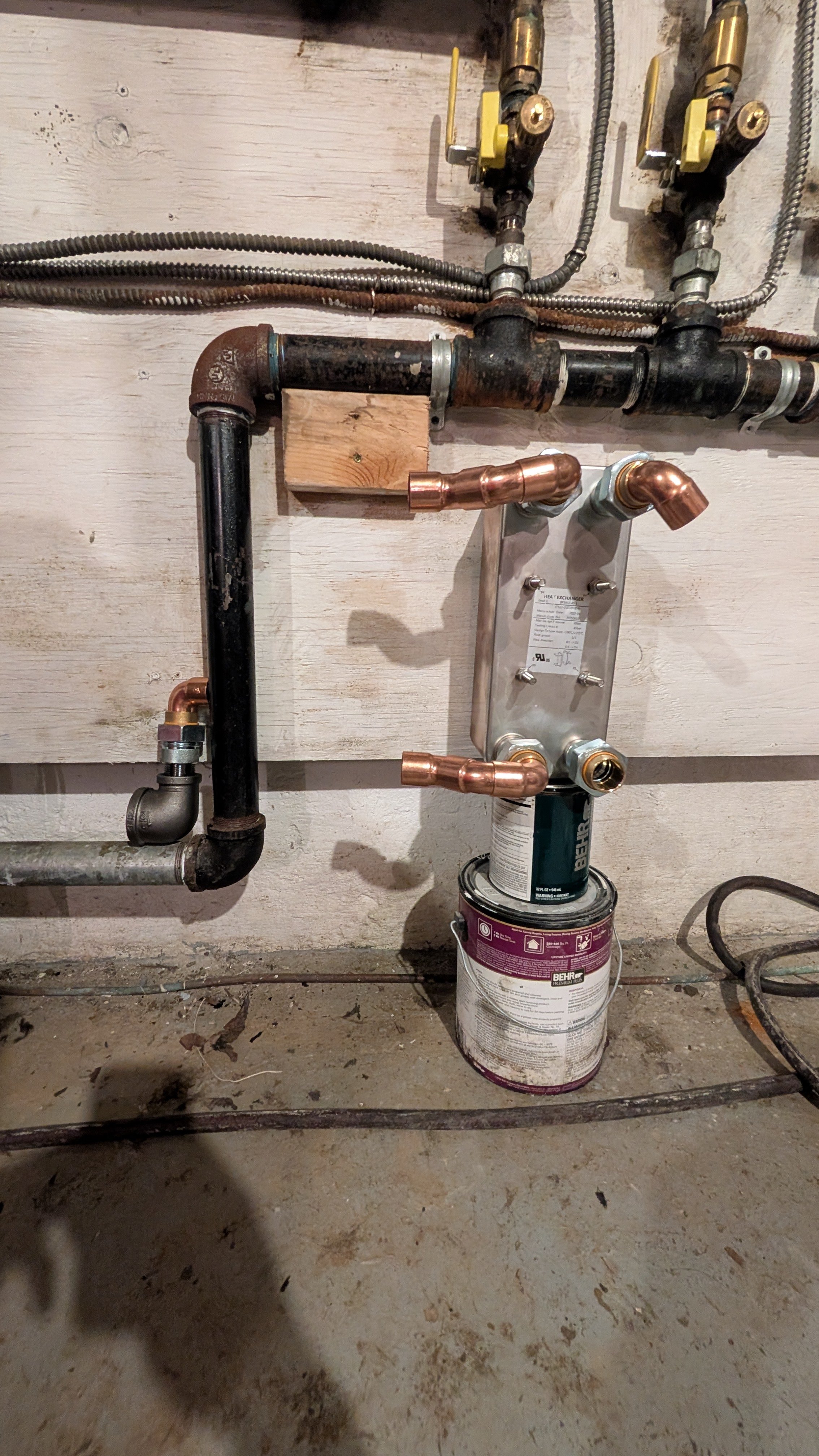

    Where could I find a example of a three way to maintain a low own temp for backfeed? If I were to add that in. Would that be a three way with a sort of flow control  to limit the returned water to the owb when not in use?
    I do not know the brand of underground that I got, but it is much nicer insulated looking to me than the thermopex I have seen, 1" pex lines
  • GroundUp
    GroundUp Member Posts: 2,508
    I don't know how to post links, but something like a Taco Sentry (Z100T3-2) on the pressurized side of the HX would allow the flow to be diverted around the HX depending on what the OWB temp is. If you were to employ a controller such as a Ranco ETC-112000-000 with the probe on the OWB supply line on the other side of the HX and set it to, say 45 degrees with a 5 degree differential, it could open and close that 3 way based on the OWB loop temp. Being the OWB loop is constantly circulating, there would be a constant reading on that supply line at the HX. When it falls below 40 degrees, the valve would open and allow flow from the oil boiler to backfeed the plate until the OWB reaches 45 degrees then revert back to closed. Then the OWB would always remain 40-45 degrees when not in use, minimizing your oil usage for backfeed. This would need to be manually switched, however, during times of OWB inactivity. Otherwise the hot OWB would never feed the indoor system as the bypass would always be open. Those lines are Rehau Insulpex, which are high quality.

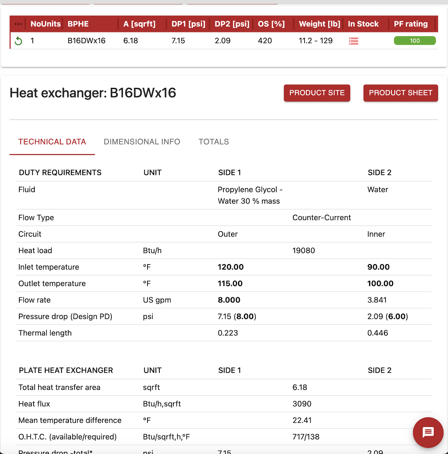

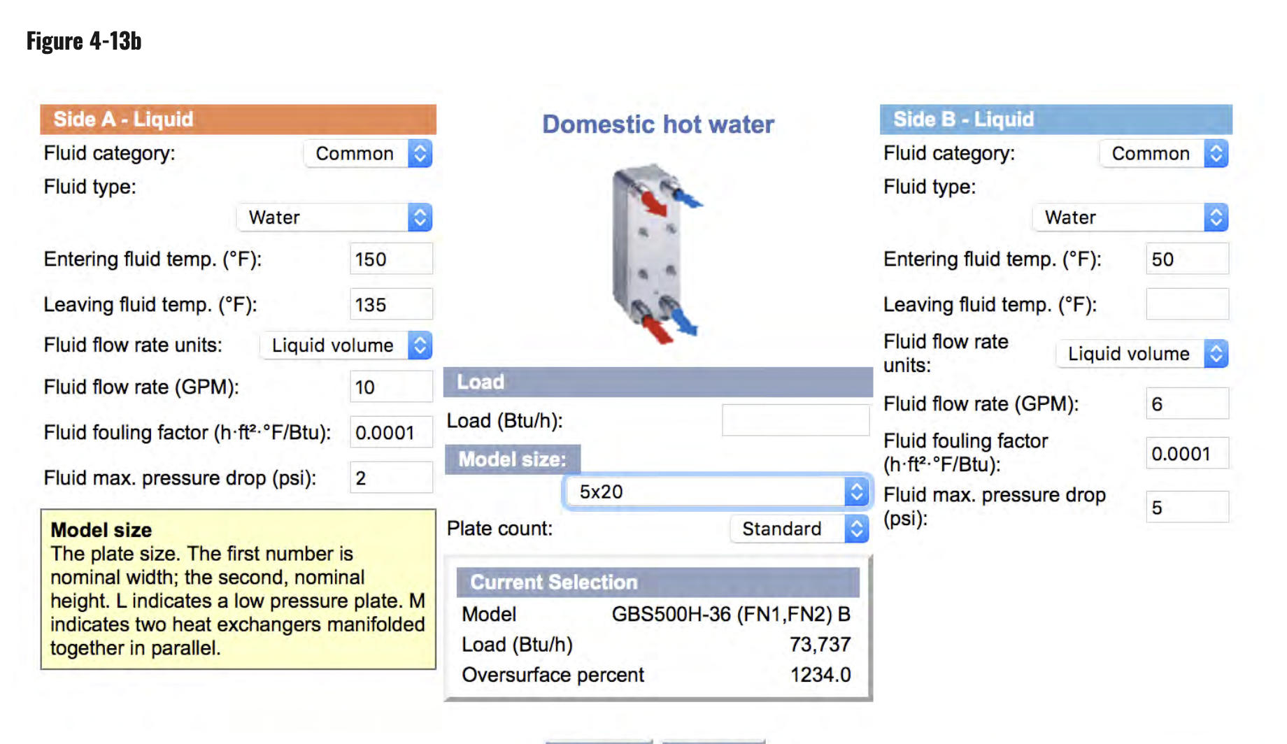

    I was looking into that controller for a different idea, using a small plate exchanger to heat my hottub, 120v pump that does not use a heating element just heats through the increase in temp of water flow, and controlling that circ with a temperature probe on the boiler side of that HX
    This is how my system looks as of now, i know my pictures arent as a schematic uses symbols but it makes it easier for me to see what I want to do
    I am concerned that running both the radiant zone and hottub zone for times soley will cause my return temps to be to low as far as condensate issues. so I was considering using a taco vt2218 pump with temperature probes as my boiler protection/ circ pump if i was to maintain boiler core temp from the outdoor unit.
    I have added the three way bypass on the Boiler side of the HX because I was thinking it would be much simpler to plumb that change in and would still allow flow continuously to the OWB

    hot_rod Member Posts: 27,332
    Hot supply into the H of the mix valve
    Return goes to C port and back to system
    Pump goes on mix port
    Some examples below
    A temperature controlled circ will only give you boiler protection if it can hydraulically disconnect the load
    If supply from  a cold load is say 80 degrees, and the boiler is starting from cold, the pump cannot increase the boiler temperature, regardless how fast it spins🤨
    piping below  shows better way to use a variable speed temperature control pump for protection

    Reviving my old thread as I am finally hooking this up, wanted to confirm opinions before I break my return line to add in the heat exchanger. It seems wrong that I am reducing my return flow from 1.5" to 1" going through a 60 plate heat exchanger. Attached are how I am planning on doing it. Bottom left of the return I have a fitting mocked up for reference connection from the 1.5 to 1". Outdoor boiler connection is done outside, just finishing the inside finally life got in the way last couple years and ready to see how much I hate burning wood
    Jamie Hall Member Posts: 27,242
    Minor (?) comment: at least around here, the building inspector and fire marshal would have a heart attack if they saw low voltage control wire in the same conduit as power wires…
    looks like you have a number of pipe size reductions? On the back of the boiler, then at the HX also. It all comes down to how many gpm you are trying to move through those circuits. The underground piping size and length is where the bottleneck tends to be on those OWF installs.
    Also, you need a circulator after a 3 way mix valve. Looks like you have a pump pushing down and into the 3 way.
    Kkane97
  • Kkane97
    Where do you see that? Mc cable ran from the taco board to the circs
  • Kkane97
    That makes sense, the OB side works well as is, I'm not positive on what each zone is trying to move gpm wise
  • Kkane97
    Being that it's not likely that the hx will flow enough for a major heat call, would it make Sense to put a circ pump and make the hx loop
    it’s good to have some numbers to build this around. If not you will get only what those small circs on the rear of the boiler can move through the piping and various devices. It may be a trial and error approach
    Earlier in the post someone mentioned maybe 8 gpm through this piping, with a high head circ. I don’t think those circs in the boiler are high head? Motors look too small. The fittings and HX should not be an issue if in fact you are moving 5-6 gpm or less.
