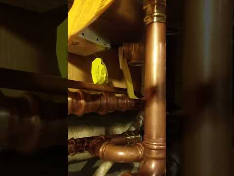

Hello,
Just had the new Lochinvar Noble NKC 150 combi unit installed last week in my 110 year old house. Hot water and heat come out good. But whenever I used the washing machine, an open pipe under the unit would emit water concurrantly with the water hammering in the pipe system. I had loud bangs in the pipe system whee using the washing machine before, but the old Rinnai combi never emit water with water hammering. Is this concerning with the new unit? Also, "Outdr Sensor Missing" is on the front window. Is that normal? Thank you for your thoughts.

    Video showed the water emitting with hammering: https://www.youtube.com/watch?v=A-xV7QKA7_U
  • That’s your pressure relief valve discharging water. It should have been piped to the outside of the house.

    That is the domestic water relief and has nothing to do with the heating side or exchanger. Also, who pipes a relief to the outdoors? This isn't steam.

    The outdoor sensor came with the boiler in a little white box. It doesn't need to be installed, but it will maximize efficiency if it is. The installer skipping that as well as a downpipe on the relief valve indicates they may have skipped some other steps as well, such as an expansion tank. Can you show us all the piping and boiler together? Is this city water or is it on a well?

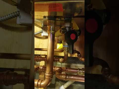

    City water or well water? I don't see an expansion tank on the domestic water side. Also, the circulator is mounted wrong.

    @BostonKGK When does that sound and leakage happen? When you're running a faucet?

    City water is used.
    The water only emitted when hammer happened. And hammer happened only when the washing machine is in use.
    So for now, I just placed a basin underneath to catch the water (about 2 oz) when the washer is running. Is this a good solution?
    Will the circulator mounting mistake cause problems?

    @BostonKGK the circulator mounting position will not affect the issue you're seeing here, but it should still be corrected. If you're on city water, there needs to be an expansion tank on your domestic water side. Maybe there is, but I didn't see it in your video. Can you verify? This behavior is typical of washing machines and many washer boxes use valves with integrated hammer arrestors for this reason. If you don't have an expansion tank, get one added ASAP. If you already do have one, perhaps a hammer arrestor on your washing machine circuit would be a good option. Regardless of what happens, that circulator should be rotated 90 degrees and the relief valve should be replaced as well as piped down toward the floor.

    Is the gray tank a domestic water expansion tank? Thanks.
  • GroundUp
    GroundUp Member Posts: 2,513
    I can't see how it's connected to the system, so I don't know for sure, but it appears to be a hydronic tank. There needs to be two separate tanks- one for the hydronic and one for the domestic.
