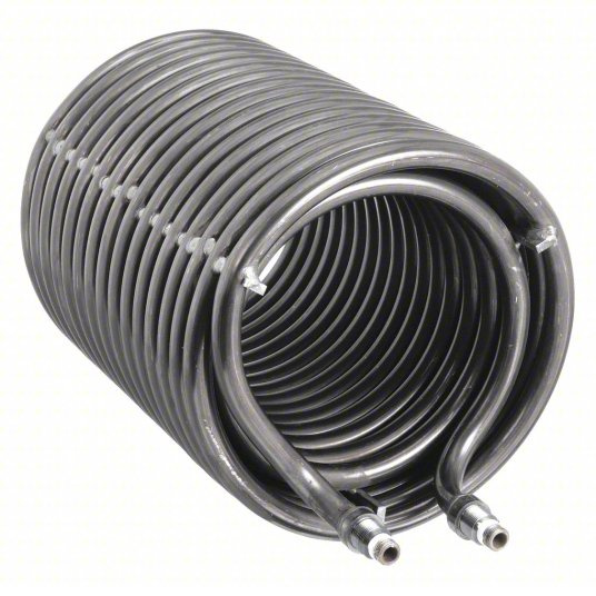

    The double coil hot water heat exchanger offered by W.W. Grainger that is a replacement for hot pressure washers may be an option for the spa folks to use if it can go in the pit and be submerged.
    Item number 25FX89
    It is a long circular steel coil with full length interior coil in its entire length giving you a great deal of heat exchange.
    It is $745.68 plus tax and as it is small in diameter you would be able to submerge it horizontally.
