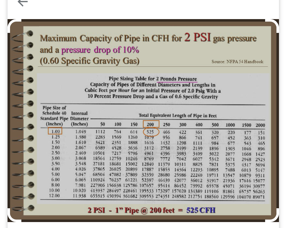

    generally you make a drawing like this with dimensions, then use the 2 psi table to size all the piping
    2 psi regulators at each connection can either be vented outside or have vent restrictors

    hot_rod Posts: 28,705
    I had to upgrade to 2 psi a year ago for my shop boiler addition. I had to get a city permit, re-test all the existing lines, the city contacted the gas provider to approve the upsize. I supplied all the 2 psi regs, one for furnace and hot water tank, one for the shop.
    So see what you gas provider is requiring and if a city inspection is required.
    Use the table I attached above, looks like 57' to the pool heater. 1" is plenty of pipe size at 2 psi for all those appliances
    The big if is the pressure test, and plan B if it doesn't hold the test? Disconnect all the current appliances, do the test before you make the 2 psi decision

    all is fine as long as the current piping can handle a pressure test. My AHJ wanted 30 psi for 1 hour, observed.
    Appliances will be fine when you add 2 psi to 11" regulators. I'm not sure how easy the fireplace will be to add a regulator, it needs to be outside the firebox somehow.
    The meter doesn't usually set the pressure, they usually change the current regulator at the meter to give you 2 psi.

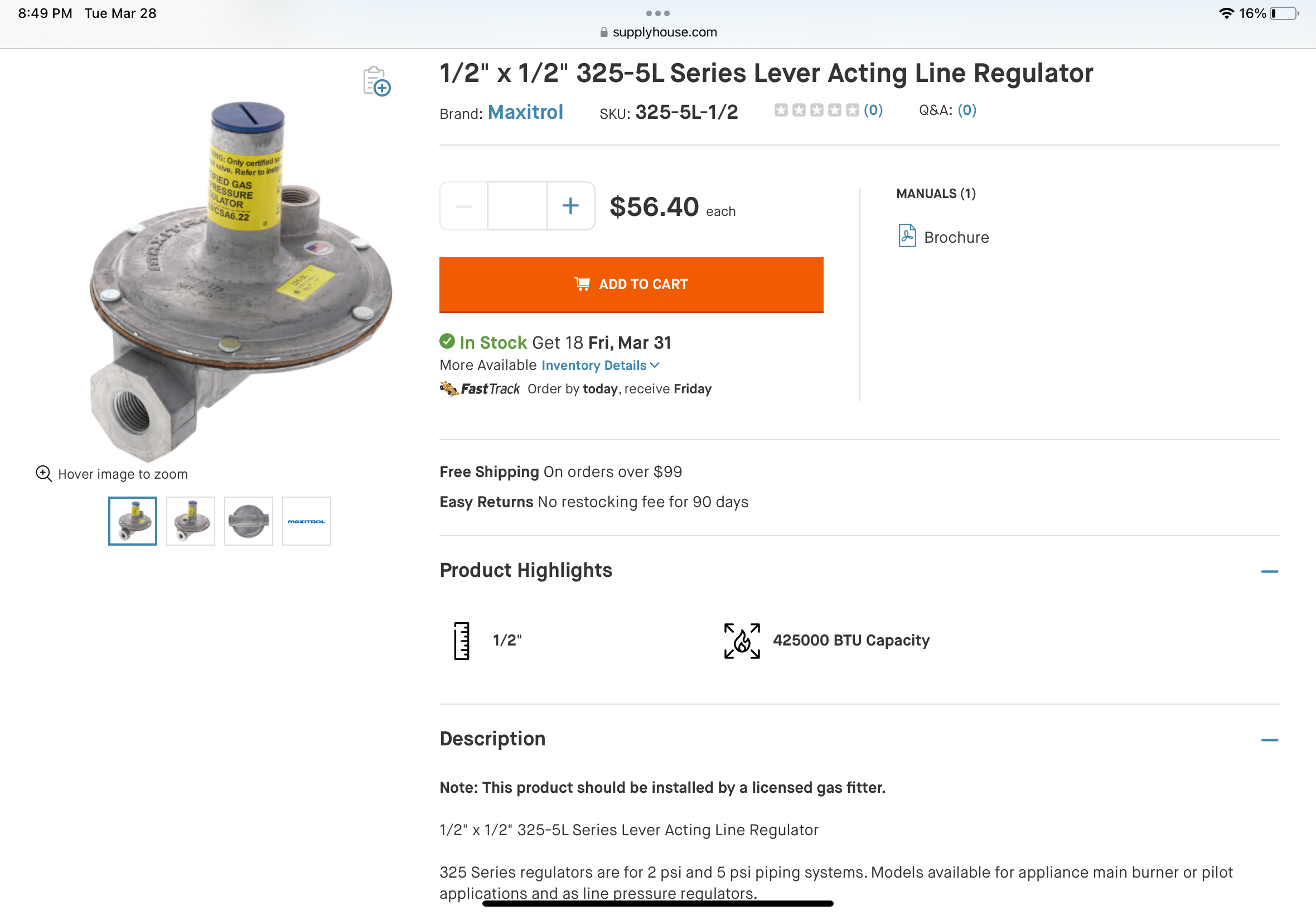

    here are the regs I used, download the installation manual for info.
    It does state they be installed by a licensed gas fitter. Are you?😳
