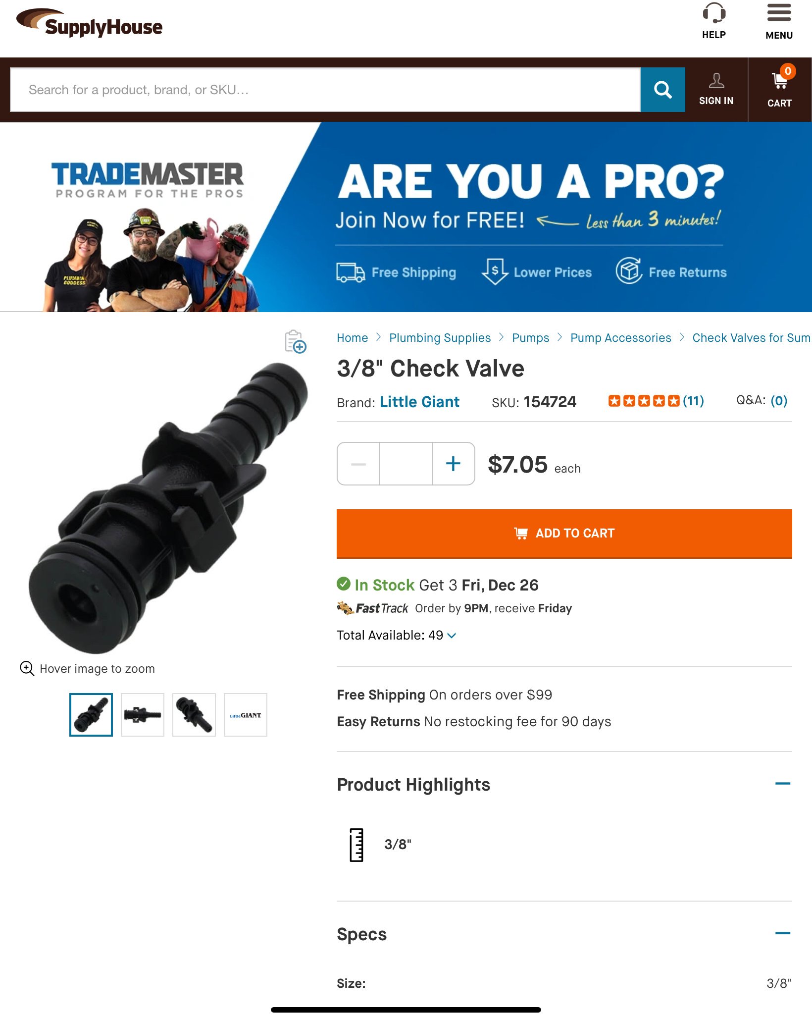

did it come with a check valve, check it to be sure something is not stuck in it.
Slope the condensate line down as soon as you can, as the instructions suggest.
