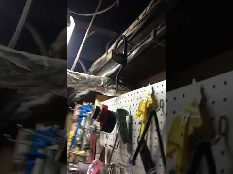

    If you send a photo of the piping atop your boiler, we may be able to determine if a velocity issue is causing water to accumulate.

    Ill try and get a short video of my piping. Here is the Pressuretrol. Do these settings this good? The Steam Radiators are on the 2nd and 3rd floor of a 3 story 2 family home.

    Here is a video of my piping the best i could do.
