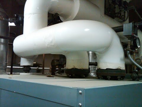

    ok, I'll ask it. What is a swing joint?
    I have an idea, but this video isn't clear

    @WaHeat Here is a picture of one. It absorbs the expansion and contraction of the pipes. Hope this helps

    EdTheHeaterMan Member Posts: 12,594
    edited January 2023
    Lance said:
    A swing joint is a dance hall playing big band music to swing your hips to. ;)
    I have to say that I wish I thought of that! I am going to nominate you for a First Place LOL of the Month Award.
    @WaHeat
    Here is the reason for the expansion joint.
    When the boiler makes steam the boiler gets hot first and the pipes are still cold. The boiler expands as in the center illustration, the pipes will not give way as shown. So the boiler gets additional tension compressing the sections together as the 2 risers and the header act as a clamp trying to hold the boiler from expanding. Those cast iron connectors may be push nipples for neoprene gaskets. Whatever the connections are made of, they will eventually fail or a section will crack under the extreme stress of the heat expansion over and over again from each steaming cycle.
    By adding the swing joints, as in the illustration on the left, the boiler can expand while the rotation of the risers compensate for the expansion. Shortly after the boiler expands the pipes will get hot and will also expand and the risers will rotate back. Think of it like taking a tin can lid and bending it on a crease. If you continue to ben that crease over and over again, the lid will eventually break in to two pieces. But Boilers cost more that tin can lids so you don't want that stress to happen on a regular basis
