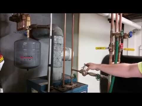

I have a GWA-105-N-T and for 1 out of the 4 zones I don't feel any heat in the baseboards of that zone.
Here is the steps I did to test:
1. I turn on the heat in my thermostat
2. I can hear the valve gear turning, then some water(cold at this point) would flow through and I also hear water flow sound for a few seconds at the baseboard.
3. Furnace would start(then stop when it reaches 180f),
4. But the hot water is not reaching the baseboards, and when I touch the pipes around the zone valve , it is lukewarm.
5. Return pipe is also cold.
6. It feels as if the zone value opened then closed by itself? Is that even possible.
Thanks
    EdTheHeaterMan Member Posts: 12,286
    This appears to be air in the closed loop. Do you know how to remove air from your baseboard loops?

    Thank you for the suggestion, I find this video youtube, would you say this would be the steps to follow to try?
    https://www.youtube.com/watch?v=z80WspC4Nmg
