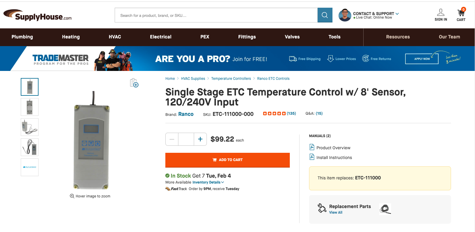

    Bumping this great old thread because I plan to try this strategy. How would you handle tank temperature regulation? I'm looking at using a strap on aquastat directly to the steel tank. It seems like inexpensive modern electric water heaters don't have a satisfactory thermostat for this use case. Using a basic aquastat I can target 180 with a 50 degree differential.
    hot_rod Posts: 28,705
    This is the control I like to use. It has a lot of adjustability, nice readout. Other versions from HW and Johnson controls. The sensor against the metal tank jammed under the tank foam insulation is accurate enough.
