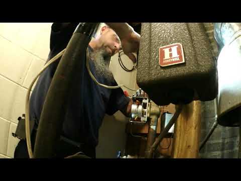

    My guess is that your zone valve actuator (includes the motor and the end switch. Basically everything silver) needs to be replaced. Sometimes the gear that moves the valve gets worn over time. This means the valve will open but the end switch may or may not be activated. It can be intermittent, but as the gear ewars more and more, it will happen more often.
    here is a good video on how a pro might change the actuator head. https://www.youtube.com/watch?v=bC8NORCDJ7Y

  • That's a helpful video, thanks! Hopefully the new actuator solves the problem - I'm a little concerned that after putting the problem valve back the boiler no longer ignites.
