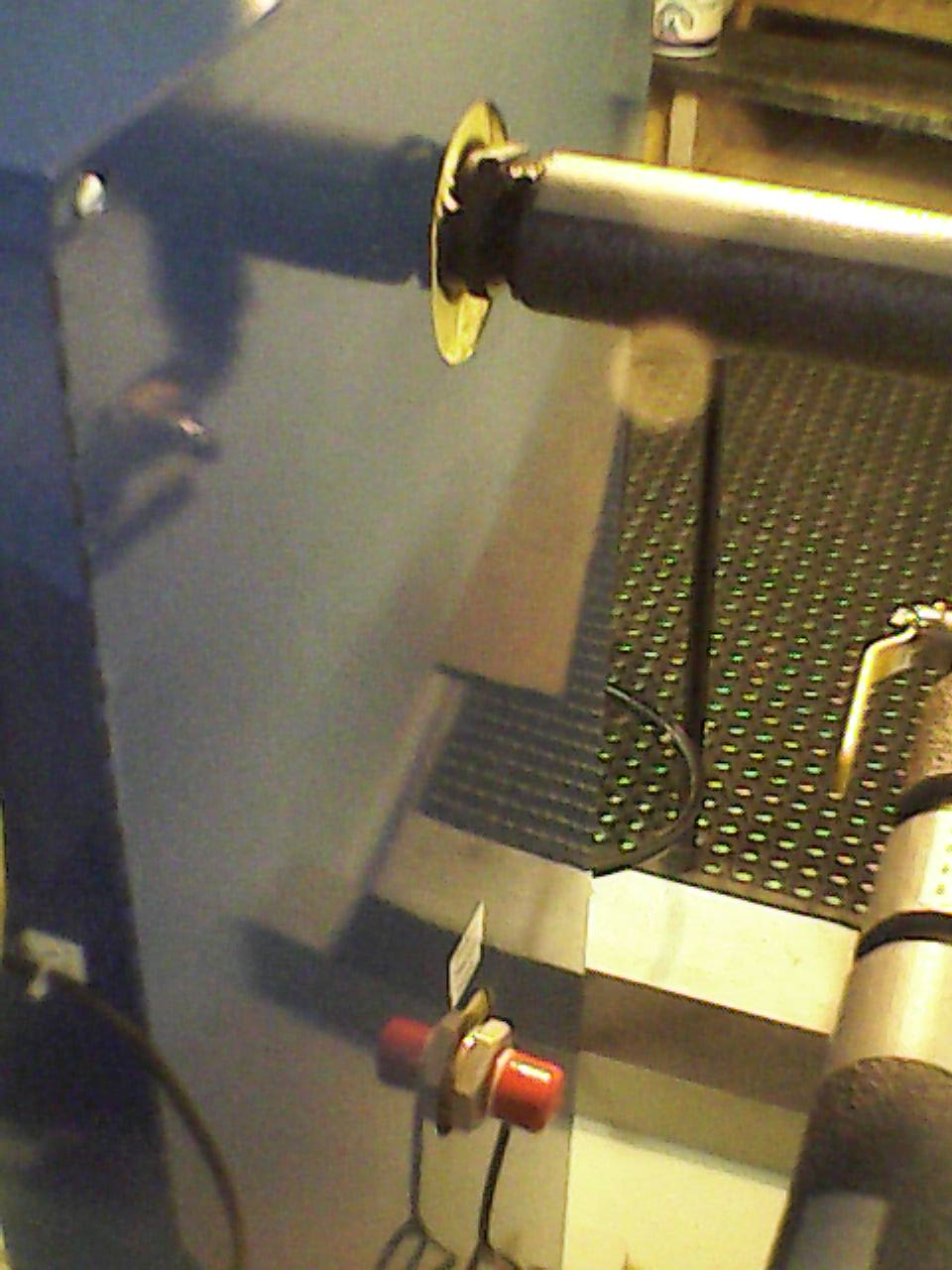

MikeAmann said:
Here is the one I have installed on my SS IWH. You just remove the aluminum rod that the unit came with and install the powered unit, connect the circuit, and plug it in.
I got mine here: https://www.ebay.com/itm/142271777319?hash=item21200f0a27:g:0dMAAOSwZgtiN63S
Can you please post Pictures on the location of the Heating system Anode?0 -
Nice labeling. Always good to leave a clue for the next guy. That remind me I need to add a few labels to my system.MikeAmann said:I just put it in the unused rear tapping, which is right at the bottom of the tank. This boiler is old, but when I removed the plug that was there, all the threads looked brand new. I took a look inside the tank and was blown away with what I saw - great shape. So I installed the powered titanium anode because I want to keep it that way.
