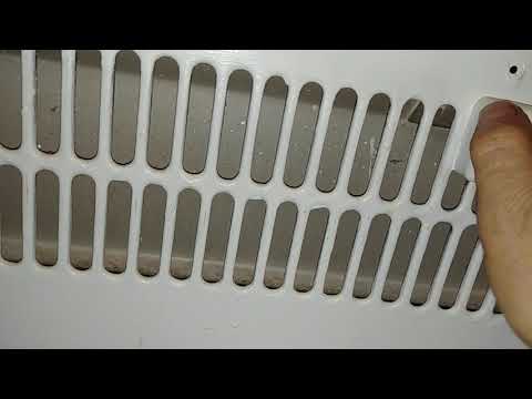

    GW Member Posts: 5,188
    https://photos.app.goo.gl/EjJJscLcj5sWoz5Y6
    I had to make a quick video, my audio captured the family interacting with each other

    Jamie Hall Member Posts: 27,584
    GW said:
    Jamie- they are extensions. I just call them returns becasue they drop in diameter and head back to the boiler
    Then having a connection at each end and a vent really makes them into a version of a two pipe air vent radiator -- which should work pretty well. But they will need venting -- possibly rather aggressive venting. What's on there now? They also should pitch one way or the other, if only slightly. The condensate has to be able to drain.
  • GW
    Jamie the bb units are flat. The vents- not sure what they are, basic convector style vents. I’ll work on some ideas for this ranging in price and guarantee. Thanks for the tips

    mattmia2 Member Posts: 17,481
    Does it go back up and form a trap before it goes in to the dry return or does it just keep sloping down?
    I suppose if you wanted to get really fancy you could try an orifice plate in the supply that limited the steam to the amount the baseboard could consume.

  • GW
    edited February 2022
    One of the 4 has a cute copper ptrap, the other are somewhat flat and no traps
