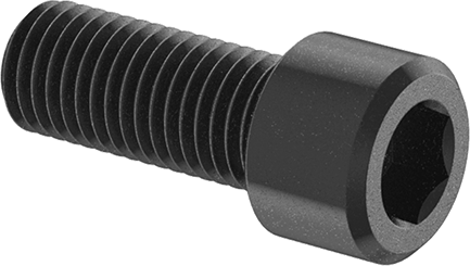

I'm looking to further balance my steam system and I have Maid O' Mist air vents that have the interchangeable orifice's on them. I'd rather not but some additional vents just to get the orifice and I know I can get a vent with one of all the orifices.
Does anyone know the thread size of the orifice that screws into the MoM vent? I'd like to buy some plugs or short bolts that will thread into the vent and I can drill my own holes.
Much cheaper and allows me more flexibility.

    It's 5/16"-32
    Here's the tap and die I bought to try to make a check valve for mine. It was a perfect fit: https://www.amazon.com/gp/product/B08MZ5WZPJ/ref=ppx_yo_dt_b_asin_title_o05_s00?ie=UTF8&psc=1
    I made the pieces with my mini-lathe, it was fun.
    However!!! Every so often I see one with some other thread size on it. I've purchased maybe 6 vents and one of them had this other (unknown to me) size on it.
    As for much cheaper, there's no way it's going to be much cheaper than the MoM prices but suit yourself :)

    I measured one a few years back with the same idea, it was not a typical SAE thread, but an odd one like 5/16-28. I'd gauge it but I don't have one here. I'm amazed they don't sell them with the complete set for a buck more or something. The pros, of course, presumably travel with a sack of them.
  • Jells
    Jells Member Posts: 649
    edited February 2022
    Found one, had a bad one from HD sitting in the van to be returned, and forgot about it. Yes, it's 5/16-27 or 28 near as I can tell with a caliper and comparing it to a 3/8-27 tap. How insane is it that they make them both???
    You're not likely to find screws in this size. It'll run you like $12 for a die. Take a 5/16 brass rod and thread it with the die. You could even put the die in a vise and the rod in a drill and run it through. Then cut it up for your vent orifices. Of course, a lathe would help tremendously.

    Guess I missed the link. How did you determine it was 32 tpi? Not that it wouldn't work in a 27 tpi, or vice versa, for the few threads we're talking about on those orifices. I had a thread gauge once upon a time, I guess it's deep in the archives somewhere.
    ethicalpaul Member Posts: 8,725
    I measured the thread, then got the die and cut a brass rod to test it
  • Jells
    On the female side with an actual thread gauge? There's not enough threads on the male to gauge them accurately to within a few tpi. But like I said, for this close enough is fine. There's some SAE to metric close calls that will work fine for a nut but not a deep tapping.
    I measured the male with a thread gauge. I’m not sure what the mystery is

    The OD of this thread is 5/16, much smaller than npt 1/8. It sure seems like it's not a pipe thread but a 5/16-32 machine thread.  I didn't see any threaded rod on McMaster Carr either in these sizes, which is why I suggested a die and 5/16 brass rod.
    If I were to make them I'd take it as a challenge to work on my single point threading on the lathe, not something I have any skill at.
    My lathe can't cut threads very well. Or I can't cut threads on it very well. Or both.
    That's a very fine thread and the die is very affordable but good luck regardless

    Thanks guys! It looks like there are two options....buy a 5/16-32 die and some rod and tap these yourself....
    Or just buy a 5/16-32 bolt and drill it to the orifice size you prefer. Here is a socket head 5/16-32 screw. 3/4" long so either live with the extra length or cut it down.
    $19.49 for a 5 pack, so $3.90 each. If you don't have a die already this may also be an option.
    https://mcmaster.com/90044A207/

    If you already have extra MoM orifices, you can just drill them out to the size you want. If you want to make the hole smaller, fill it with solder. Then drill it out to the smaller size.
    That's an expensive screw
