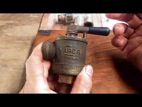

@icarmany
drilling and tapping the reducing elbow is fine but I would drill and tap the 3 x 1 1/2"??? tee to keep the vent away from the end of the main0 -
@icarmany
Welcome to this forum!
You mentioned Broomell quintuple radiator valves in your post above.
Below is a YouTube video you may find useful.
Please comment, like & subscribe.
https://youtu.be/rj_jK1WTJ1M
I receive absolutely NO kick-backs from YouTube for my videos.Hydrolevel VXT Fanboy
