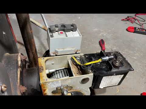

EDIT: Here is a video of how to change a Cad Cell Flame sensor. Your burner may be slightly different but most burners (NOT ALL) are similar.
https://www.youtube.com/watch?v=Pdqfmc23mNc
Look at the location of the flame sensor eye that is being replaced. You can remove it without removing the gasket material as shown in the video. Look at the glass lens portion to see if there is a coating of soot on it. If there is, then you just need to wipe it off and you will be back in business.
That being said, if you have a coating of soot on the eye lense, it is probably time for a complete maintenance by a professional oil burner technician. That should be completed annually on most burners. When was the last complete maintenance? More than a year? This reset button issue is telling you that you need service.

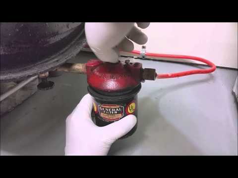

If it is not the Eye, then it may be a partially pugged oil filter. That is a messy job but can be completed as a DIY. Here is a video on filter replacement.
https://www.youtube.com/watch?v=yx9g9P_z5So
