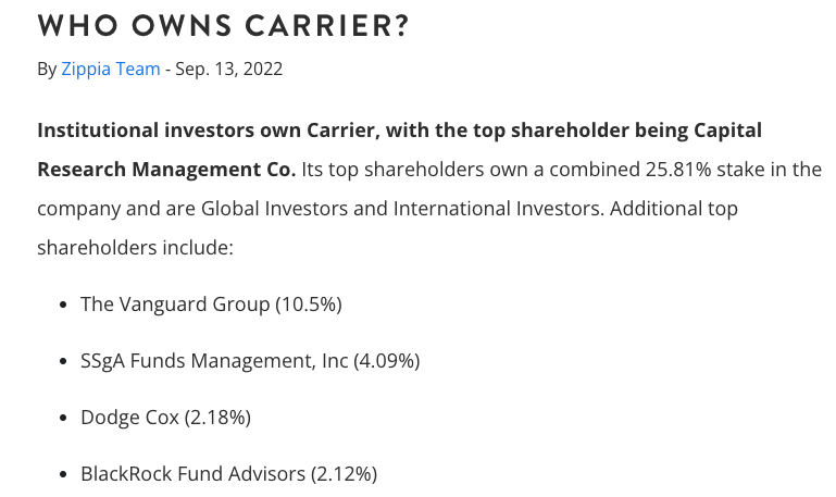

Carrier purchased Viessmann. Wouldn't that make Viessmann now, ALSO and American company?
but who owns carrier?
Carrier separated from UTC in 2020. Maybe you and I own part of carrier?
Living the hydronic dream1 -
Thanks hot_rod! I own a very tiny piece of Carrier and an even smaller piece of Viessmann.
