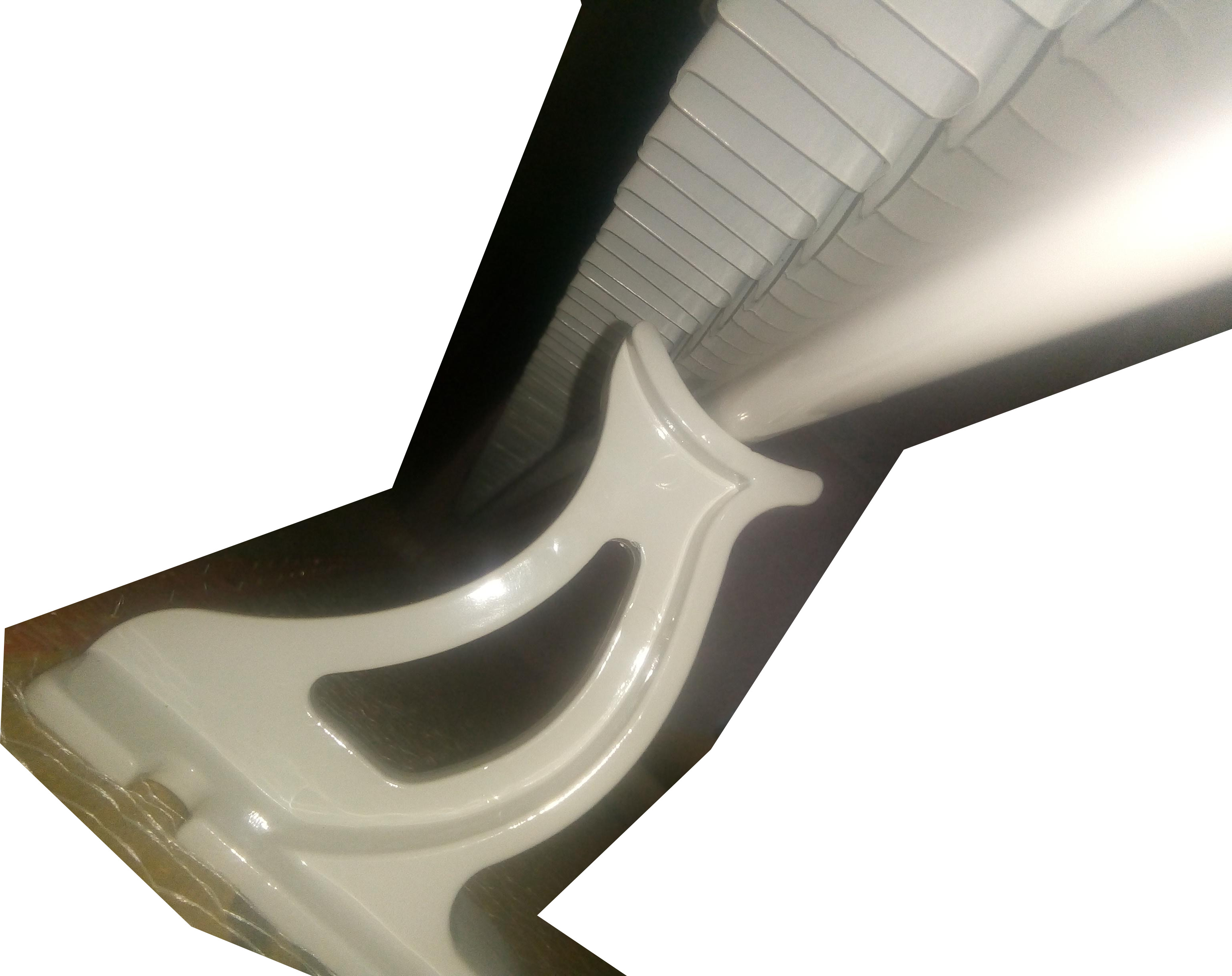

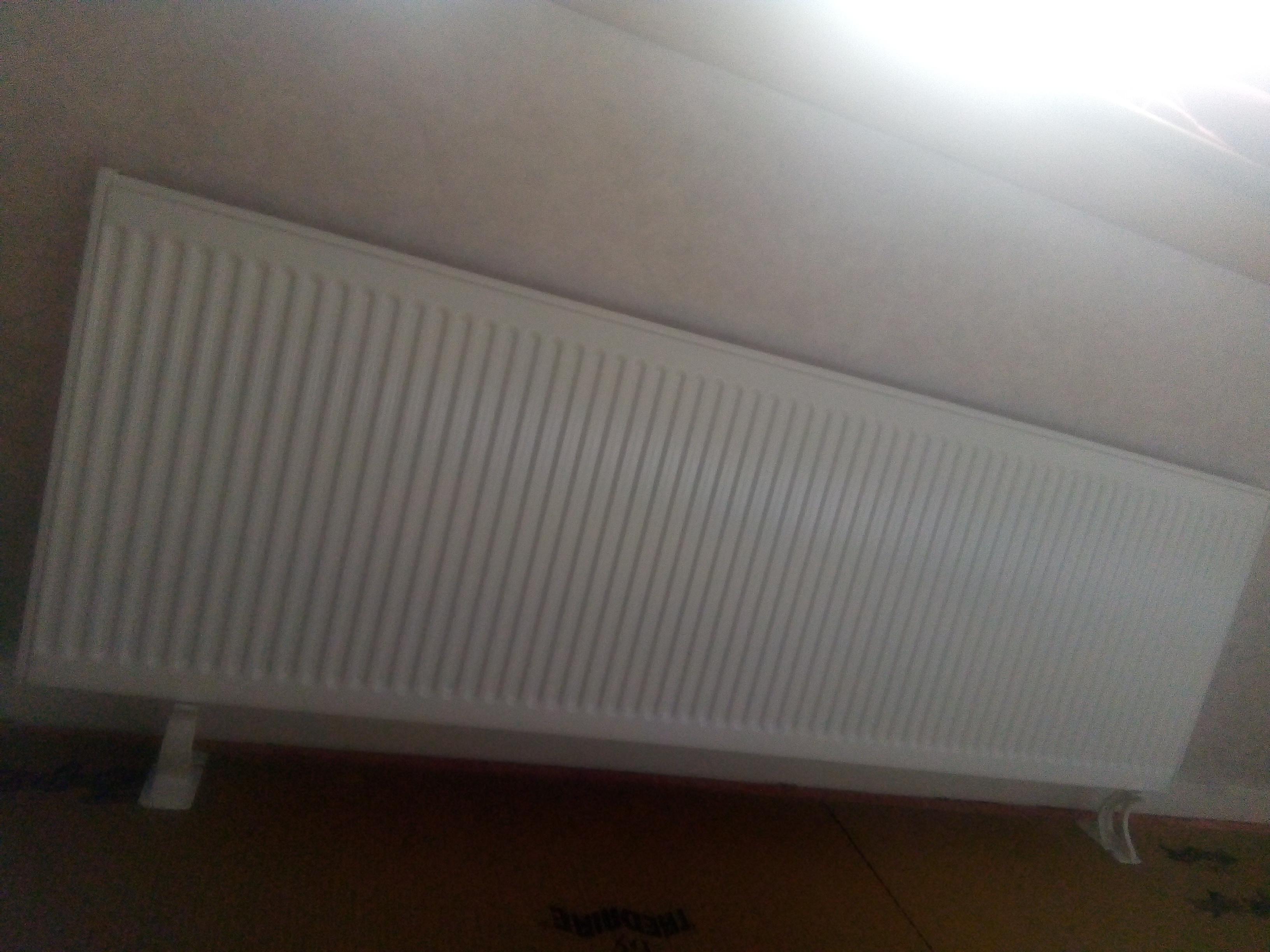

One pic shows the experiments I'm doing with supporting a type 11 radiator (160cm wide, 50cm high, total weight around 35kg) using universal column radiator feet.
The other pic shows the detail of the contact surface between the rad and the feet.
Aesthetic considerations apart, is there foreseeable problem with what I'm doing?
Of course, the feet would be in addition to standard wall-mounted brackets (which I wanted to complement because I don't trust their strength, for various reasons).
I'm asking because these feet are sold to be used on column rads, which my rad is not: https://radiatorvalves4u.co.uk/516-column-radiator-foot-white/
Thanks
Thanks
Can't see any good reason why that shouldn't work just fine. But you will need a secure attachment to the wall -- not to hold the weight, but to prevent the radiator from toppling forwards.Br. Jamie, osb
