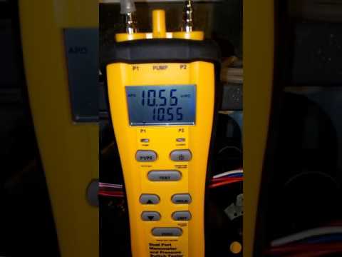

    Gas Pressure:
    I don't have equipment to test gas pressure, which has been indicated several times in this thread and in the troubleshooting flowchart. I found this digital manometer for $40, but I don't know if it's suitable for this purpose: https://www.amazon.com/Manometer-RISEPRO-Digital-Pressure-Differential/dp/B01680C4C2/
    Also, I'm not familiar with testing gas pressure, but did find this video:
    https://www.youtube.com/watch?v=ugnizYBVH9o
    The video covers checking inlet and outlet pressure on a furnace, not a boiler, but I imagine the principles of testing a gas valve would be similar either way. I can check the manual for the gas valve for specifics on where the test ports are located.
