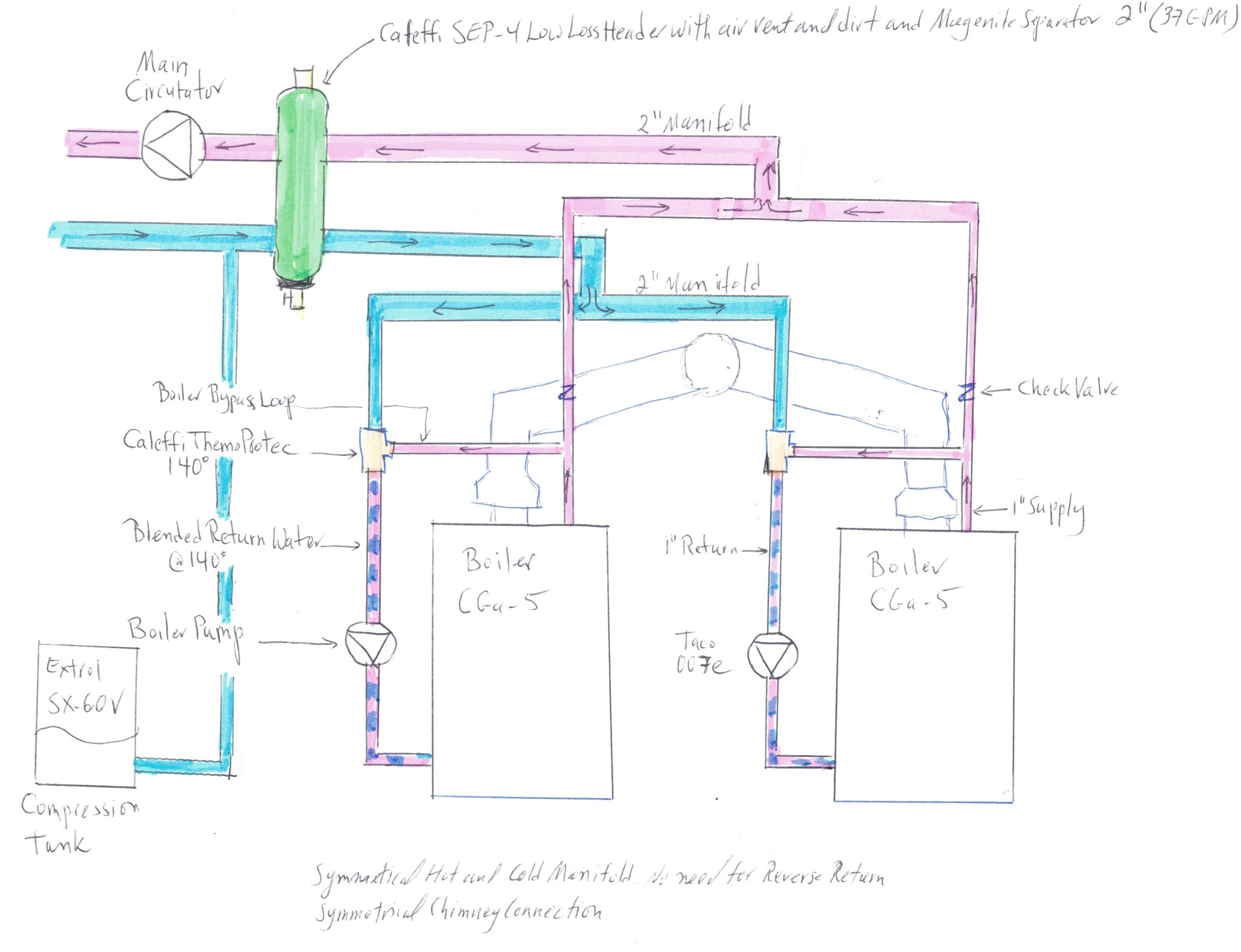

    Recently, I noticed insulation inside my old boiler starting to break off and fall on the flame tubes, and it has started making a banging noise a minute or two after shutting off (I think it's the casing cooling down). So I'm working on a replacement again, especially since my neighbor had to have an emergency replacement in the middle of winter. I have decided to forego Mod-Con boilers, even though my low-temp gravity system is a mod-con's dream. My better half really hates the look of steam coming off the side of the house and I'm not keen on putting a hole through my 1 1/2 foot thick masonry walls either or venting through a basement window. I know some mod-cons can be vented with appropriate vents through the chimney, but the vents have to stick a foot or two out of the top of the chimney, which is also unsightly, and getting an ice-dam 50 feet up in the midst of winter would be a disaster. Also, whatever I save on gas I'll probably end up spending on annual maintenance. And there is also the shorter life-span of the typical mod-cons compared to CI.

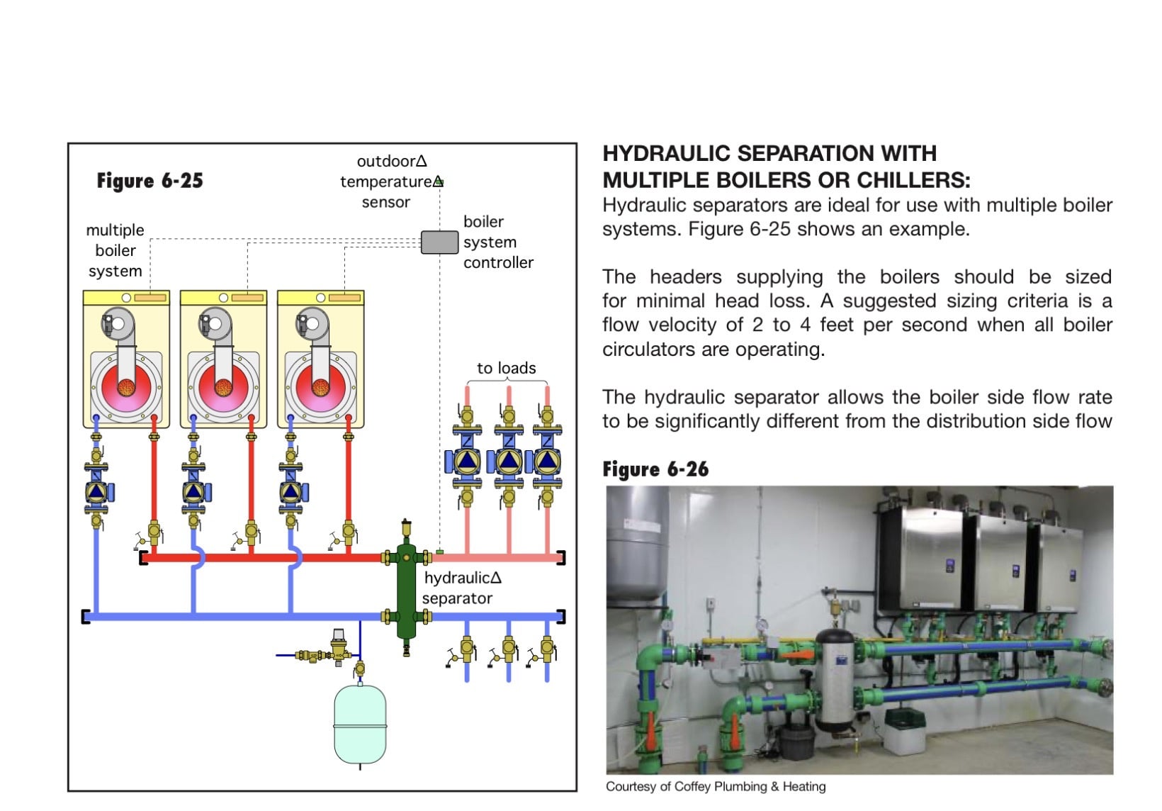

    So I'm working on getting two smaller cast iron boilers of 133K input, each of which would give me about 60% of my heat needs and keep the house from freezing if one boiler fails. They can also safely share my 50' tall lined chimney. The system is slightly oversized still, but I think the next size down (100K input) is just a tad too small, especially for redundancy purposes. I'd rather pay a little extra for gas than deal with frozen pipes and water damage in an old house in case of a boiler failure in a super cold week like we had recently. I would have loved to get the Buderus boiler, but they have stopped marketing it in the US, and even though it's still available from some suppliers, I worry about support and parts in the future. So I am going to go with a WM CGa-5, which everyone seems to be quite familiar with, and I won't worry about parts and support. I just have to find a good installer to do what I envision. I have seen so many bad install jobs in my area, and I want mine done right. This is kind of what I have in mind.
    hot_rod Posts: 28,701
    here is a good way to pipe multiple boilers to a seperator. You do not need or want to bull head, bring two flows into the run of a tee. The branches off the sep should be 2” as you show to maintain low velocity when both are flowing.
    My suggestion is to run a hydronic cleaner after the installation, use good fill water, see the manuals recommend water quality. I like to add a conditioner also. It protects the metals from forming a scale which will reduce efficiency of the heat exchange.

    Thanks Hot Rod! So you think my drawing is pretty sensible? Is there anything you find wrongly thought out with my drawing??
    As far as a mod-con / CI combination goes, I see your point, but I don't think it would be great for my house, since my supply water never needs to rise above the low 130s on a 0 degree day with return of around 120. If my system ever required higher temps, I think adding a cast iron to mod-con would make great sense. A pure mod-con makes perfect sense as far as performance and modulation goes, especially since low temps like mine are a mod-con's dream, but there is the issue of side venting which I really want to avoid, or venting through a pipe sticking out of a chimney, which is even uglier.
    And when I ran the numbers, what I would save in gas annually in STL came out only a tad above what I would spend on annual maintenance, especially on a boiler with more fragile components than a cast iron one. And then there is the shorter lifespan of mod-cons compared to CI. I think my plan has a good balance of decent performance, CI dependability and low maintenance, and redundancy in case of a single boiler failure. And if I use something like a Tekmar 294 with an outdoor sensor and an indoor sensor (or Tekmar communicating thermostat), I should be able to have outdoor reset and good comfort during the entire season, plus the peace of mind of redundancy.
    To be honest, if anyone in my area were familiar with the Viessmann CU3A (as they seem to be in New England), I would even compromise on side venting, but I have to think of parts, maintenance, local expertise and all that goes with it. So for me and my area, it seems that run-of-the-mill WM cast iron boilers make sense.

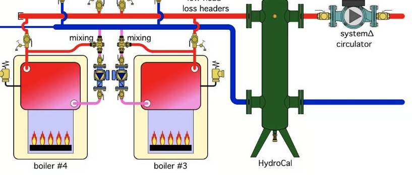

    Do you see the difference in your proposed piping vs the attached example? There in no need to tie the boilers together before you connect to the separator headers.

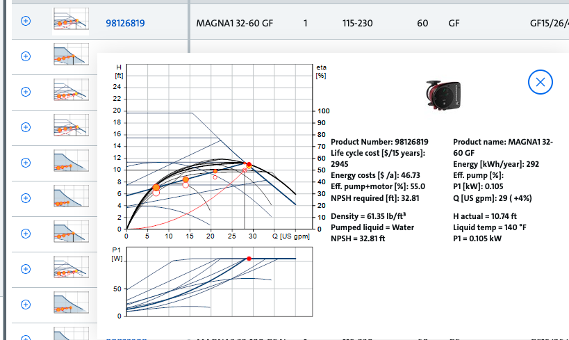

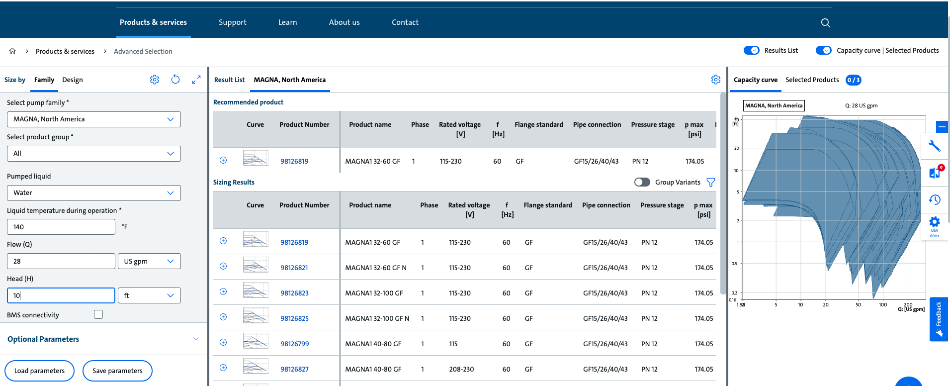

    To size a pump, use one of the online calculators, pick a brand, here is a Grundfos example..
    You need to know gpm, head, type and temperature of the fluid.
    I used your 28 gpm, guessed at the head of 10', water at 140°?
    It spits out a list of pumps, hover over a choice, the smallest Magna, and learn all about it down to operating costs.

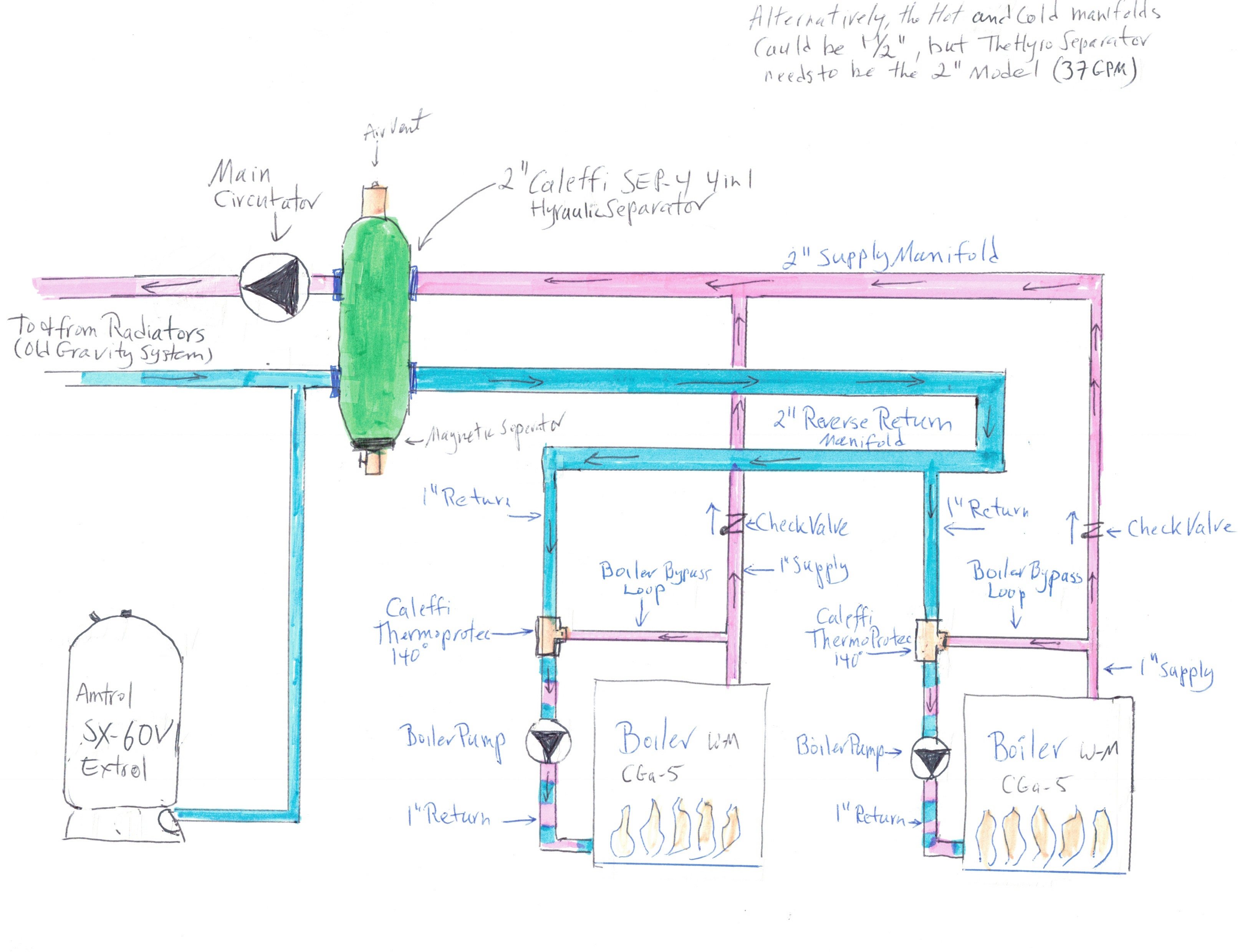

    Thank you! I drew the diagram because if you face the boilers where the would go in my basement, the old gravity pipes would be behind you, so it kind of made sense. I thought the supplies and returns would connect to the 2" pipe and then from the center would take off and go toward the old gravity pipes. But I had no clue about the "law of the tee!"
    Thanks for all the information on pumps. I had done some reading on the Magna, which claims to be magnetite resistant, though with a magnetic separator on the SEP4, I'm not sure how important that would be.
    This is the previous drawing I had done, with a reverse return (though it might be overkill with 2" pipes). However, looking more closely at figure 8-5, since the boilers are mirror images of each other, they are in effect doing reverse return, though that sort of piping wouldn't be possible on a WM CI boiler.
    if the boilers are close, within 5-6’ of the separator no need for the reverse return piping. Just tee them into the headers off the sep.
    The two Weil boilers are 113,000 output, so 11 gpm is plenty for each, 22 gpm total. The 1-1/2” sep 4 is rated at 26 gpm.
    If the system is zoned the flow on the B side would vary. But that is the whole intent of a separator, it allows various flow
    1-1/2” copper is good for 11 gpm at 2 fps velocity, 22 gpm at 4 fps.
    So the 2” sep might be a better choice, it’s about 30 bucks more at Supply House.
    2” copper is good for 20 gpm at 2 fps, you want low flow velocity in those headers
    A sep 4 covers your air, dirt, magnetic and hydraulic functions. So it does protect ECM circs from magnetite, etc.

    If you can run Visio, these Caleffi stencils work nicely

    Thank you. I think the boilers will be pretty close, but if not, I will ask them to do reverse return. I really enjoy thinking about fluid dynamics and flow behavior, so this is fascinating to me (just as it was fascinating to figure out blood flow characteristics in babies and children with heart defects when anesthetizing them for heart surgery). I started reading Dan's books almost 30 years ago and I have tried to understand my system well. And I think I have seen just about every Coffee with Caleffi and similar videos and try to educate myself. And I have also seen so to many badly done installation jobs that I've become pretty picky about how I want my own system to be done.
    I decided on the 2" SEP4 since mine is a gravity system with large pipes and lots of water, and I didn't want my primary flow to be limited to 26 GPM, especially since my current Taco110 is probably putting out around 28-30, which seems to be working well. The system isn't zoned at all, and the house is always evenly heated and comfortable. I think a Taco0035e Plus should do the job nicely and will also allow me to choose how many GPM are circulated through the primary circuit. I think it'll be fun to play with the flow and different Delta-Ts and just see how the system behaves.
