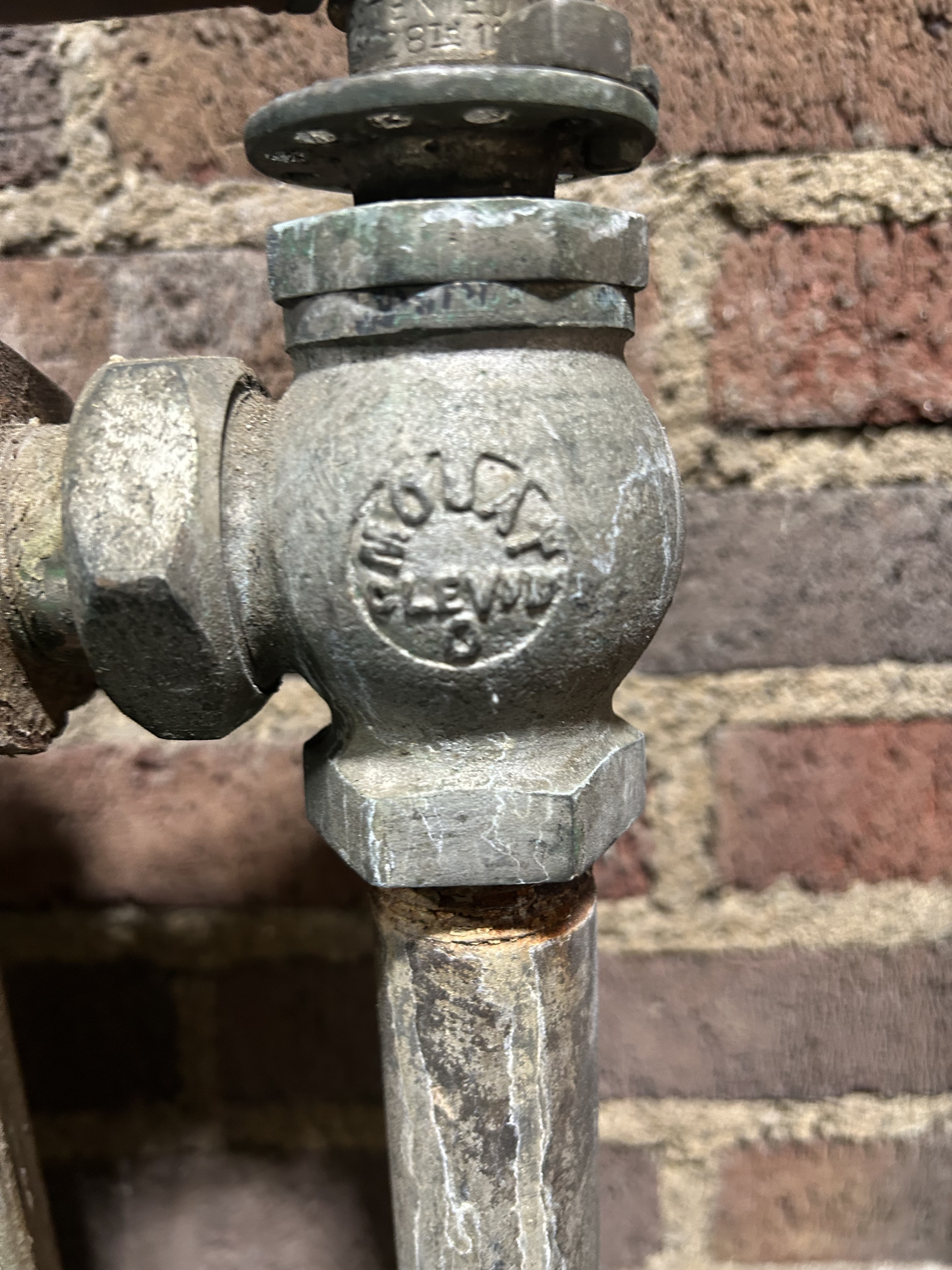

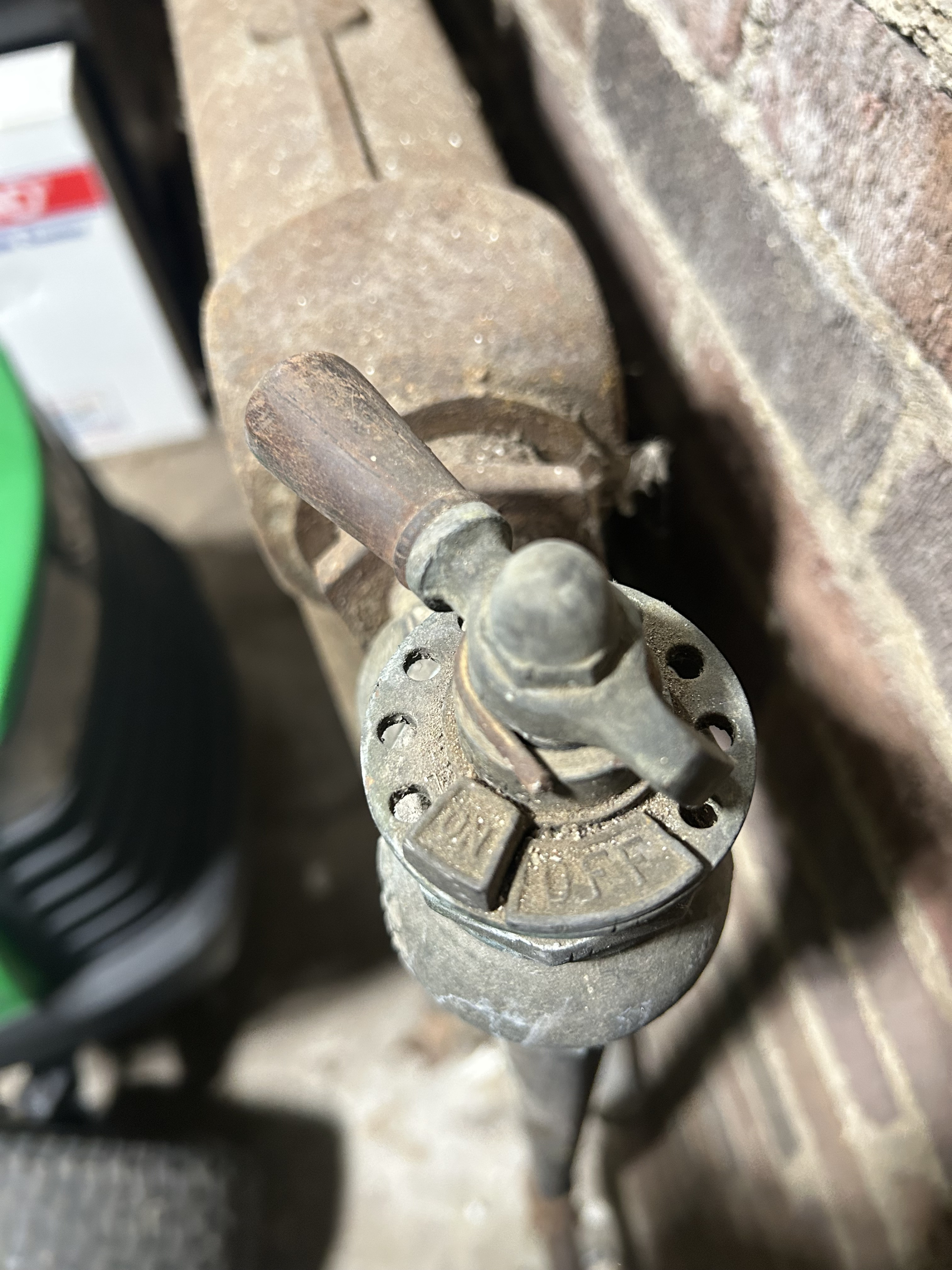

I posted an image of a valve to find out who’s make it is. After cleaning the casting it’s a Mouat. My main question is can they be rebuilt / repaired.
anything can be rebuilt. some things are easier than others. i don't know how those valves are designed but i bet there is a thread here somewhere where someone has taken one apart
If anyone would know, @gerry gill would.
