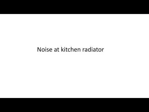

Help! I have oil fired steam heat with the old type cast iron radiators. During EVERY heating cycle, for the WHOLE cycle, there is this CONSTANT kettling/rattling/low banging noise in some of the walls and all the radiators. Loud enough not to be background white noise, and also wakes us up when heat kicks in since the noise in the wall is right by our bed.
Here is link to noise video:
https://youtu.be/e4_uy6he6mc
I've had two plumbers look at this issue, and so far no ideas of what is going on. Plumbers have tightened valves (some were leaking water), replaced the steam valves, checked pitches of radiators. They say that they typiclaly get reports of banging noises, but that this type of noise they had not heard, and cannot figure out!
Anyone experienced this, know what it could be?!
Thank you, Yara

    Thank you all for the ideas and thoughts! Super helpful. I will follow up with photos. I wish I could attach the sound files, but it's not letting me.

    I was able to upload some of the sound files to a youtube video. See below. Is this the water hammering noise some of you mention? This noise is constant throughout the whole heating cycle (can go on for more than an hour at a time), and it's not just a loud bang here and there.
    I'll post some more photos of the boiler later, but just wanted to share the sound files to see if you guys recognize this.
    Thanks again!
    Yara
    ethicalpaul Member Posts: 8,733
    I look forward to what the others think, but the sound seems "closest" to the bedroom radiator. I would probably have a look inside the bedroom radiator valve to see if the valve seat has rusted out and is lying at the bottom of the valve.
    It could also be a low spot in a pipe causing a water trap that the steam is bubbling through/collapsing against. Does the sound diminish during a long call for heat (like from a nighttime setback)?
    One thing you can do if you have one-pipe radiators with vents is one at a time, rotate the vent upside down then turn up the thermostat to see if the noise disappears. If it does, then you can narrow down the cause to the steam supply going to that radiator.
    The sound COULD also be coming from the boiler or a main pipe, but in my limited experience, I have never heard a sound like that from near my boiler.
