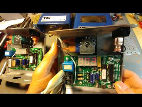

Instead of a DIY delay timer, I suggest you take a look at the Hydrolevel VXT with the intermittent test function I have mentioned in other discussions. No extra wires, just buy the one with the proper voltage for your system. Go for the digital readout, too so you can monitor makeup amounts.
In other discussions, some guys have commented on them. For my use, with an oversized boiler in a rental property, it's the safest solution.0 -
Inexpensive, simple, easily installed, doesn't confuse the next tech. What's not to like?SteamingatMohawk said:Instead of a DIY delay timer, I suggest you take a look at the Hydrolevel VXT with the intermittent test function I have mentioned in other discussions. No extra wires, just buy the one with the proper voltage for your system. Go for the digital readout, too so you can monitor makeup amounts.
In other discussions, some guys have commented on them. For my use, with an oversized boiler in a rental property, it's the safest solution.Br. Jamie, osb

@AdmiralYoda : Here is a video on the features of the VXT water feeder. I hope it helps.
https://www.youtube.com/watch?v=kF4WpyZdt4s&list=PLPrJrk_ajqswojOz All Steamed Up, Inc.

@Jamie Hall @Gordo
I checked it out....pretty cool and will function exactly as I want it to. And the techs will have a clue what's going on.
Question. How do you set the baseline water level? Install the probe where you want the waterline to be when all the steam is in the pipes and radiators?
If you get one of these and your arrangement would have the readout upside down, @Gordo has a Youtube video on how to modify the case so the valve can be rotated 180 degrees. It's not hard to do, just be careful when you put it back together.0
