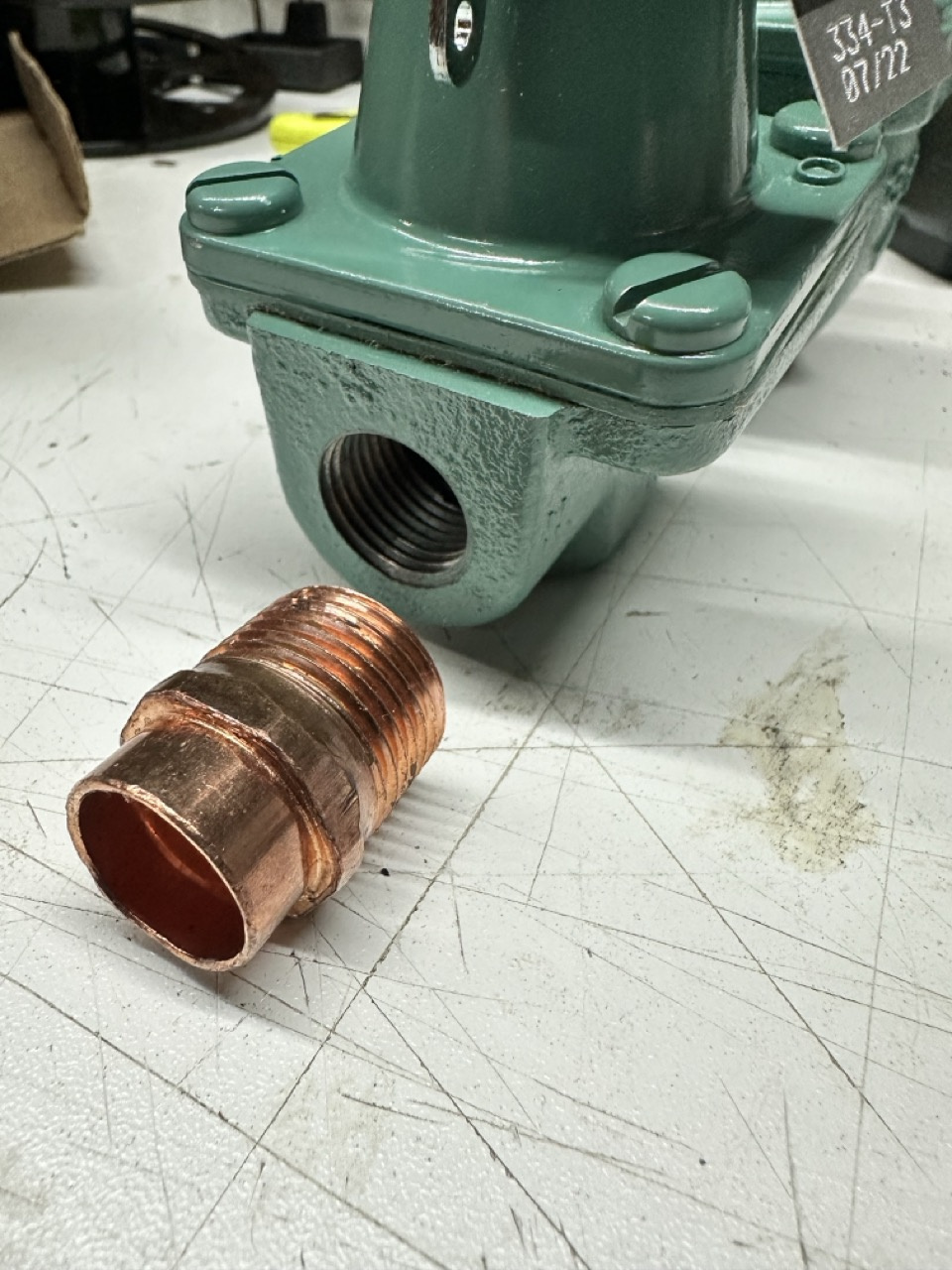

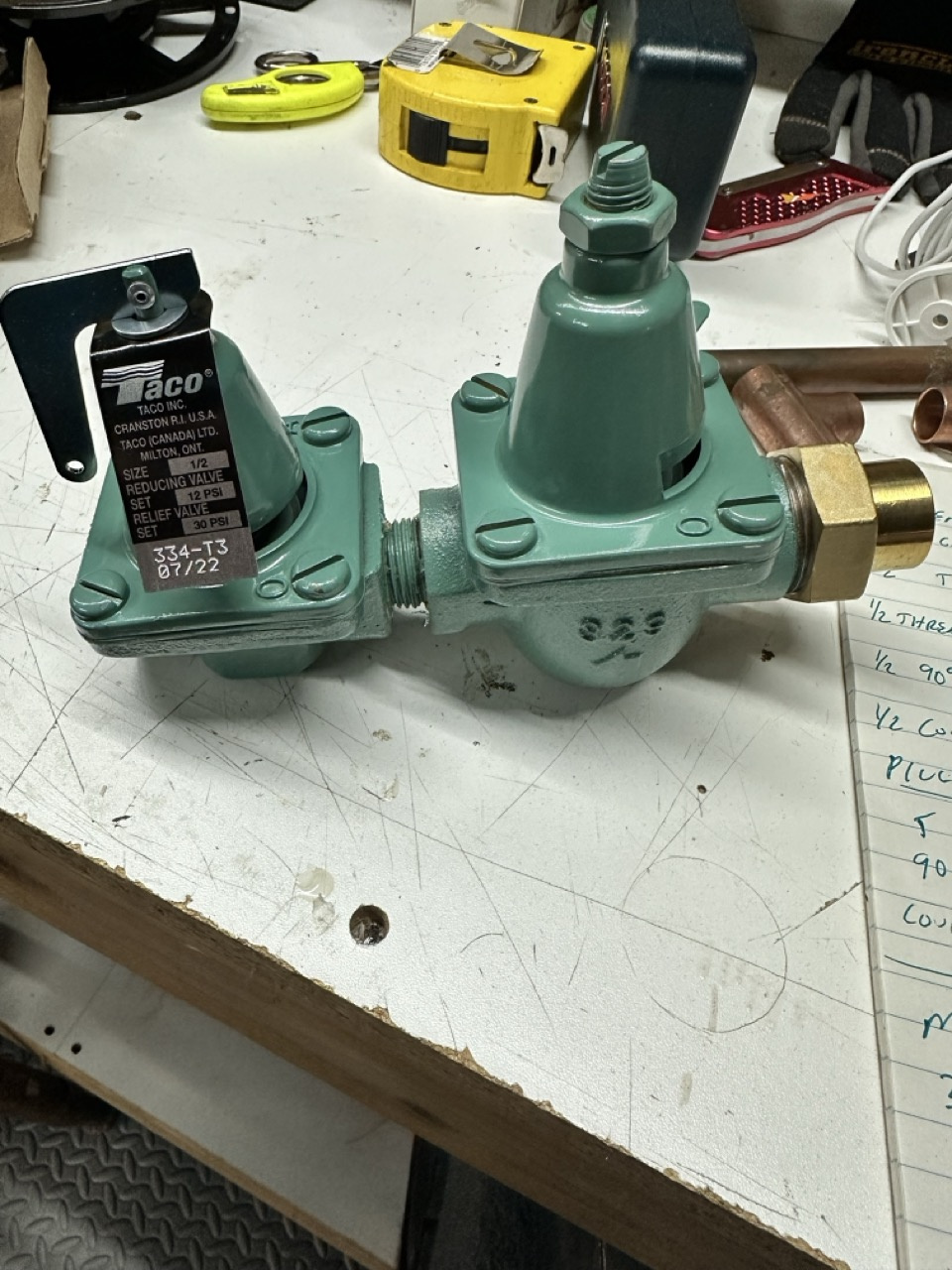

  • The municipality is still taking forever to come out to shut the water off claiming back logs of work and that this isn't an emergency that requires their immediate attention.
    The drip was very slow at first but now it's constant so it's certainly time to swap this out. My only question I have now is the replacement I ordered that is a check valve/pressure reducing system by Taco 334-T3 is made of cast iron and I have copper piping so the possibility of corrosion of two dissimilar metals exists. Maybe I'm overthinking this but I wanted to double check first.
    Would this be acceptable to use as a connector?
    This is the new replacement I have on hand:

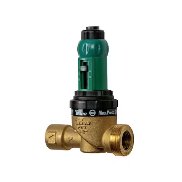

    This is some new style pressure reducer I saw but lacks a back flow check valve so I'm not sure if this would be a viable option or even better compared to what I have, only that it's a brass body. There are so many other variations I'm not sure what else to go with as what I originally picked up was a close visual match to what I had previously but it's a cast iron body which I did not notice until now.
