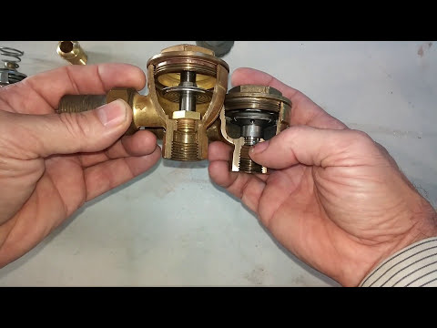

    @johnlobb : Hi! Welcome to the wonderful world of two-pipe (vapor) steam!
    Below is a video which I hope you might find useful on the Hoffman 17C
    https://www.youtube.com/watch?v=_nYhaFUgZX0
    In regards to the radiator valves, from what I can see, you have two different models: The "Sylphon" and what appears to be an early 1920s Warren Webster, which I refer to as an "innie" as the bonnet threads in on the inside of the valve body.
    The Sylphon brand ( the "outtie") was bought by Warren Webster, so that might be old old stock.
    It takes a bit of doing to get those buggers to move (think lots of penetrating oil, heat, and patience). The Sylphon may have a bellows in it that is not rebuildable, and as others have advised, Tunstall is your best bet there.
