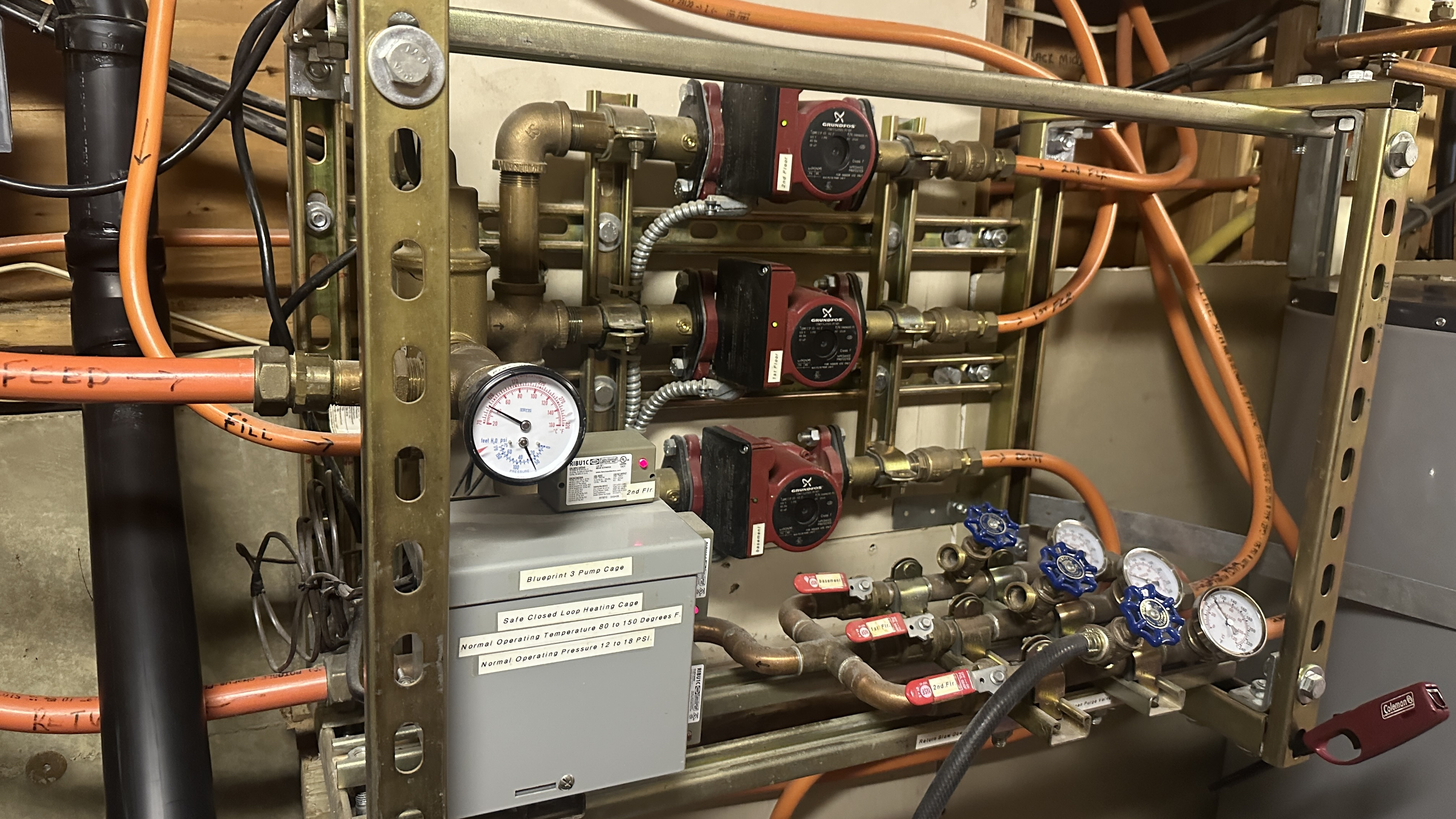

  • Well, I've have Kitec in my house for 16 years and not one problem - knock on wood. I have a 1906 old craftsman which I remodeled to keep for generations. I hired a CIPE who had 25+ years experience in plumbing and heating, including doing large buildings in NYC. He custom-designed and built (in his own shop) a radiant floor heating system for me. It uses Kitec tubing. He is out of the trade now, but never told me about the lawsuit, so it is too late for that now. Every floor, including the slab, has it. Only one of the pumps has gone out over 16 years. My house is 3250 sq ft, 3 levels, and my heating bill has never reached 300 and is around 200 even in the dark dreary period from Nov-Feb. Is it possible that I don't have the kind that has had the failures? If the pipes were going to fail, wouldn't they have failed by now? At this point is there anything that myself or a future buyer should be concerned about? I mean the system has been virtually maintenance-free.
  • Zman
    Zman Posts: 7,614
    I would not be concerned about Kitec failure. I would be very concerned about a future buyer's perception.
    Your installation would look cleaner if there was less tubing exposed and the drywall was continuous. You might consider replacing the "snakes" of tubing with copper and "protecting" the remaining tubing from damage by concealing it behind the drywall.

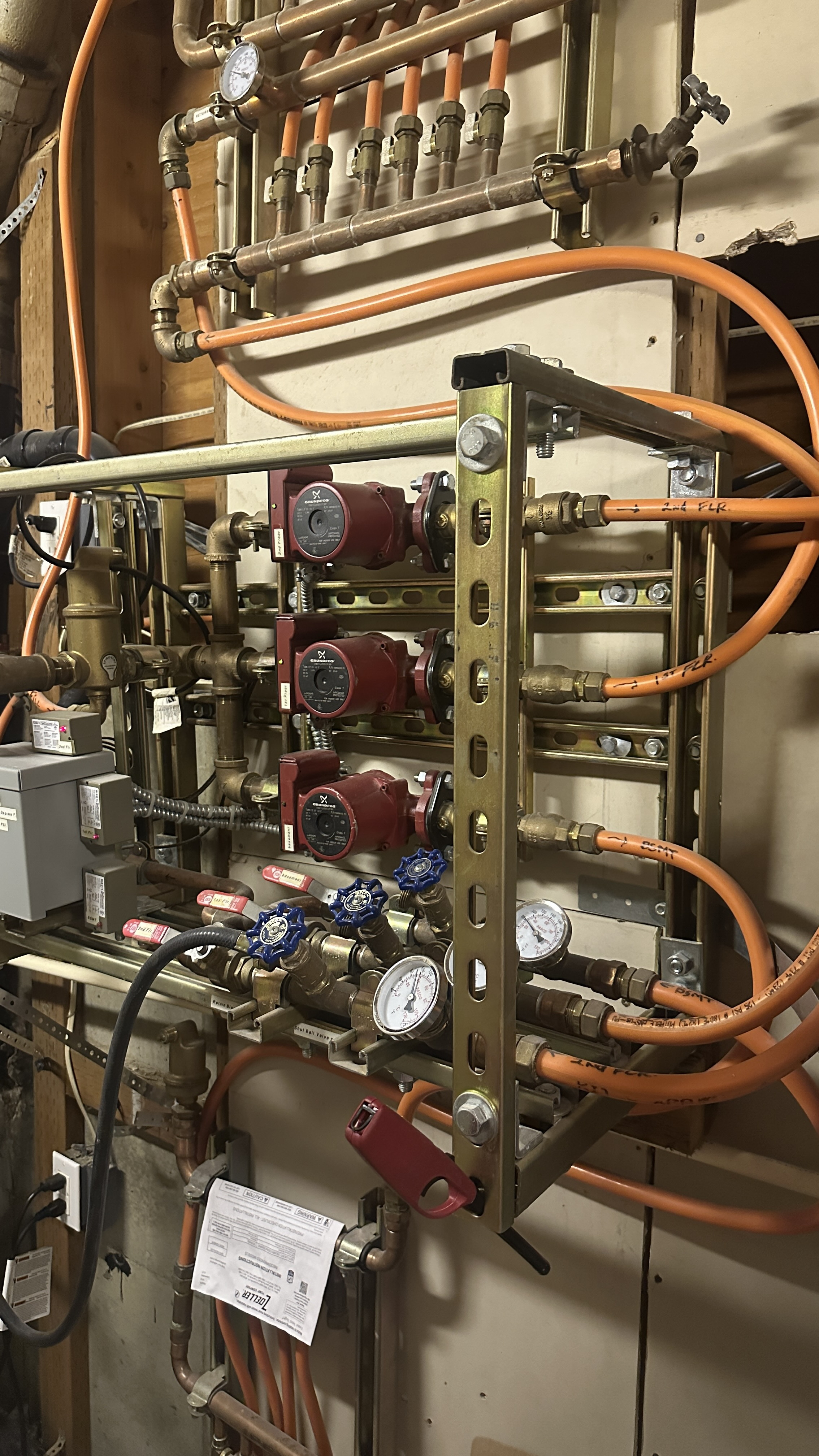

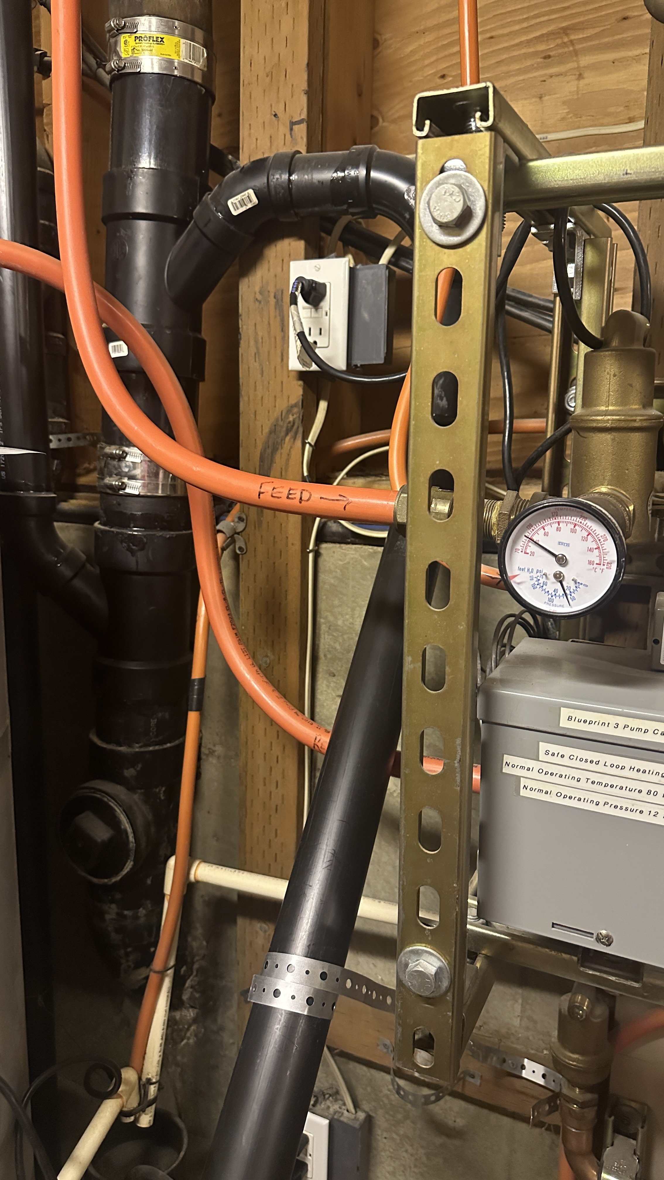

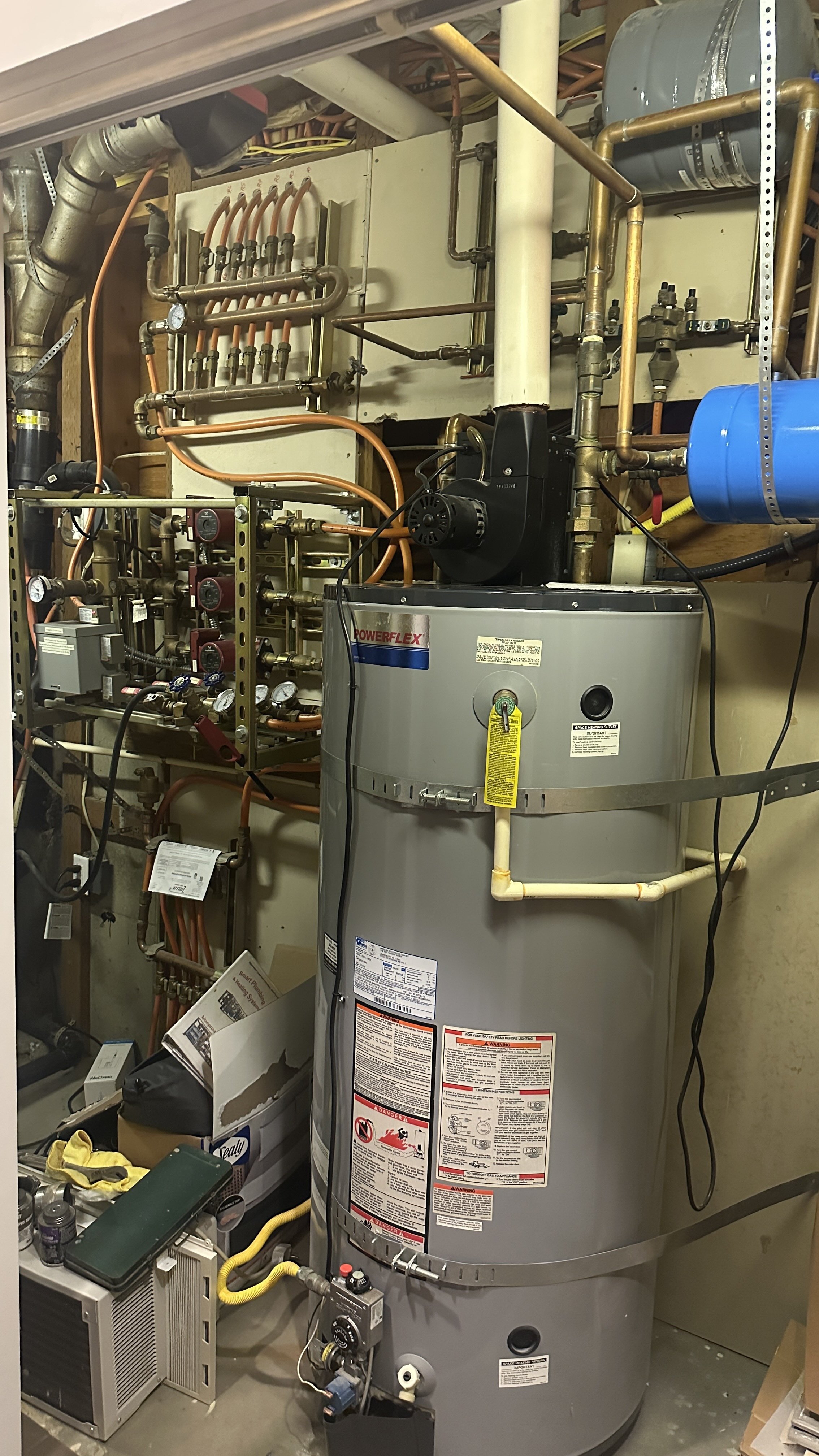

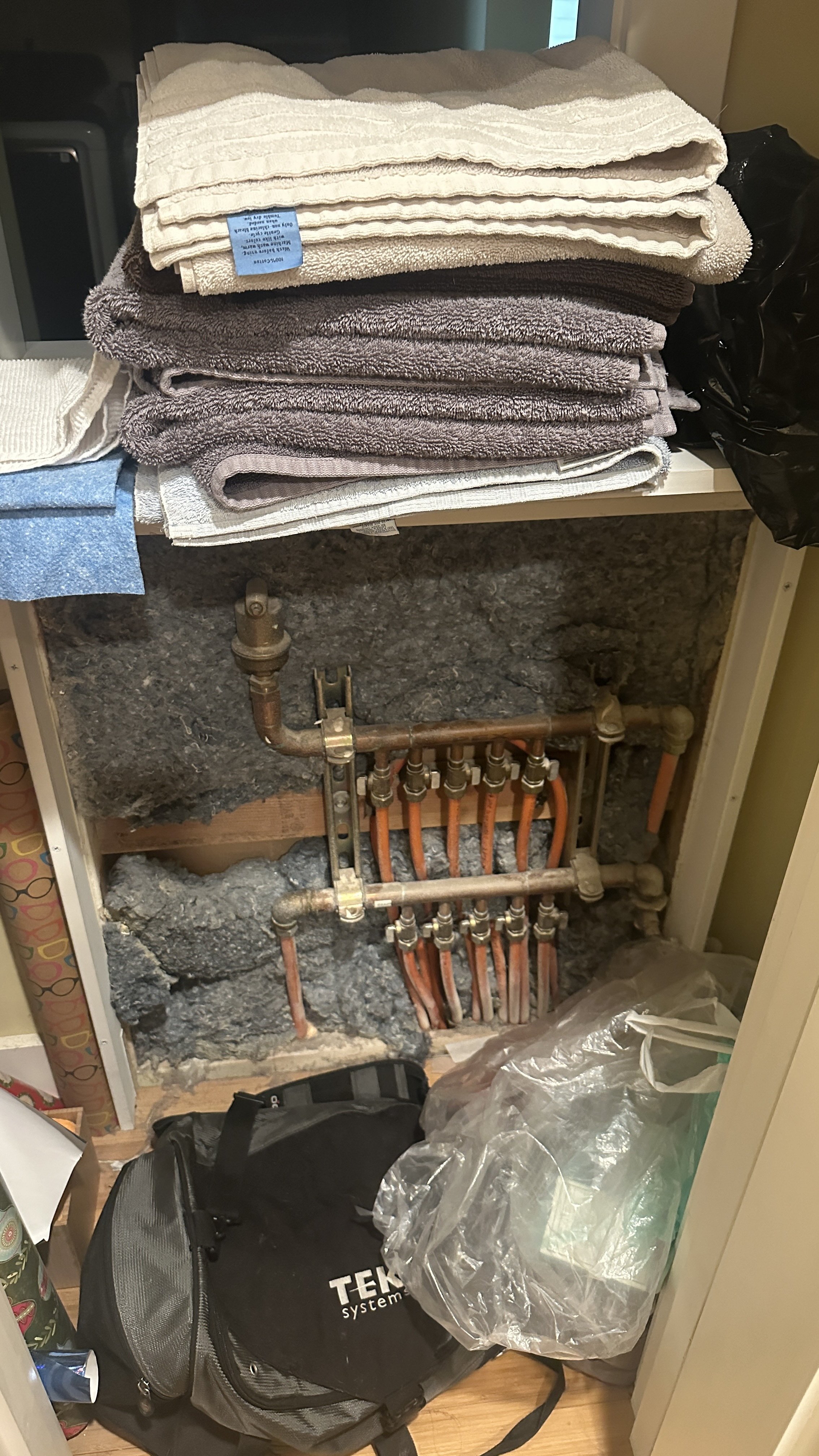

    Kitec Kitec Kitec. Sheesh. Folks, it's been about 5 years now. My wife and I decided to stay in our house here in Seattle. My fittings (knock on wood) look pristine. Not one failure. Even with the now 21 year old 75 gal Powerflex water heater, I still get great heat. Now, we are serious about selling.
    What can I do besides tearing out a perfectly good system? Should I abandon it when the water heater dies? What are my viable options? How much would it cost?
    I thought maybe mini-splits? How does/would it work?
    Keep in mind, I am just a former accountant who is interested in building. So, I may not understand all the lingo/how stuff works. That's ok. You guys have been a great source of info.

    After all these years I wouldn't worry about it. Your system seems to be tried and true over all this time so you might be one of the lucky ones that hasn't had any problems with this tubing.
    If you do not see or have had any corrosion issues and or [ zinc ] problems you should be fine.
    The concern is how to convey that with your realtor. Consult with a good realtor that is experienced with this, they might be able to offer some advice other than repiping or abandoning it.
  • Thank you…I have found a single realtor that knows how to convey this. Inspectors see it, and call it out. It ends up on form 17 disclosure. Ridiculous. The system works better than all the plastic pipe they've been running since the lawsuit. People are just plain dumb and do not understand chemistry. The water isn't nearly hot enough and what are essentially di-electric unions are used. Thus, my crude knowledge tells me it's contradictory to allow them for copper, but not pex-al-pex. I believed the heating guy used the Watts fittings that are SPECIFICALLY designed for this. Thus, it confounds me that this is called out. Please help me understand. I am just an accountant who thinks he can build🤣
