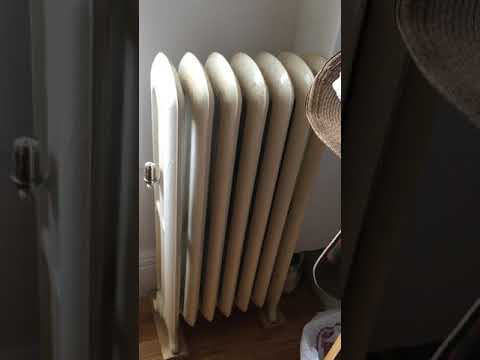

Please post a picture or 2 of the radiators and the piping connections. Is there a pipe connected to both sides of the radiator or just one side?0
Is the one radiator being replaced due to this noise? If so, don't it's a waste of someones money. A radiator is a hollow vessel, not unlike a pot on your stove. If the stove has problems would one buy new pots? No one would not.
Agreed with the above, the problem sounds like it's in the pipes. If the system was recently worked on and it's worse, most likely the building has someone working on it that doesn't know steam. Slope needs to be right or you get the hammer.
May need to trace out the piping and get pictures which will allow us to give you some insight. Do you have much access to see anything?0 -

Thank you everyone for all of the responses. I'm happy to hear that I am not crazy, and pretty much expected that the ability to solve this is out of my control as most have suggested. I have contacted the property management as well as the superintendent many times, but at this point it's clear my best recourse is to just move. What I am amazed by is that the people who came two weeks ago and did work on the buildings heating system were 'Plumbing and Heating' professionals (at least according to their van).
But just to follow up on some of the questions (in particular retiredguy's request), I've made another video showing both radiators, as well as the pipes I have exposed.
https://youtu.be/Glb0TiSaE1Q
If anyone has any other suggestions for how to help, even minor suggestions, I am all ears as I am at the point where I don't think the building owners will do anything.

Sounds like something occurring at the base of the riser.
Need to see pictures of that location.
Because a truck has plumbing and heating on it does not mean the technicians can work on steam.
