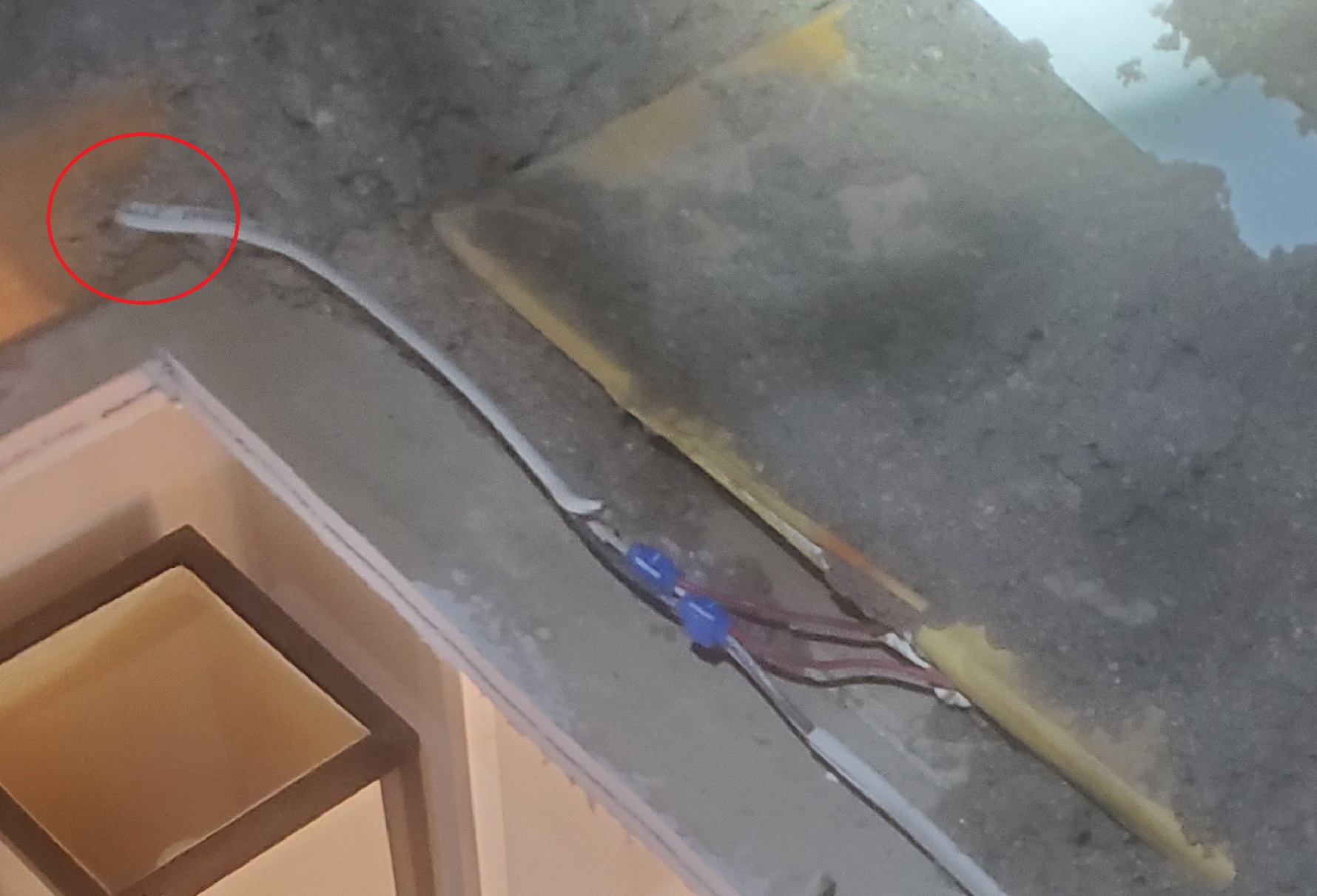

    Checking in from southern New Hampshire in 2024, my mini-split-AC install crew came up and asked me, "Hey did you know you have electric heat in the flippin' ceiling?" They had never seen that before. So after almost 1 year in this house the mystery of why 2 bedrooms were always hot as heck even when we turned down the radiant baseboard heat is solved.
    In the pic, the red circle shows how the home builder ran the wires thru the rafters. All were still hooked up, all 3 breakers were still on, one panel over the 3rd "not hot" bedroom had a broken wire. Most panels have an intact thick paper "protector" over the wire splices. I'm leaving them in but have the breakers off and labeled.
