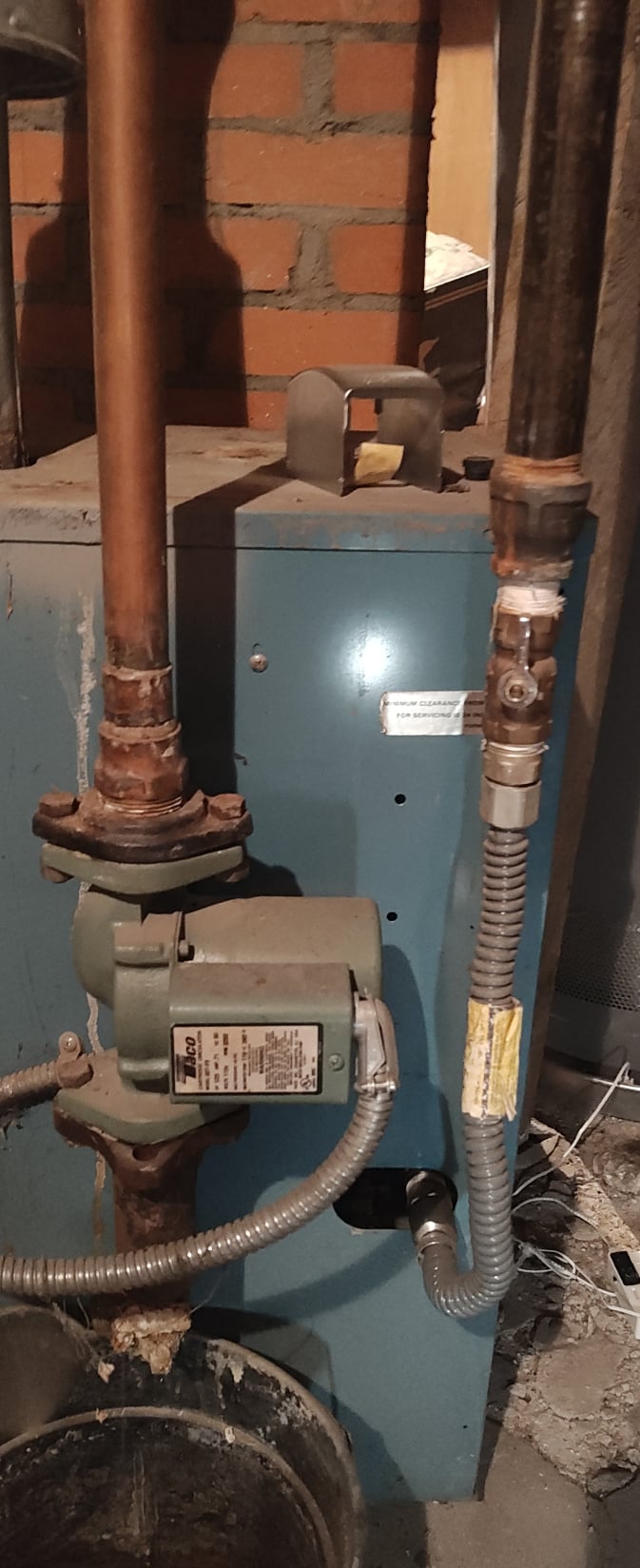

    Hi everyone 👋, it's my 1st time on this furnace / boiler platform and I'm on here to ask if anyone can help guide me to turn off this boiler to the upstairs lower registers . I was reading the comments that ryanhare37 was having and I noticed that I was having some of the same issues with my thermostat. I turned the wall thermostat off but, it doesn't turn these bottom lower registers off , they are still on, I knelt down to touch the unit and boy was it hot.
    I did call and check to see how much it would cost me for someone to come out and see what's going on with it but the price was way over my limit $140 an hour and that's not including the extras needed. I'm a disabled 61yr old female and I'm by myself . So trying to get this fixed and working right will have to be put on hold till the funds are available. I really appreciate any type of feedback on this and I just want to say thank you for even reading my message 🙏
    @boujee25
    We all would certainly like to help.
    Can you take some pictures of your boiler or furnace from about 10' away and then a few of the wiring and controls and finally pictures of the baseboard, radiator or registers or whatever the heat is coming from.? Also what do you use for your domestic hot water?
    Does it come from the furnace/boiler or is it a separate tank?
    It might have been better to start a new thread….
    That said, can you tell us a little more about your system? When you refer to "lower registers" it's noto really clear just what we are dealing with. Is this a hot air system? And the registers are blowing hot air? Or is this a hot water system with radiators? Or baseboard elements? Or are we talking about a whole lower floor being hot while an upper one isn't?
    The solution is likely to be similar in any case, but it would help to know what we are dealing with.

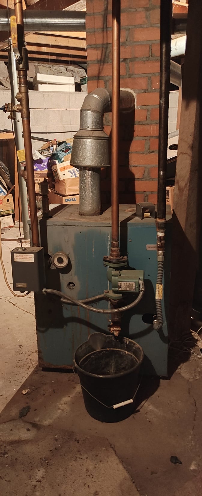

    OK folks — I sent @boujee25 a PM, and she responded with two pictures — hot water baseboard heat. Rather beat up, but that's what it is.

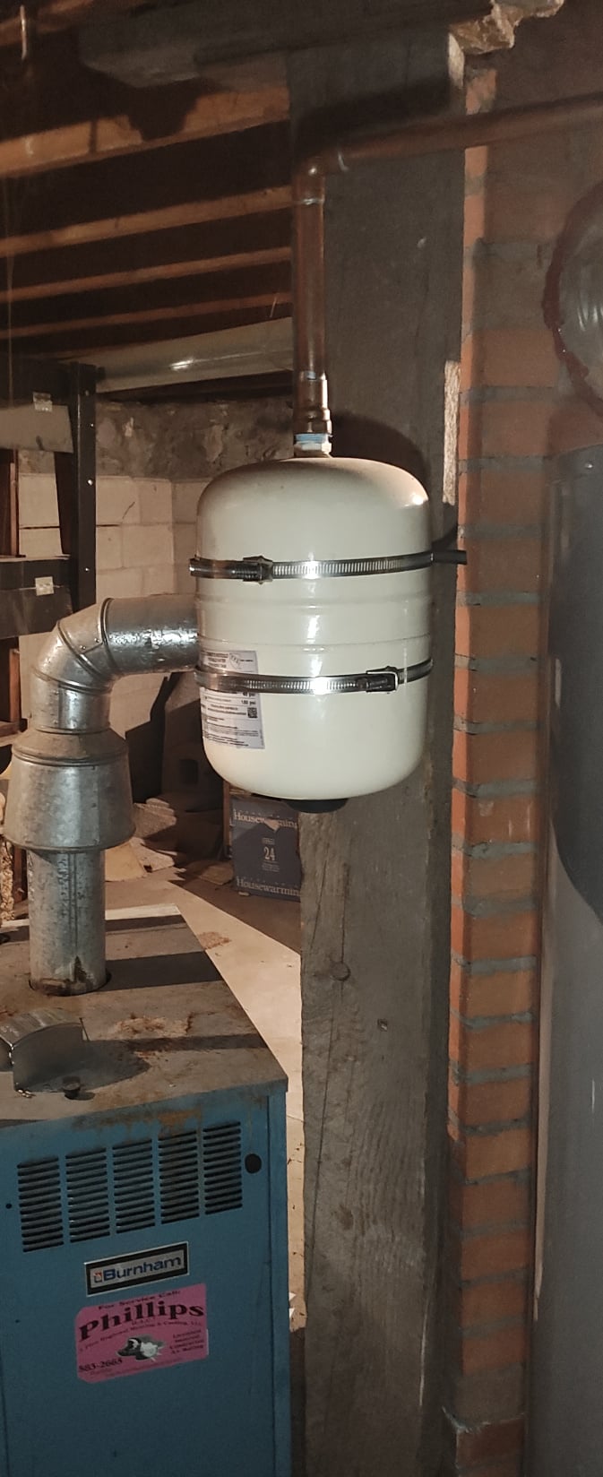

    HVACNUT Posts: 7,784
    I hate to do this, but could you take another from about 15 feet away. Looking to see what's at the top of this pipe.
    In the meantime, there should be a switch at the top of the stairs (or somewhere) with a blue or red plate. You can shut it off until you need heat. But hopefully it's resolved before that.
    edited July 1
    @boujee25

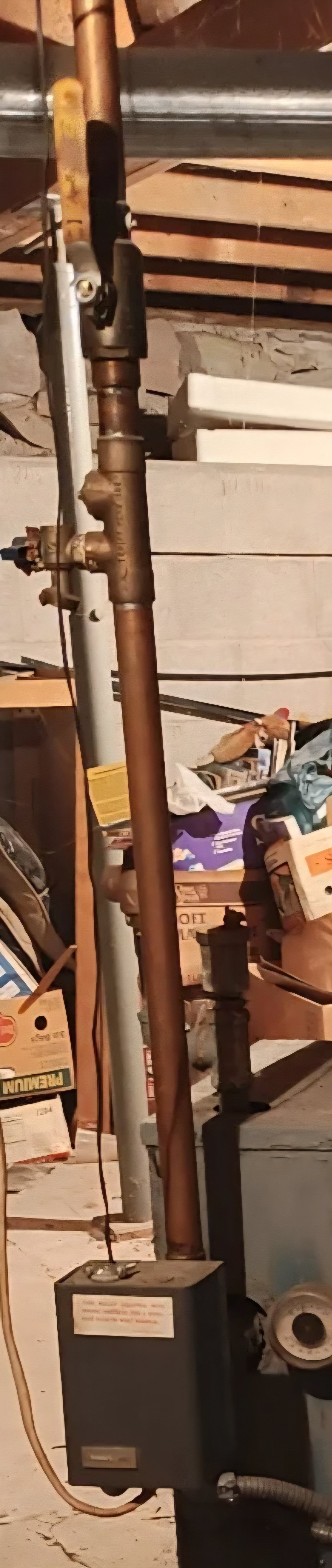

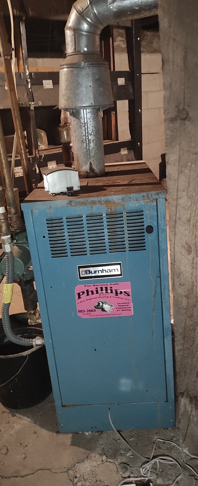

    For starters just to help you out a bit with the terminology you have a Burnham (the manufacturer) hot water heating boiler fired by natural gas, It appears to be a one zone system so you should have 1 thermostat and 1 circulating pump (the green motor in the picture attached to the pipe).
    Basically the operation of this system is simple.
    You have 120 volt power from your circuit breaker (or fuse) panel to the boiler.

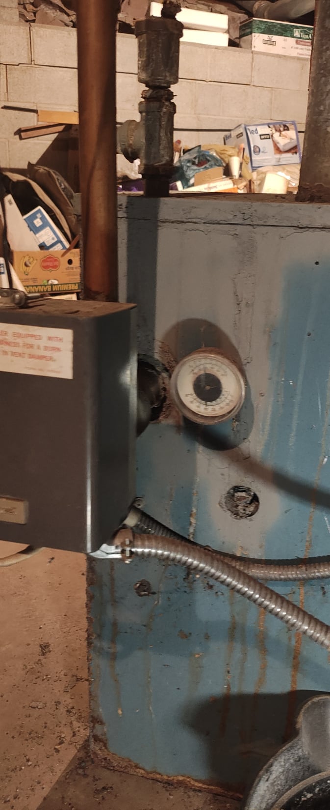

    When the thermostat calls for heat it sends a signal to the Honeywell relay (gray box to the left of the circ pump) this relay starts the circ pump and the boiler to give you heat.
    There should be an 'ON-OFF" switch (like a light switch) on the boiler but I do not see one. Some older jobs the switch for the boiler was at the top of the basement stairs. Gas boilers don't usually have a switch up in the house for the boiler but it is possible.
    On the left side of your picture is a Honeywell switching relay that controls the boiler operation. I can see the 120 volt power coming into that relay (heavy white wire). Perhaps a friend, relative or Neighbor could trace this wire to a switch or to the circuit breaker panel to shut the boiler off. This would prevent heating for now until you can get the problem fixed.
    Your problem is probably a simple fix, bad thermostat, bad relay or a shorted thermostat wire.
    Hope this helps.
