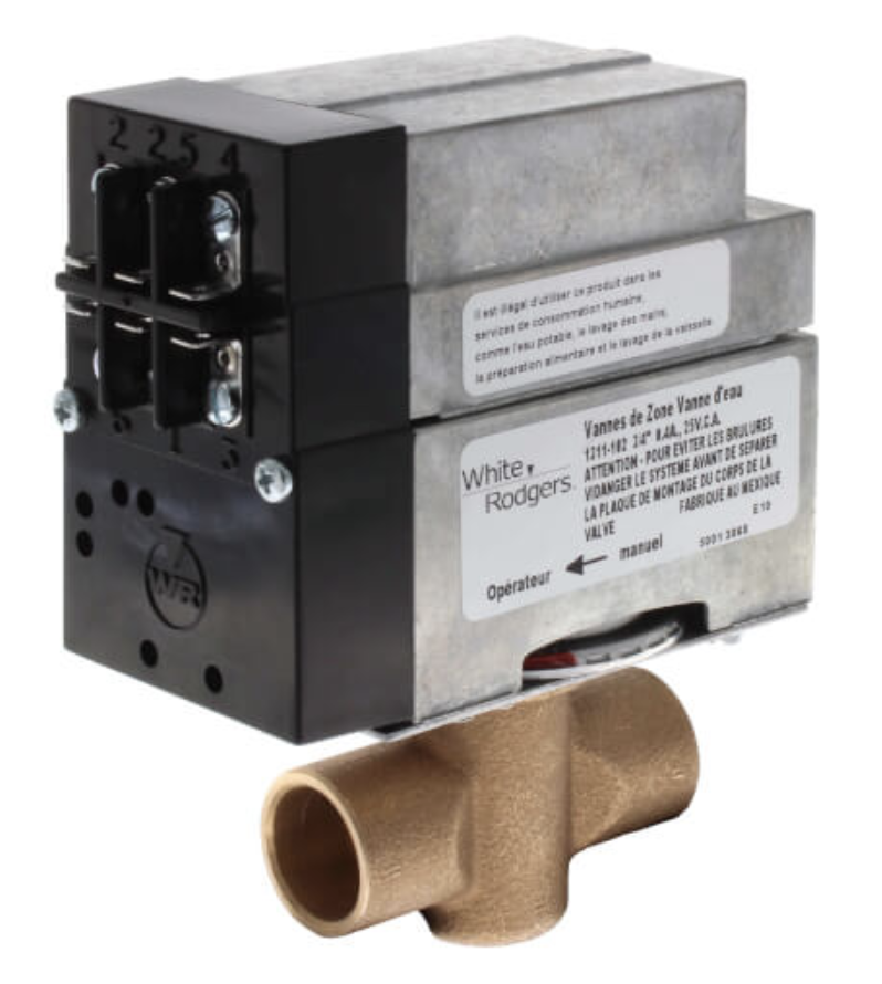

  • what about power open power close. White Rogers made this crazy thing.

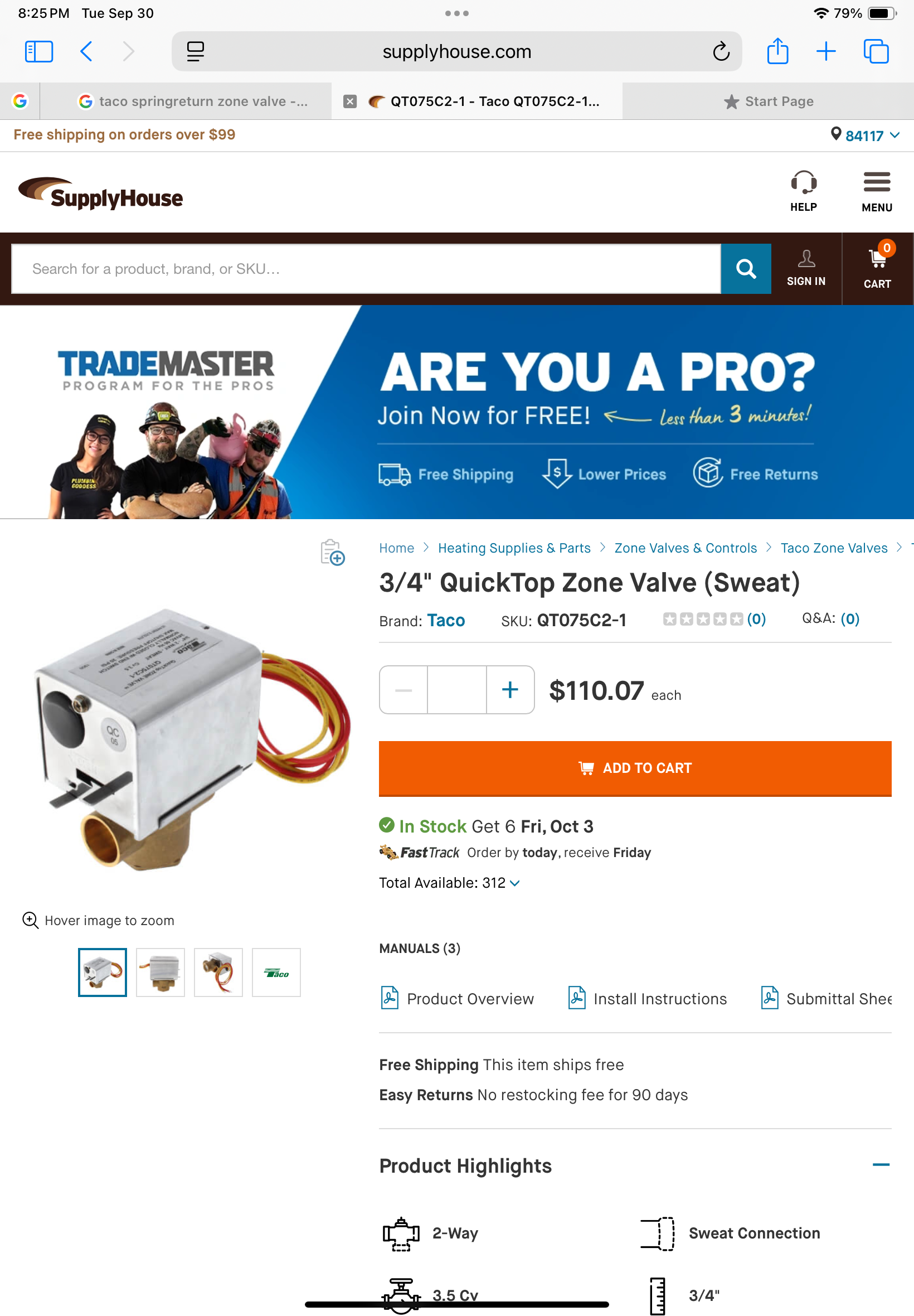

    OP mention Taco zone valves, does Taco sell a spring return ZV? I see the 555 thermal, and the capacitor discharge zone sentry?
    So the only Taco ZV with n.o. , n.c. Option would be the zone sentry
    hot_rod Posts: 28,705
    I guess Taco does sell a motorized spring return valve. Looks a lot like some other brands😗
    I don’t see a n.o. Version offered?
  • Flair zone valves were also power open, power closed. Hateful things.
