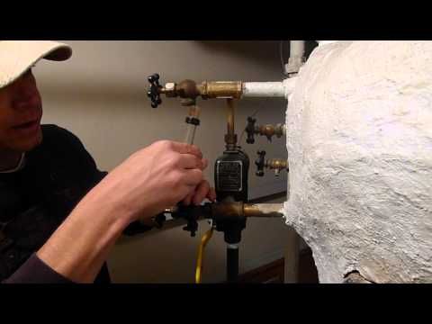

    I've made a bit of progress since the last post. Roughly in order I've:
    1. Turned off the gas to the boiler
    2. Set switch on pilot light to off
    3. Flipped main power on boiler off
    4. Drained boiler via old LWCO
    5. Removed sight glass [which this video helped with https://www.youtube.com/watch?v=IREmp4K9oC4]
    6. Removed wiring from old LWCO
    7. Loosened the compression nut on top of the LWCO
    From here I'm stuck. I think I need to twist the top pipe clockwise to remove the tube from the top of the LWCO, but I don't see where to stick a wrench. The top and bottom of the T are flat, so maybe there?
    No idea how to get the bottom one out though. There is a large nut there, and I can get a wrench on it & turn it, but it turns in the T instead of the LWCO side.
    Pics:
    https://imgur.com/a/xaJMa7N
    Bonus Question:
    The new LWCO is reversed compared to the old one. Water inlet is on the left, electrical on the right. Think it's safe to remove the valve on the bottom and flip it around? I'd hate to kill the new one. If not, I think I have enough clearance to just mount it backwards.
    https://imgur.com/l2tGwDI

    loosen the nut holding the brass tubing to the upper tee, take it all the way out. Loosen the compression nut on the bottom low water connection on the tubing all the way and slide it up the tubing. Grab the brass tubing and wiggle it out. It will be a little difficult.
    Once that is done you can spin the low water cutoff off the nipple at the lower connection. If it hits the top connection you will have to take the upper tee off.
    yes, take the drain valve off and spin it around
  • Fred
    Fred Member Posts: 8,542
    All you need to do is loosen the nut on the top of the LWCO vent tube. Put a wrench on the coupling nut on the bottom Tee and another smaller wrench on the smaller hex of that fitting (on the Tee side) to keep it from turning and loosen that large nut. Then you can lift the LWCO away. Yes, you can reverse the blow-off valve so that it faces out. Clean out the upper and lower Tee before mounting your new LWCO.

    Good news - I got it off! Turned out to be fairly easy. Just needed 2 wrenches as Fred said.
    I also got the blow off valve flipped around. Thankfully that was pretty easy too.
    One more question. The coupling nut seemed to have some sort of gasket inside [edit, or maybe this is a union? idk my pipe terms]. Hope that's the right word. It has some grey grease on it. I imagine I want to clean off the old grease and put on new. What sort of grease do I use? I have some rtv silicon, but idk if that will work.
    Some more pics http://imgur.com/a/Ep0Acuo

    @pkwastavich , That coupling doesn't need any grease on it. Someone probably lubricated the treads just to make it easier to turn. It may even be "Never Seize" to make for easier removal.

    Was able to get the whole thing back together and started up. No leaks as far as I can tell.
    Started up the boiler, opened the LWCO valve & sure enough the boiler shuts off! Yay!
