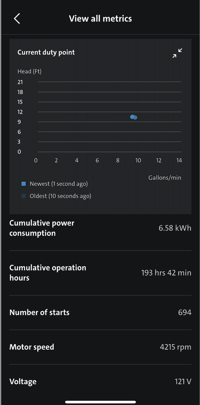

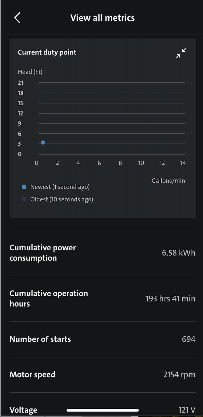

    hot_rod Posts: 28,846
    edited January 2025
    Yes that sounds correct. I pulled a pump out of the body, held it in my hand to observe that low current draw, low rpm condition.
    With the Alpha 15-58 connected to the GO app you can watch the rpm. Lowest I got was 2154 rpm, at 3W.
    Highest was 4300, 38W.
