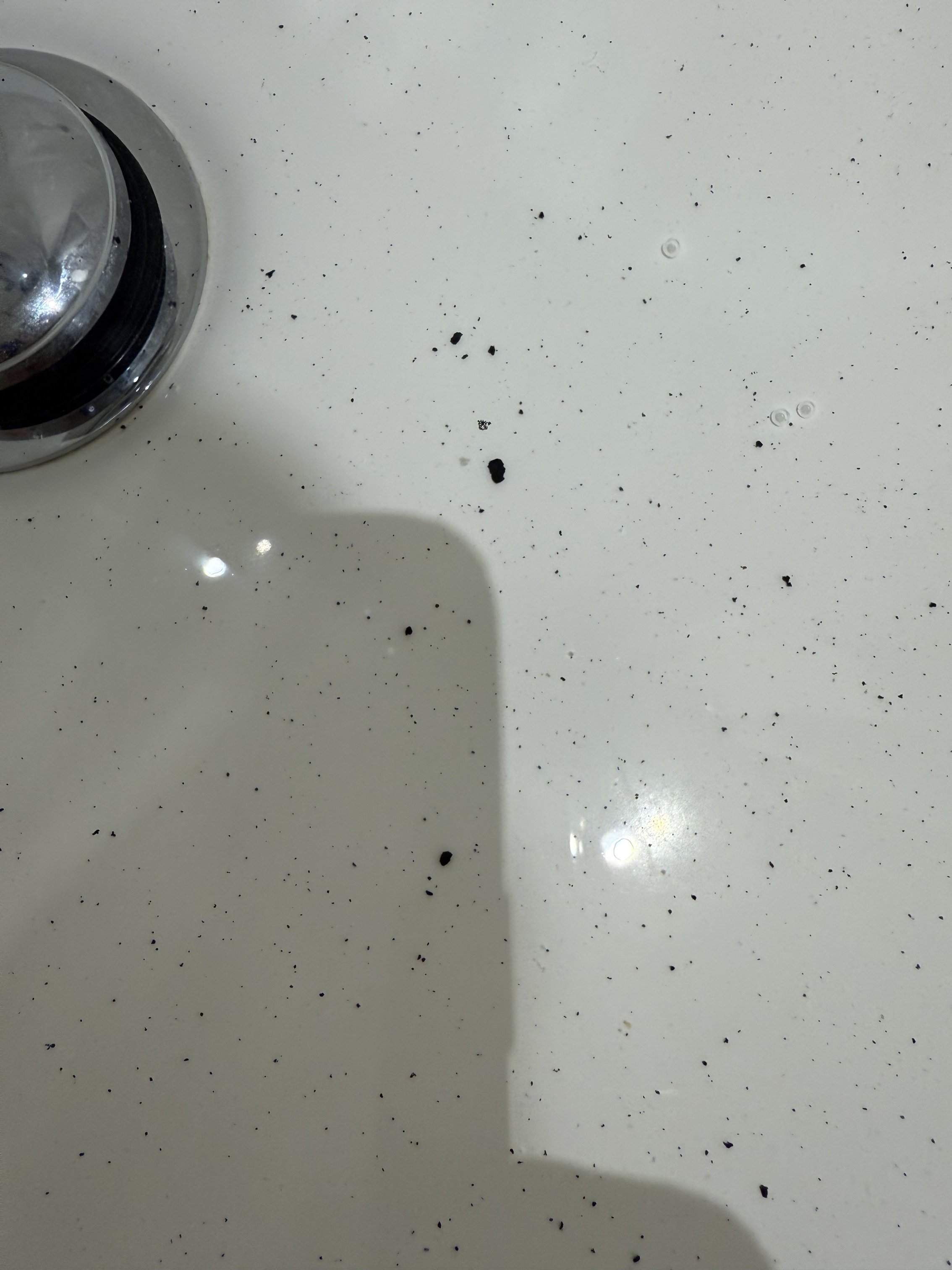

Small black particles started appearing in our water a few weeks ago. Appears to only be the hot water. We have a Navien tankless water heater. I'm not sure the model but have attached a picture of the inside. Looks relatively new (we bought the house a year and a half ago). We had the Navien flushed/serviced. Did not fix the issue. We had the valve on the main water line into the house replaced as recommended by a plumber (in case rubber is the issue). House has copper and PVC pipes. No visual evidence of flexible/rubber lined piping in the home. We're not sure exactly what the particles are. I have attached a picture. They smear when you rub with your finger. Any ideas as to what this is and how to fix it?

    Those particle are very hard to see. Are you sure the particles are only coming from the hot water ?
    It could be that the hot water is extracting those black particles out of the water when the water is heated. The thing that I can't tell is how they smear when rubbed.

    Our local water department changed the disinfectant they add to the water from chlorine to chloramine (a chlorine/ammonia compound). The ammonia breaks down rubber, affecting various parts of a plumbing system (toilet flappers, faucet/water heater connectors, etc.); symptoms are like yours. Chloramine resistant fittings are now available.
    What part of the country do you live in? Check with your water department.
  • Hello, If you have any braided stainless flex connectors, they often have a black rubber lining that disintegrates just as you have described. An expansion tank could be another source of rubber too. ;)

  • I have a Bosch tankless hot water heater was installed in 2021 that has black in the coming from plastic inside the hot water heater disintegrating faulty parts trying to get Bosch to admit that there’s a problem. We have MWRA water where I live. It’s an excellent source of water so the water is not the problem. It’s the hot water heater. I also have neighbors that have the Bosch hot water only two years old and it has already started with black specs.

  • Hi, Roughly two questions… Do those specs smear on the sink if you rub them? What sort of connectors do you have hooking up the heater? Are they braided stainless?
    Yours, Larry
  • I talked to the water department superintendent where I live and he said there is no reason the water should be corrodingparts in the tankless hot water heater. And yes, the. Black particles smear when you rub them. My plumber has done a flush of the system and changed out some of the plastic parts it only helped for a short time.I am going to have to put in a spin down filter that goes on after the hot water heater to collect the particles before they get to my faucets.

  • Hi, Those braided stainless lines often have black rubber liners, which decompose and give exactly what you're seeing.
