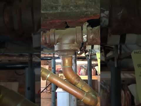

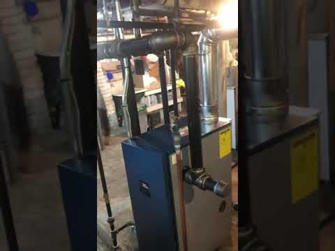

Before and after video, copper piping Gone!

    Thanks, y’all see 1 1/2” mains in your travels? The system heats much better says the home owner
    1 1/2" mains are small. Can't be many radiators on them and the ones that are have to be small too.
  • EzzyT
    EzzyT Member Posts: 1,377
    Nice install Gary. I see a fare amount of 11/2” mains. There’s a 3-4 block area of South Orange NJ that all the houses where built by the same developer back in early 1900’s and all the house are alike with the same layout. Every single one of those homes have single pipe steam with 11/2” steam mains.

    EBEBRATT-Ed Member Posts: 19,598
    Nice job Gary,
    Did you put the grinder and cutting disk to the test?

    A great improvement, even sounds better?
    I looked inside one of those Dunkirk side outlets and noticed how small the push nipples were across the top.
    They were about 1 1/2" compared to the 2 1/2" discharge.
    It seemed that when skimming out the 2 1/2 nipple only the water from the closest section would be flowing as the bottom of the next section push nipple is much higher than the bottom of the 2 1/2 nipple.
    I added a 2 1/2 x 1 1/2 reducing coupling for skimming so the water had to rise up more in the boiler and come from each section for skimming. FWIW.

  • GW
    GW Member Posts: 5,137
    Yes that gas gun was a little loud.
    Ok I will peek inside the boiler on our next install. When I skim I try to boiler out the top layer first, then step two is “flooding” the block and getting big flow. Then I repeat that process.
    Ed I haven’t got the new tools yet. I did try step one——got a basic grinder and I can’t get the old wheel off! I need the skinny wrench. Or, maybe there’s a magic button to lock the motor; gotta look again
