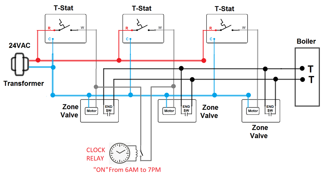

    Le John said:
    @NY_Rob do you have a wiring diagram of how you wired the timer. I’d like to try the same approach!
    It's actually really simple...

    This is how to use a 2 stage thermostat on any boiler with outdoor reset. The resistor or better yet potentiometer tools the boiler into thinking its colder outside and ups the CH temp. This shows the terminals for W-M ECO
    ratioflat_twin

  • flat_twin
    flat_twin Member Posts: 355
    Sorry, I've had several middle of the night emergencies and not been on here in a few days.
    Thank you. My Honeywell tstat is capable of two stage heat and I can see how opening relay 2 puts the resistor in the path of the ODR sensor. By golly I think even a retired telephone man can do it!

  • Solid_Fuel_Man
    Solid_Fuel_Man Member Posts: 2,644
    I've actually done this and it works well. You can adjust the resistance to "adjust the boost". Just connect the middle and one end of a typical 3 wire potentiometer.
    I made a standard Tekmar injection control a two stage this way just did it to the supply sensor, worked well. Same can be done with the OAT sensor on your boiler.
