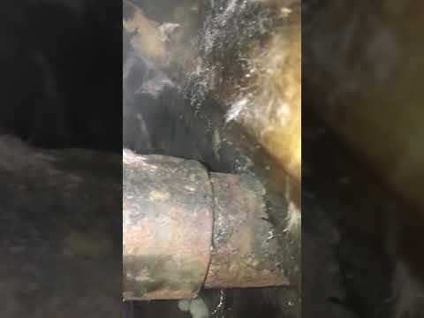

Hi all,
I noticed some water on the floor of the crawl space under the 50+ (?) year old addition on the back of my 100+ (?) year old house. Took out the ceiling insulation and found this leaking union that splices together two pieces of pipe leading to a radiator in the back hallway. (see pics)
When I google "steam pipe union" I mostly find images of beefier unions with a big nut to tighten. But this seems quite thin and I'm not sure how it would even thread on/off since it doesn't appear to have flats for a wrench to grip.
Is this a DIY job to fix?
Many thanks in advance for any advice.

    That's a coupling, not a union. It looks like that entire section of pipe needs to be replaced. It's probably a wet return.
    Check the contractor locator above for a pro. It's definitely not a DIY project.

    That's a coupling, not a union. The only way to tighten that up would be to take one section of the horizontal pipe loose from one end or the other, or, if you're lucky find a real union somewhere along that line, uncouple that union and try to tighten this couipling up. You may have to take that coupling off, use some pipe dope and then tighten it up.

    It's also a merchant coupling, which IMHO shouldn't be there. The more I see them the more I hate them.
    To replace you need to find the actual unions which will allow the pipe to be turned, removed and replaced.
    I do not know what your abilities are, for me that wouldn't be a big deal if it has some kind of access.

    Ok, so the coupling is attached / detached by rotating the pipe itself, which is why there's no flats for a wrench.
    But then in order to rotate the pipe it has to be freed from a "union", which would have a nut that secures it. Right? I'll have to look up "merchant coupling" but I'm not surprised to hear that it's not the right kind. The main house is sturdy and properly piped but the addition shows signs of lots of weird/bad decisions.

    If there is no union nearby and you have to cut the pipe anyway....cut the coupling in the pic straight down the center. If your lucky the pipe or pipes will have some play..just enough for you to unscrew each half of the coupling and screw a union back on or a union and close nipple. Then call someone to take a look. Or forget what I just said and call someone to take a look.

    If the OP could saw that coupling exactly in the middle, and hoping for enough swing away of the longer end of the pipe to unscrew the halves of the coupling.
    Then perhaps a Dresser coupling could be slipped over the pipe for reconnection.
    There might be one approved for steam if that is a supply pipe.
    If a return pipe then a standard one might do.
    I would clean the pipe with sandcloth before the sawing.
    Just a suggestion for DIY.

    I couldn't see either end --- taking out more insulation should help in one direction but because of how the addition was built the other end is complicated. Need to poke around more tomorrow...
    Also as it was relatively warm today so when i found the leak it wasn't actively leaking. But when I fired up the boiler just to gauge the extent of things it actually seems more like a pinhole leak next to the coupling, rather than the coupling itself. (Or maybe both.)

    ok to the right I can see another merchant coupling. Still no view in the direction toward the radiator.
    Also, can I link to video? Here's the leak:
    https://youtu.be/cPCMSot1bhY

    I used a clamp to gauge the width of the pipe by tightening it on to the pipe then measuring the gap with a ruler. I get 1.5"
    EBEBRATT-Ed Member Posts: 19,553
    So it is a small pipe probably 1 1/4". It would have been better if they had used a malleable coupling with tapered threads instead of a thread protector.
    You might be able to cut through the coupling directly in the middle remove the old pieces and put a union in it's place. As always you have to be prepared if things go bad
