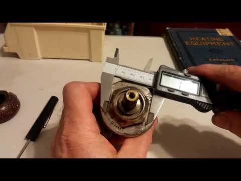

    Gordo
  • Gordo
    Gordo Member Posts: 857
    @WigglyWalker :
    Below is a YouTube video of an ADSCO valve break-down that I hope you may find useful.
    Please "like" and "subscribe" if you do.
    https://www.youtube.com/watch?v=rTGf2jx1AWQ&t=483s
