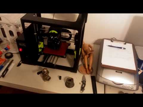

3-D Plastic Printing New Handles For The Hoffman #7 Steam Radiator Valve
Gordo
Gordo Member Posts: 857
3-D printing in plastic is still largely a solution looking for a problem... for now.
But it seems that for re-creating obsolete parts that make 1920s steam vapor valve restorations complete, its just the ticket!
We're taking orders! How many do you need? Let us know.
(We've also printed out Warren Webster type W valve handles and Kreibel valve handles, too.)
https://www.youtube.com/watch?v=fjOBBxVKjRw

  • How wonderful, and please tell us about the Voo-Doo doll beside the printer.
    I suspect it is against all steam knuckleheads. Are you boiling it, or using pins?—NBC
  • Gordo
    It is a manikin articulated for artists as an aide for drawing. Nothing to do with vodun or "voo-doo" ;-).

    @Sailah : Ayuh, these things are still too glitchy for prime time. The one shown above, the Luzbot, is reviewed as being the most "plug and play" ready of the current models in its price-point (self-leveling bed, self-cleaning nozzle, etc) and it still fiddly and prone to seemingly random failures on top of the steep learning curve.
    But...
    Oh, the power to make your own stuff that you couldn't before...
    So cool!
